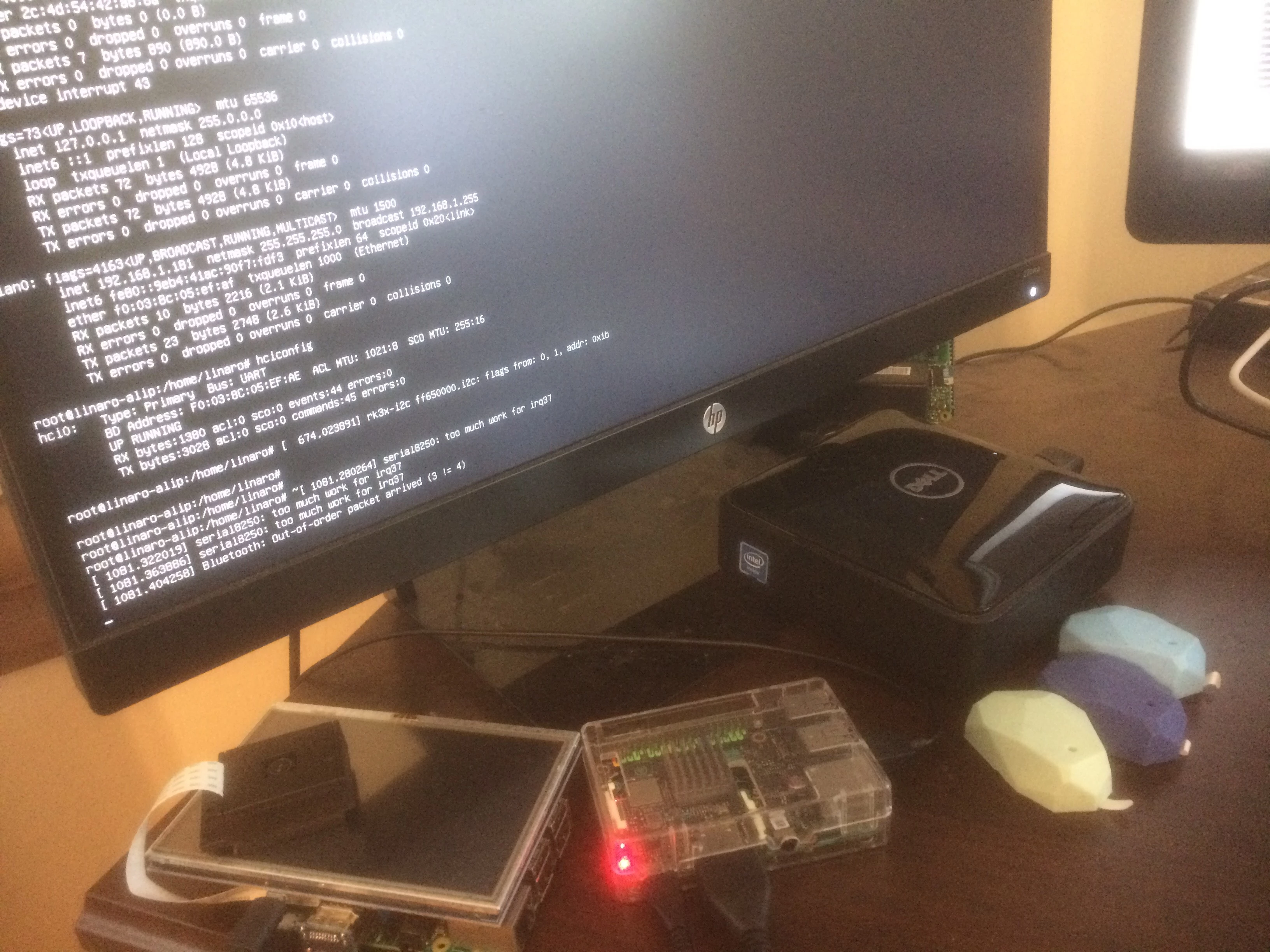

In this article, we are ingesting beacon data using an ASUS Tinkerboard which is very similar to a Raspberry PI in form, form factor and features. It is newer and has less peripherals, but has 2 gig of RAM, ARM Mali GPU T760 MP4, Quad-core ARM Cortex-A17 1.8Ghz processor with a dual-channel DDR3 memory and BLE built-in (Bluetooth 4.0 with EDR).

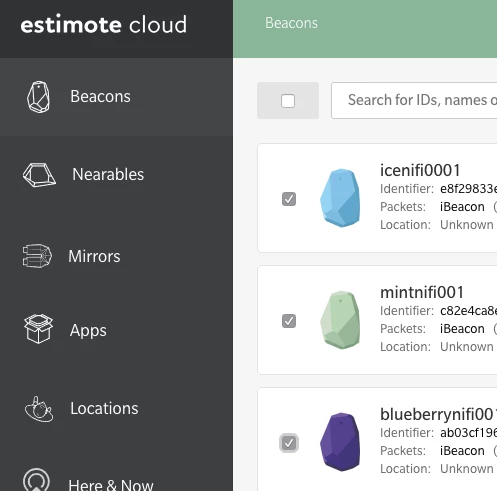

For beacons, I am using the basic Estimate three beacon collection. They have a really nice solid beacon in a silicon case, that looks nice and works well. They have a mobile app to manage, monitor and simulate as well as a cloud app.

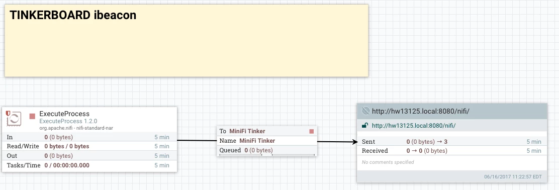

From our Apache NiFi server we have an Input Port that is receiving the messages from the Java MiniFi agent running on the ASUS Tinkerboard.

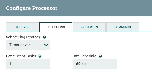

As with most of the data, I want to ingest the data every minute.
The ASUS Tinkerboard device has the read light lit up. The Estimate beacons are the colored devices to the right. For Tinkerboard's the default username is linaro.

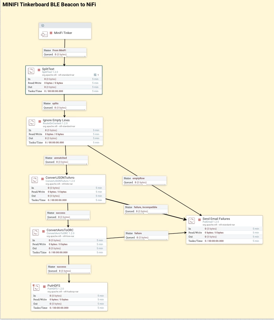

It's a very simple model, just execute the Python and send the resultant JSON to NiFi for processing and storage.
