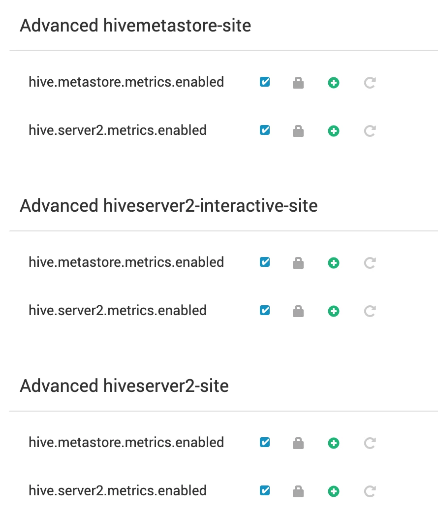

You need to ensure the following properties exist. If not, first add them in the respective custom section via Ambari >Hive> Configs.
