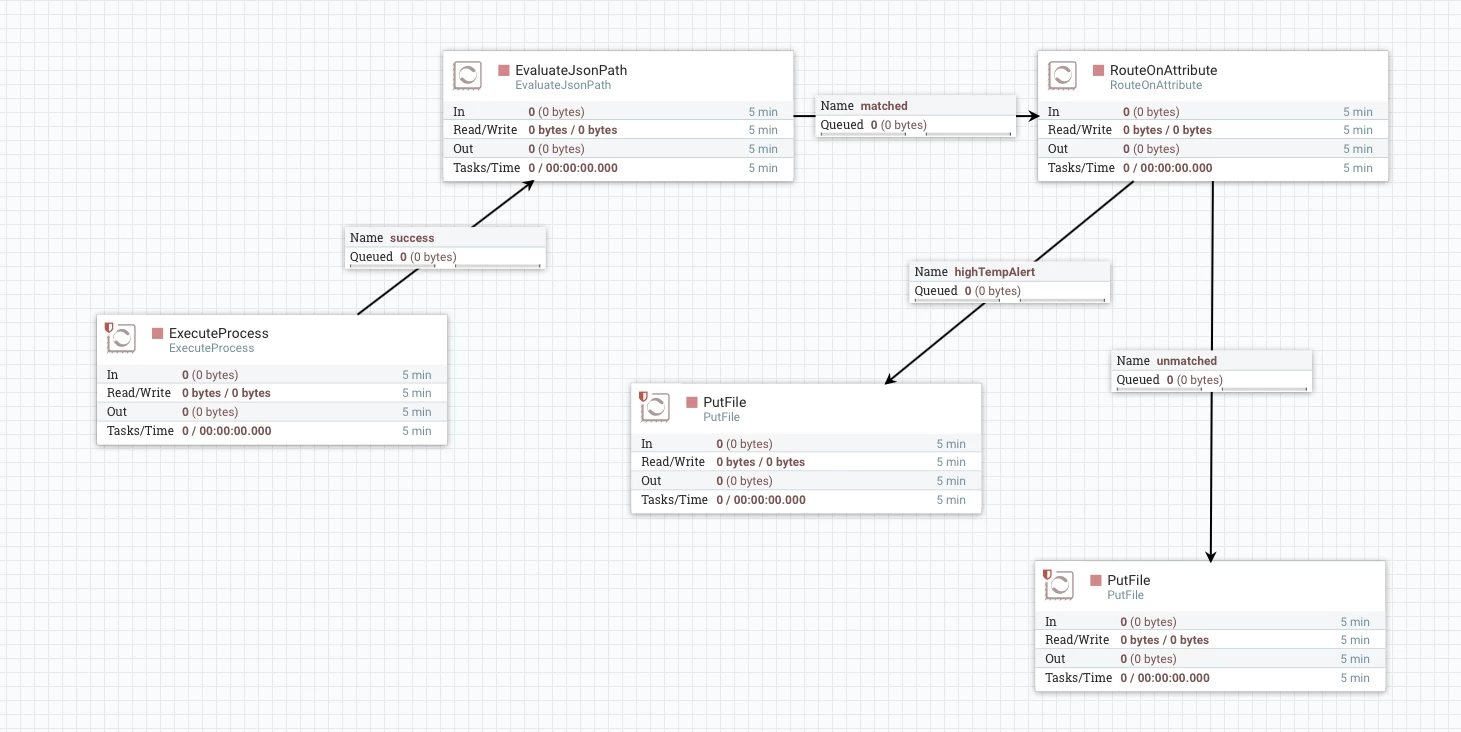

Open NiFi and either create the flow in the image below or import the template included in the zip folder from git.
the Execute Process calls our python script and passes the data on to the Evaluate JSONPath processor.
It is set to pull the temperature out and place it on the flow file as an attribute. The RouteOnAttribute processor then routes the data based on the value of temperature being greater than 72 degrees.
This is where you can start using your imagination!!
Load a datadatabase, send alerts, load a dashboard (banana) perhaps.
