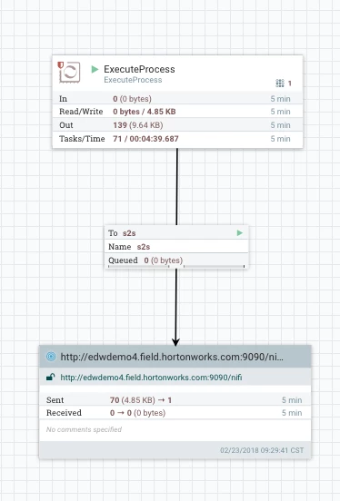

Start of by adding a remote process group to your NiFi flow at the sensor end and feed the output of ExecuteProcess into this remote processor. Supply the URL of your HDF NiFi instance (same as you would type into browser to get to the design gui).

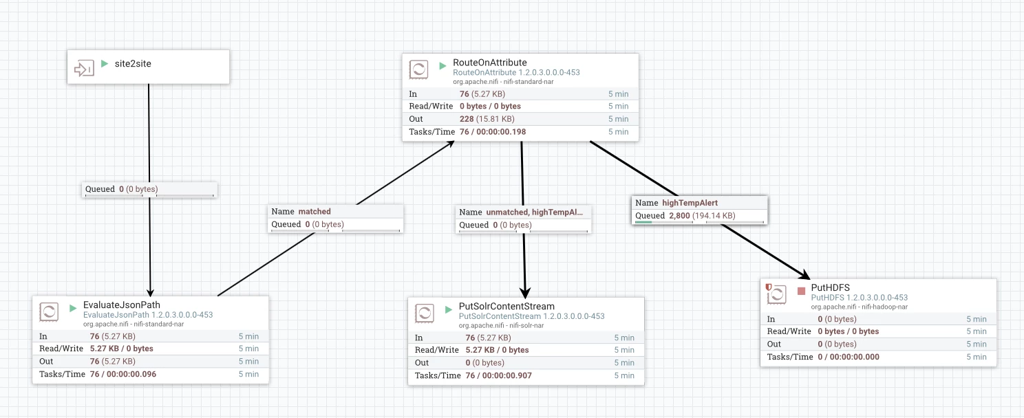

Now move to your remote instance of NiFi on your HDF cluster and create a new input port. replace the execute process processor with the input port. Now when you start the processors on both nifi instances your NiFi instance at the "edge" gathering data directly from the sensor will send the data directly to your new input port.
I will be taking this data and pushing it directly into Solr for indexing and use with a banana dashboard.
You may want to do other things with your data and later articles in this series will cover other applications, for example pushing to Hbase or Kafka and streaming into Druid. You can also write to HDFS or Hive.
For now Solr will be what we use.
Create a collection in Solr and provide the name of that collection to the PutSolrContentStream. This will start to populate your Solr collection with sensor events. To make this data more useful to us we will need to also collect the timestamp that each event is collected at. I have done this by modifying the python script to include an extra field in the json. You may decide to leverage NiFi for this. All code and templates can be quickly obtained by cloning the accompanied git repo to your machine. arduino-nifi-dht

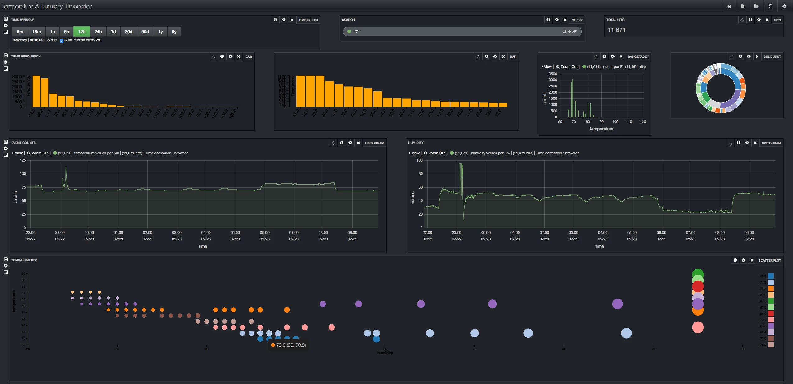

Move to your banana instance and either create a new time series dashboard and start having fun with whatever you desire... Or you can follow along a bit further and upload the template included in the git repo located in the banana directory.
Upload this template to your instance and edit the dashboard Solr section to point to the collection you specified in the earlier step.
Click save and you should have a dashboard that looks like this:
Well... If that doesn't put a smile on your face then you are definitely reading the wrong article 😉 You can modify the dashboard and make it show what you are interested in then just click save at the top right and set as default so you always have it when you reload the page.
