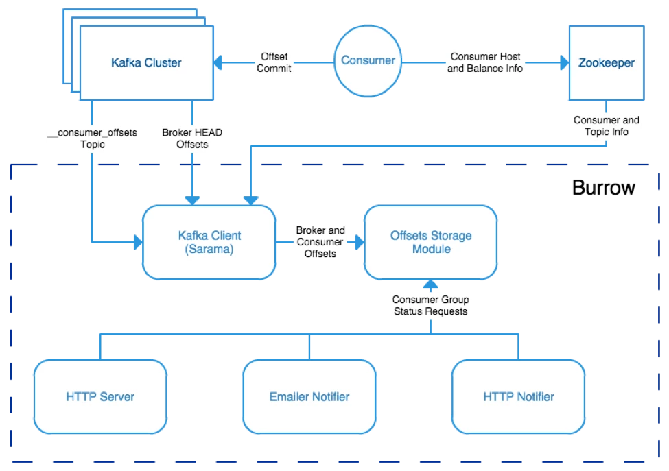

Burrow is under active development by the Data Infrastructure Streaming SRE team at LinkedIn, is written in Go, published under the Apache License, and hosted on www.gituhub.com/linkedin/Burrow.
Burrow's high level design is presented in the diagram below.
Burrow automatically monitors all consumers and every partition that they consume. It does it by consuming the special internal Kafka topic to which consumer offsets are written. Burrow then provides consumer information as a centralized service that is separate from any single consumer. Consumer status is determined by evaluating the consumer's behavior over a sliding window. For each partition, data is recorded to answer the following questions:

The information is distilled down into a status for each partition, and then into a single status for the consumer. A consumer is either OK, in a WARNING state (the consumer is working but falling behind), or in an ERROR state (the consumer has stopped or stalled). This status is available through a simple HTTP request to Burrow, or it can be periodically checked and sent out via email or to a separate HTTP endpoint (such as a monitoring or notification system). The HTTP request endpoints for getting information about the Kafka cluster and consumers, separate from the lag status, are very useful for applications that assist with managing Kafka clusters when it is not possible to run a Java Kafka client.
For example, if we have configured Burrow with a Kafka cluster named local which has a consumer group named kafkamirror_aggregate, a simple HTTP GET request to Burrow using the path/v2/kafka/local/consumer/kafkamirror_aggregate/status can show us that the consumer is working correctly:
{"error":false,"message":"consumer group status returned","status":{"cluster":"local","group":"kafkamirror_aggregate","status":"OK","complete":true,"partitions":[ ]}}
It can also show us when the consumer is not working correctly, and specifically which topics and partitions are having problems:
{"error":false,"message":"consumer group status returned","status":{"cluster":"local","group":"kafkamirror_aggregate","status":"WARN","complete":true,"partitions":[{"topic":"very_busy_topic","status":"WARN","partition":1,"start":{"timestamp":1433033218951,"lag":248314281,"offset":303081219},"end":{"timestamp":1433033758950,"lag":251163129,"offset":3035669403}}]}}
