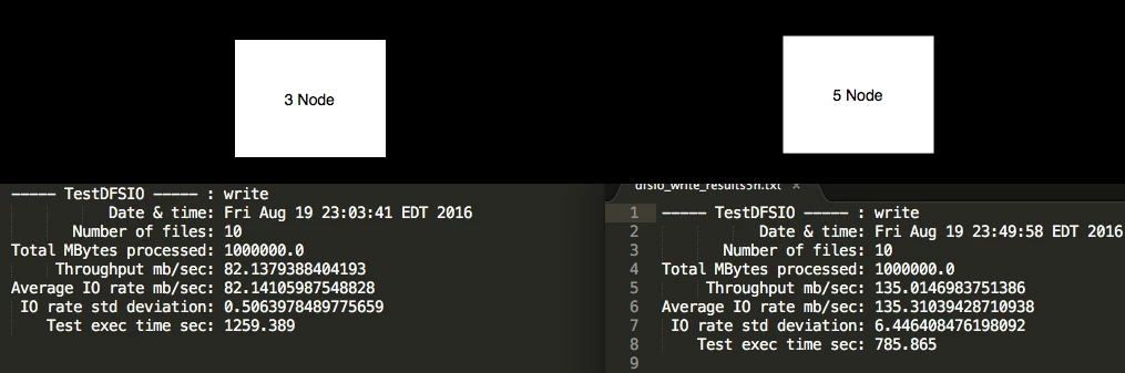

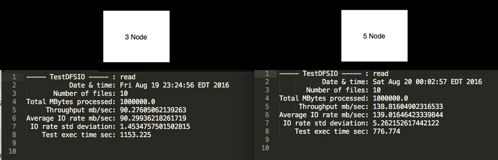

Started the testing with dfsio which is a distributed IO benchmark tool. Here are results:
From 3 to 5 data nodes IO read performance increased approx. 36%
From 3 to 5 data nodes IO write performance increased approx. 49%

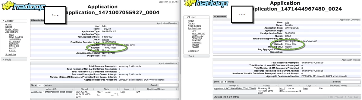

Now lets compare running TeraGen on 3 and 5 data nodes. TeraGen is a map/reduce program to generate the data.
From 3 to 5 data nodes TeraGen performance increased approx. 65%

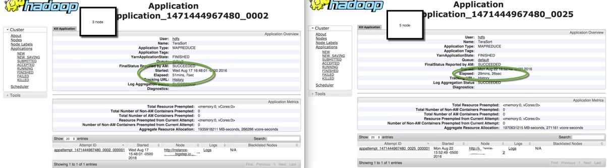

Now lets compare running TeraSort on 3 and 5 data nodes. TeraSort samples the input data and uses map/reduce to sort the data into a total order.
From 3 to 5 data nodes TeraSort performance increased approx. 54%.

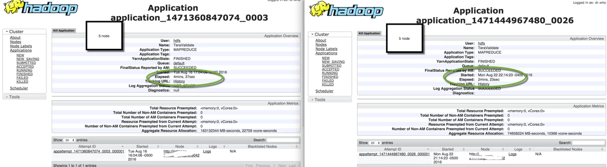

Now lets compare running TeraValidate on 3 and 5 data nodes. TeraValidate is a map/reduce program that validates the output is sorted.
From 3 to 5 data nodes TeraValidate performance increased approx. 64%.
