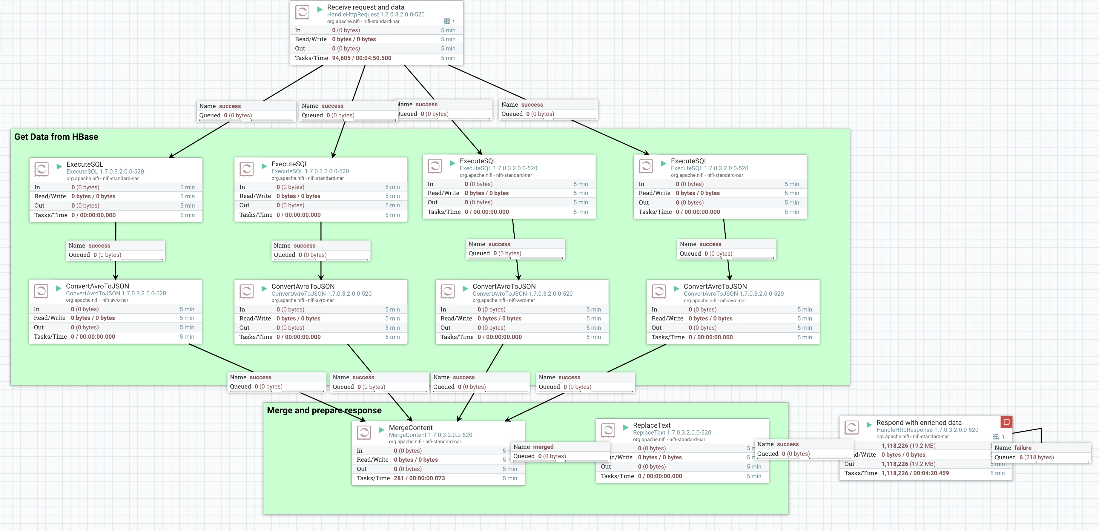

Section 1: Create a Web Service with Nifi
For your entire project to work, you will have to create more than one web service although this section only goes through the creation of one (see the flow overview below). To get all the flows required for your app to work, check github here.
Step 1: Create a request handler

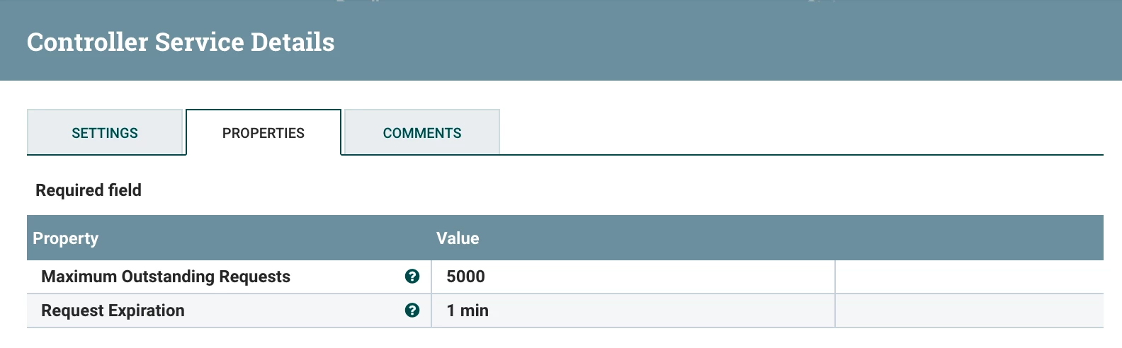

StandardHttpContextMap
This can't be more straight forward. Create a StandardHttpContextMap controller service with default options and enable it.

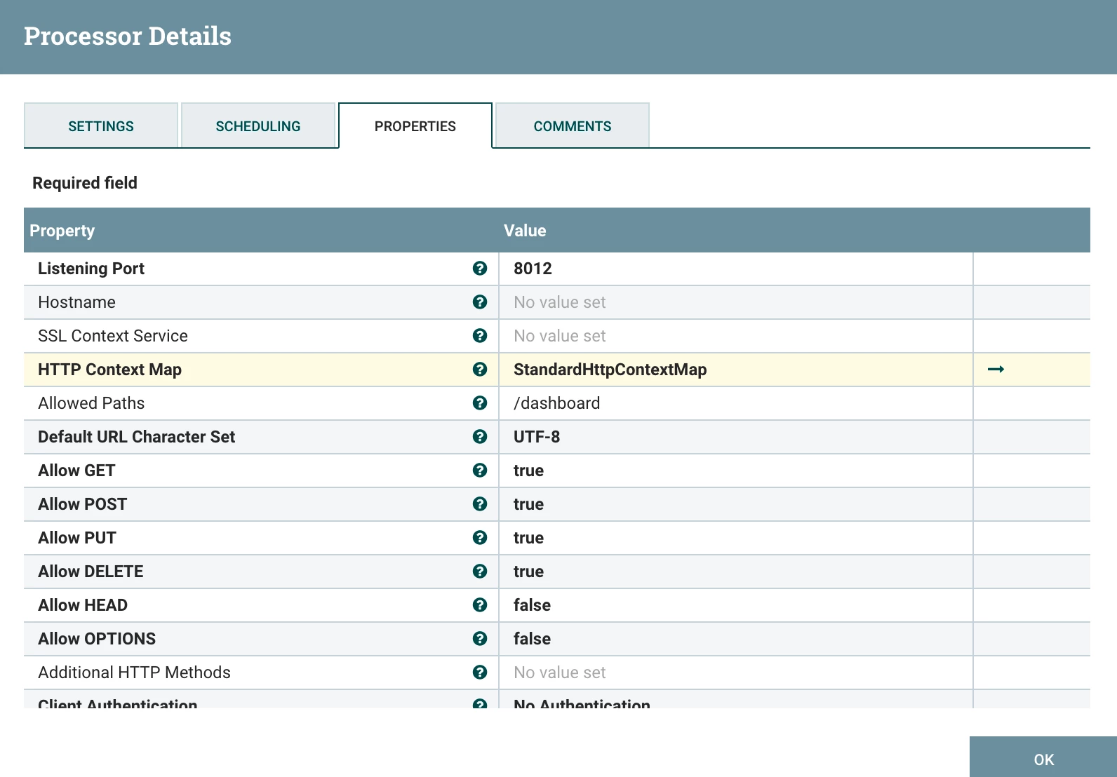

HandleHttpRequest: Receive request and data
Create a processor simple HandleHttpRequest processor.
Here the properties you need to change (all other are standard):
HandleHttpRequest
8012
HTTP Context Map
StandardHttpContextMap (the controller you just created)
Allowed Paths
/dashboard
Step 2: Retrieve data from Hbase

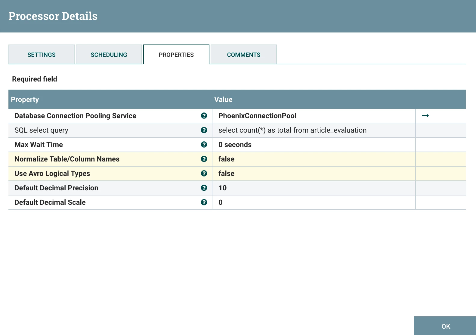

Execute SQL
Create 4 execute SQLs that will run queries retrieving all the data you need. They all rely on a DBCPConnectionPool controller for Phoenix. To understand how to create that, please refer to part 3.
Each and every Execute SQL will have a select count in them. I'm not going to list them here, but I included a article for all web services to this article.

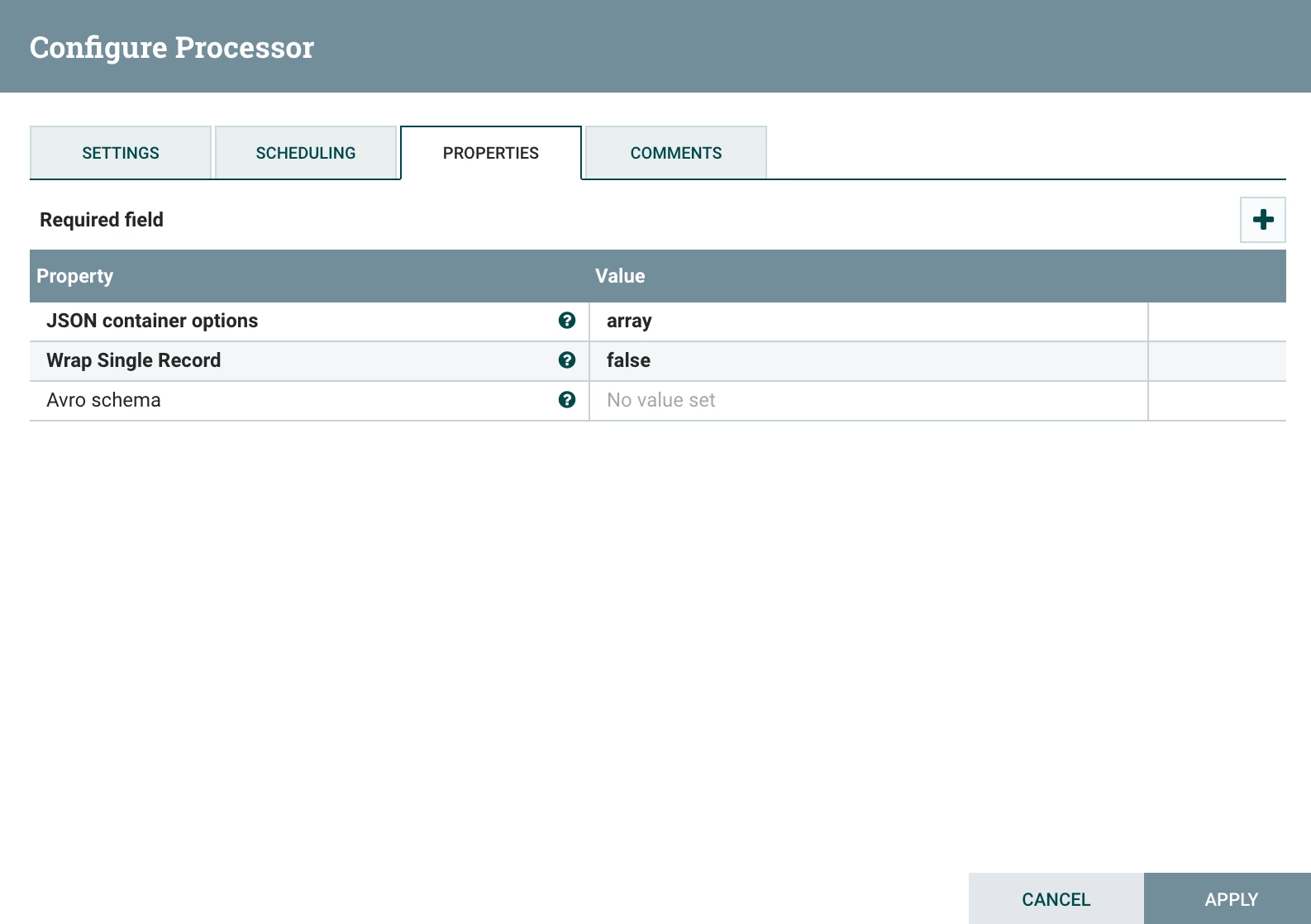

Convert Avro to JSON
Yet again a very straight forward configuration. For each ExecuteSQL you created, create a ConvertAvroToJSON processor with standard configuration:
Step 3: Merge and prepare Response
Merge Content
Merge all outputs from the Convert Avro to JSON processors using a standard MergeContent processor:

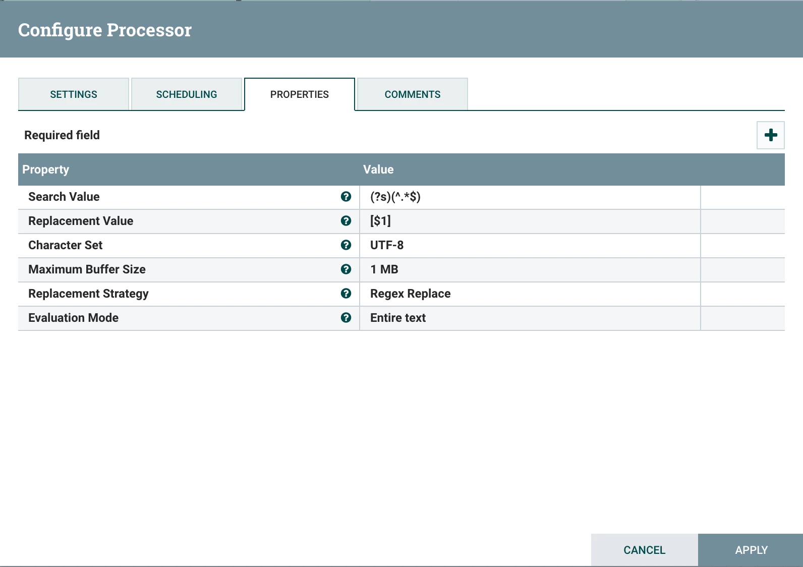

Replace Text
Use a ReplaceText to add brackets before and after the merge content, so that your web app can read it:

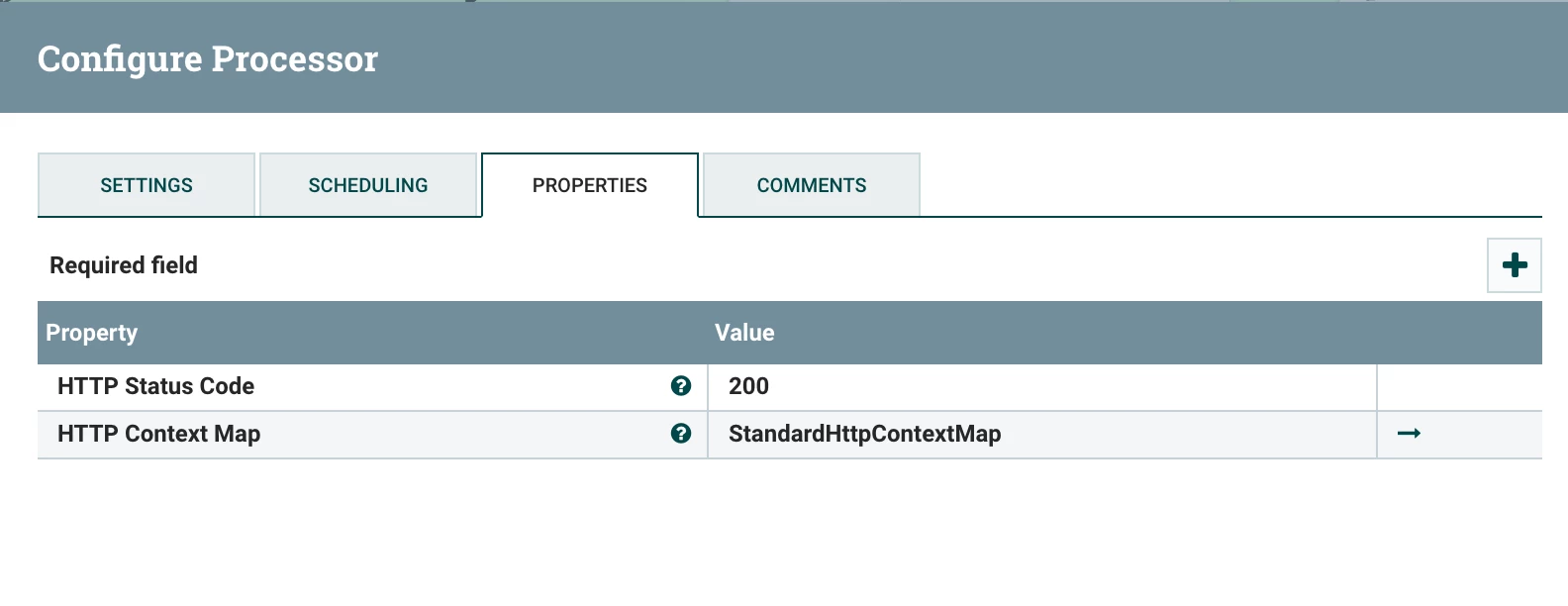

Step 4: Send response back
Handle Http Response
Finally, use a standard configuration for a HandleHttpResponse processor to return the web response:
Start your flow, then ou should be able to call your service by going to this URL:

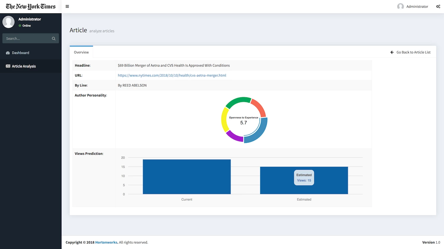

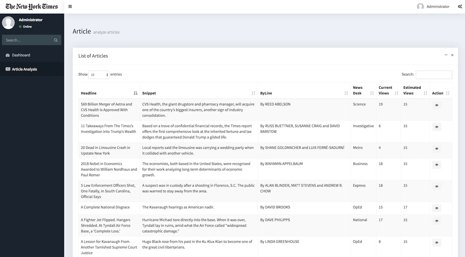

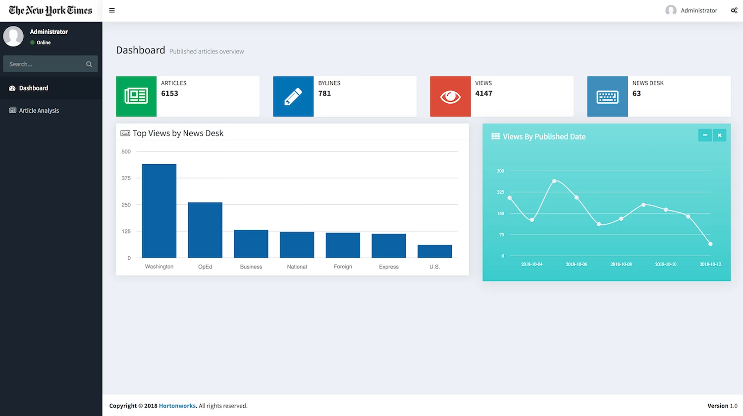

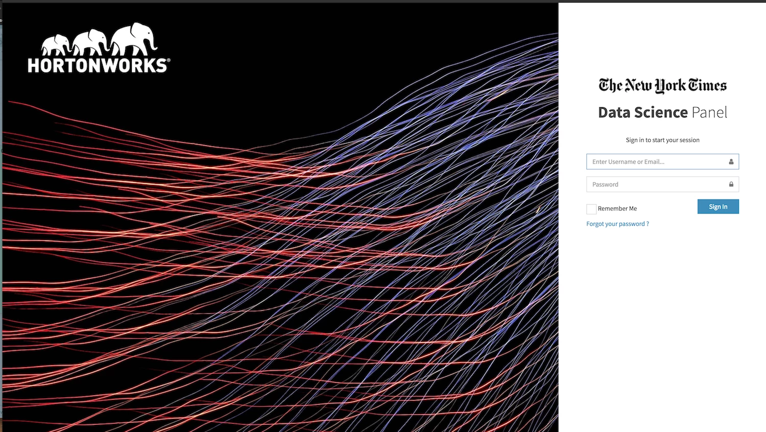

After you're done with that and have restarted your web server, go to:
http://[YOUR_SERVER]/index.php
You can now connect using admin/admin. You should see screens like these ones:
