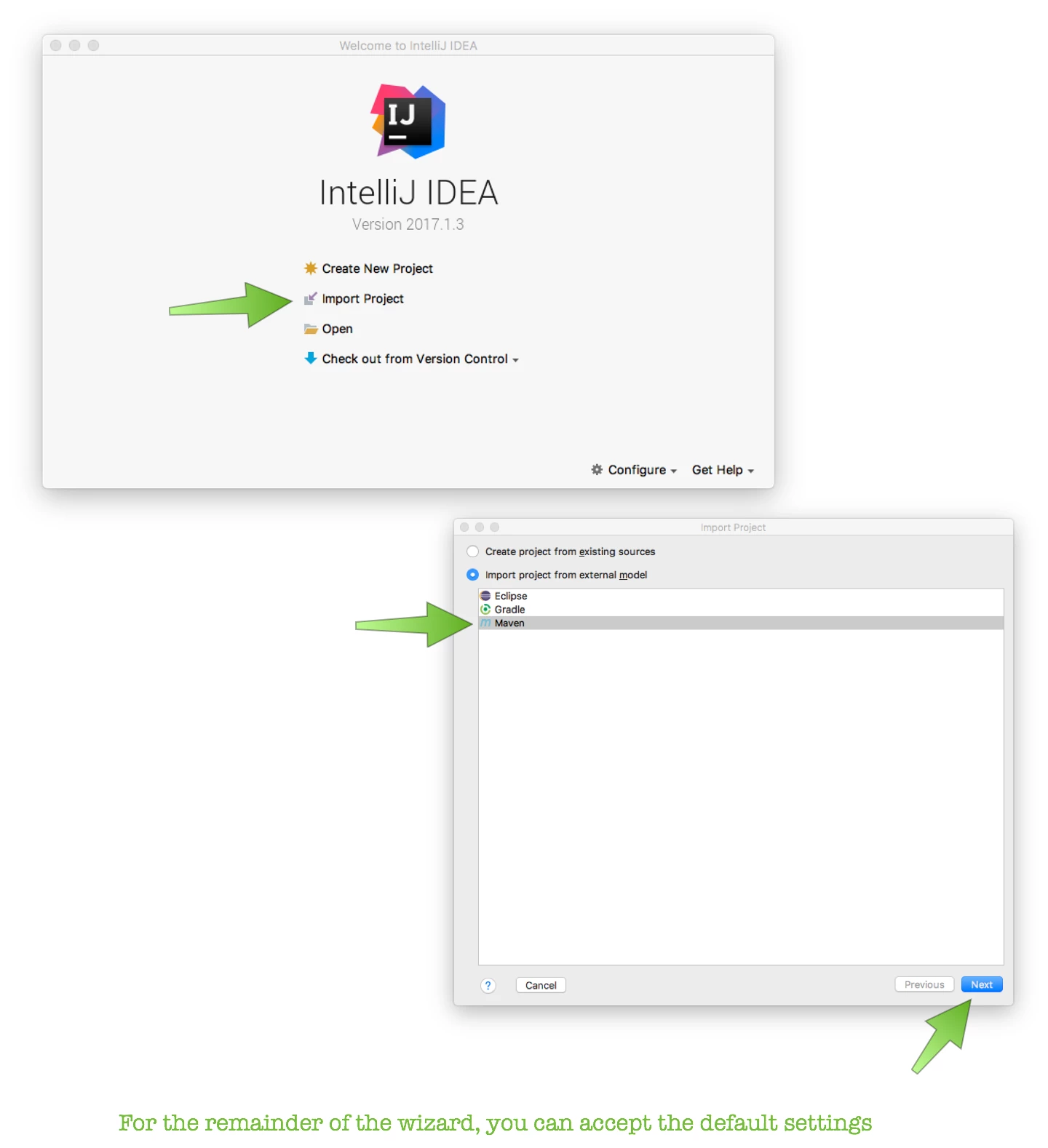

Now let's setup an IntelliJ IDEA Project, which we will use for debugging NiFi.
First thing to do, if you have not already, is create an IntelliJ IDEA Project from our cloned repository:
  1. Launch IntelliJ IDEA, and in the "Welcome to IntelliJ IDEA" screen, select "Import." Navigate to the root directory of your NiFi clone, i.e. what I have been referring to as {NIFI_ROOT}
  2. NiFi uses the Maven build systems, so IntelliJ IDEA will be able to import it to create an IDEA project:
    1. Choose "Import project from external model"
    2. Select "Maven" as the external model type
  3. Click Next. For the remainder of the wizard, you can accept the default settings by clicking "Next" through the remaining steps.

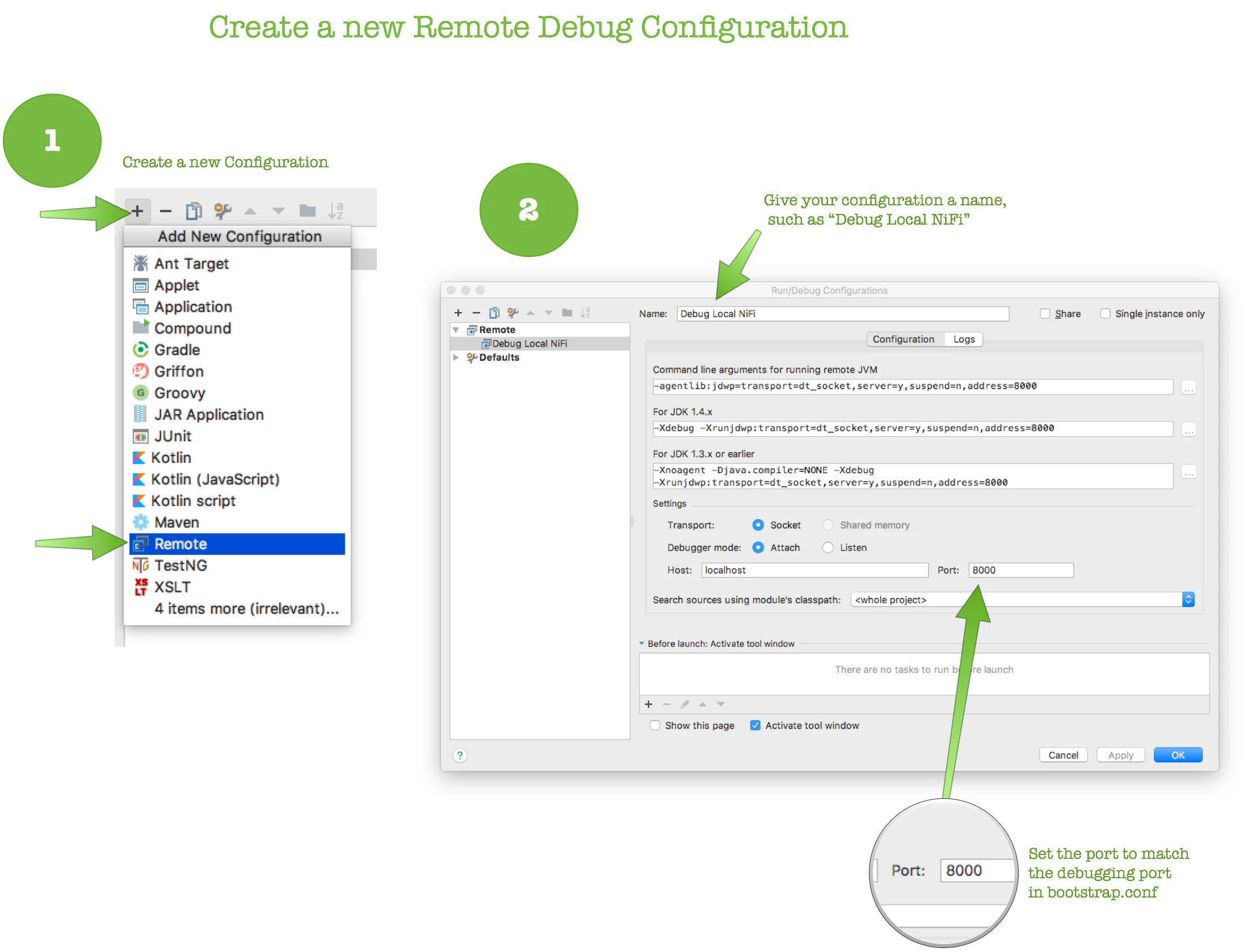

Next, let's create a Run/Debug Configuration that tells IntelliJ how to attach to our NiFi instance:
  1. From the Menu: Run > Edit Configurations...
  2. Click the '+' button and select 'Remote' from the drop down
  3. Give the new configuration a name such as "Debug Local NiFi"
  4. Change the "Port" field to the port that matched the address=XXXX line in bootstrap.conf above (in my case, 8000).

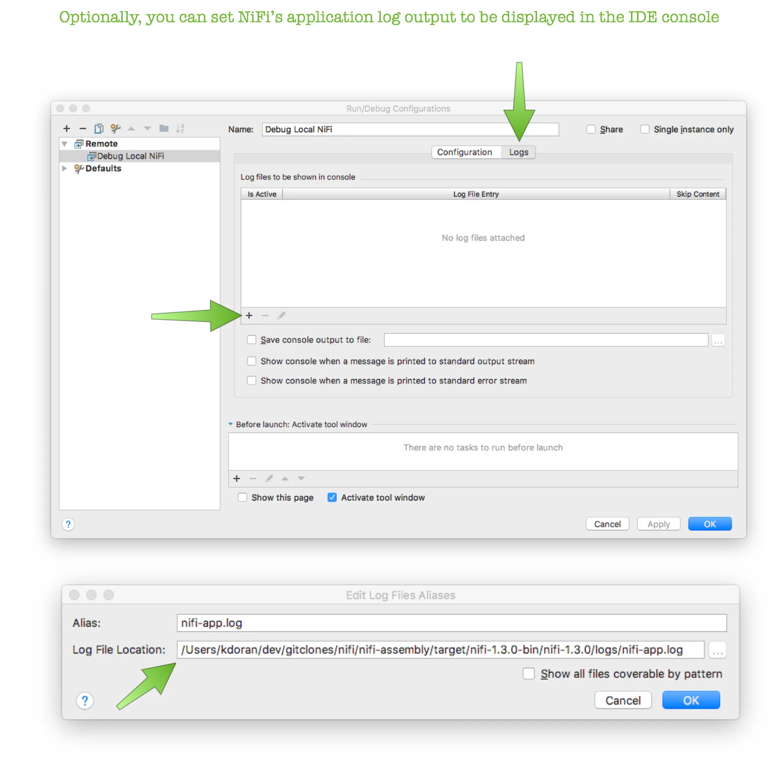

  5. Optional step: Setup the IntelliJ console to display NiFi logs for this configuration.
    1. Switch from the "Configuration" tab to the "Logs"
    2. Click the '+' button in the middle of the panel to add a log file
      1. Choose whatever alias you want
      2. Set the log file location: {NIFI_ROOT}/nifi-assembly/target/nifi-1.3.0-bin/nifi-1.3.0/logs/nifi-app.log

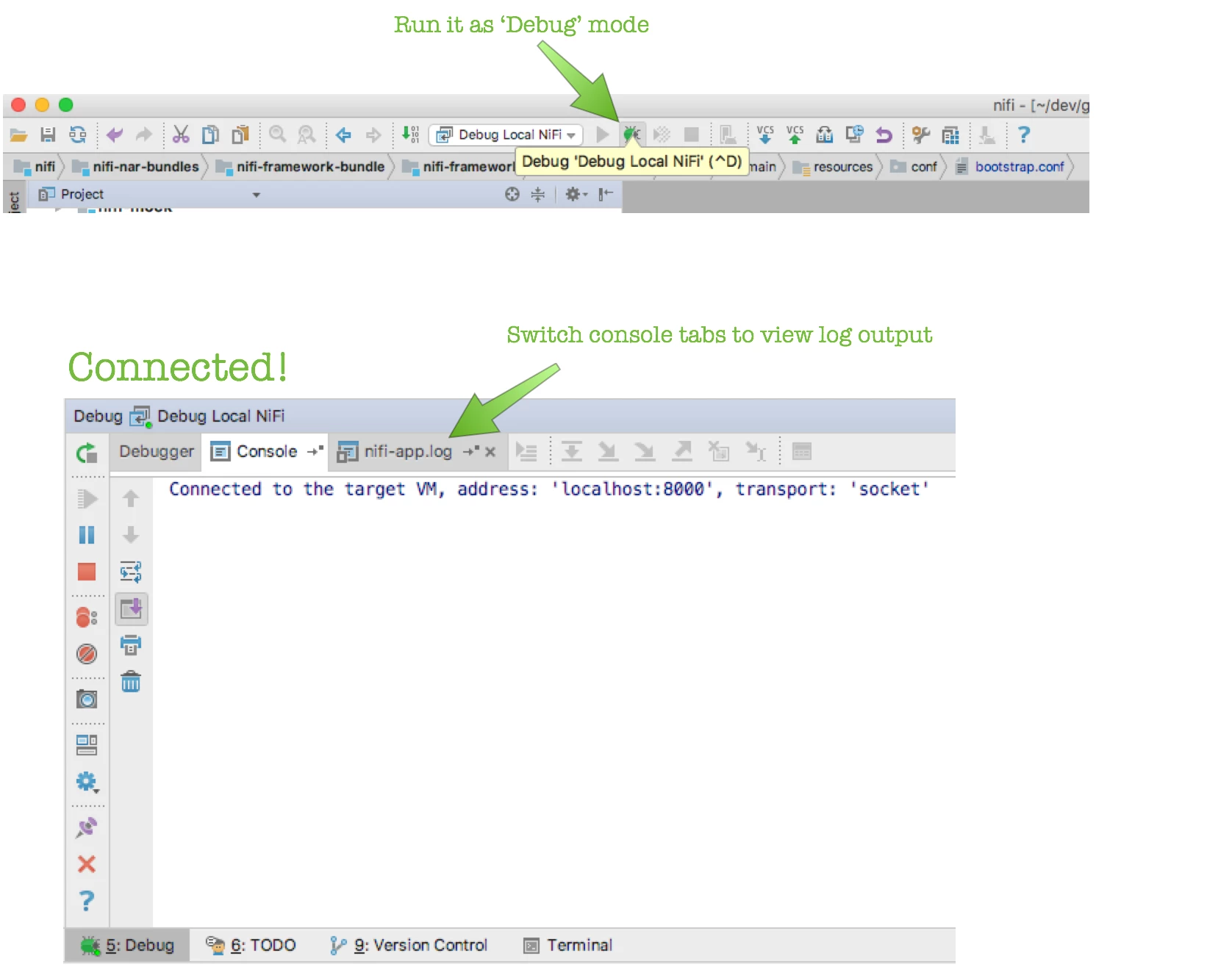

You can now run the configuration to attach to your local NiFi instance whenever NiFi is running on localhost:8080. To launch the debugger, follow the steps in these screenshots:
That's it! NiFi's logging output, set to the proper level of debug output, is available in a table in the IntelliJ IDEA console and we can set a breakpoints in the NiFi source code and pause / step-through lines of code from your running NiFi instance.
