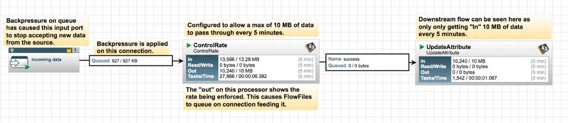

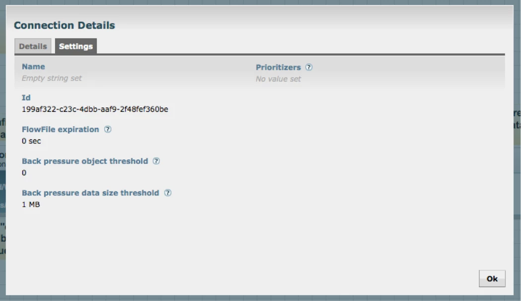

Using backpressure would be one way to prevent this scenario, below is an example:
Backpressure is set in the connection from the input port to the ControlRate processor:
It can be seen that in the above figure that if the backlog of data reaches 1 MB, then the input port would not be able to receive data until the backlog dropped below the threshold and then incoming data from the source system would resume. This configuration allows NiFi to receive the backlog of data at a rate that won't over utilize the system resources. Additionally, adding the ControlRate processor to the flow will ensure that the backlog of data will not overwhelm any processors further down the flow path. This method of combining backpressure with the ControlRate processor is easier than trying to set backpressure in every connection through the complete flow path.

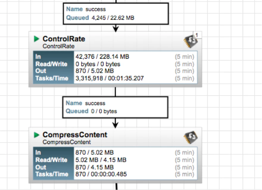

The ControlRate processor is good example of using one processor to prevent another from becoming overwhelmed and/or overwhelming the overall flow. For example, the DFM is only able to allocate one concurrent task to the CompressContent processor, if the queue to the processor becomes too large, that one concurrent task would only be able to scan the queue to determine which flowfile should be compressed next. Meaning, it would spend all of its time looking at its queue and never actually compressing any flow files. Using the above example of the CompressContent processor, then we could use the ControlRate processor to prevent the processor from becoming overwhelmed, by using data rate, flowfile count or even a flowfile attribute to control the rate of data. The below example is using the added filesize attribute to control the rate of data, the first figure shows the configuration of the UpdateAttribute processor adding the filesize attribute:

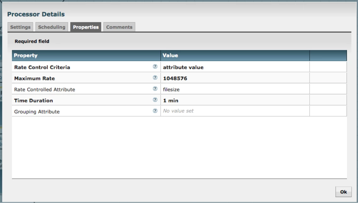

The configuration of the ControlRate processor is shown below. It is set to allow ~1 MB/minute, based on the cumulative size of files through the processor.

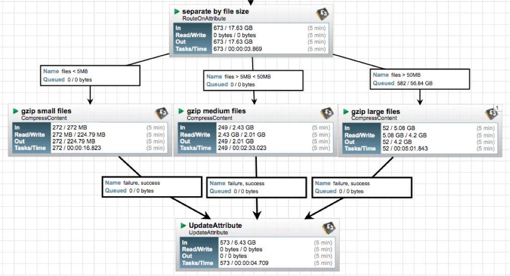

Another aspect of dataflow optimization is to understand the resources needed by each processor. This will allow better dataflow performance. For instance, the CompressContent processor will use 1 CPU/concurrent task, so if this processor has 4 concurrent tasks and there are four files in the queue, then 4 CPUs will be utilized by this processor until the files have been compressed. For small files this becomes less of a resource bottleneck than dealing with large files. A good example of this would be to have small, medium and large files all go down a separate flow paths into 3 different CompressContent processors, each with their own number of concurrent tasks. In the example below, all three CompressContent processors have one concurrent task.
This diagram provides a good example of optimizing throughput. The “Tasks/Time” for each of the CompressContent processors clearly show that the amount of time required to compress larger files is exponentially bigger as the files increase in size. This provides better use of CPU to process the maximum number of files and not letting the arbitrary large files slow down the entire flow. This isn’t specifically noted in the documentation, but is known by the fact that the only way to compress a file either inside or out of NiFi is to use a CPU per file being compressed/uncompressed on the system where the operation is being done.

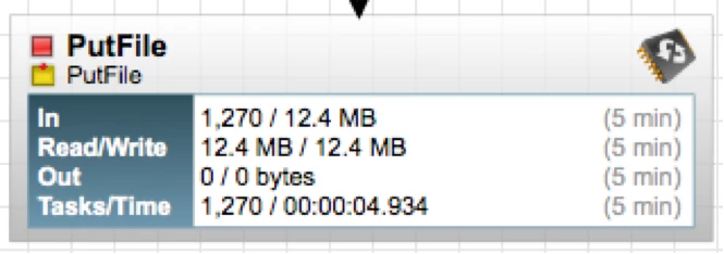

In: The amount of data that the Processor has pulled from the queues of its incoming Connections based on a sliding 5-minute window. This value is represented as <count> / <size> where <count> is the number of FlowFiles that have been pulled from the queues and <size> is the total size of those FlowFiles' content. In this example, the Processor has pulled 1270 FlowFiles from the input queues, for a total of 12.4 megabytes (MB).
Read/Write: The total size of the FlowFile content that the Processor has read from disk and written to disk. This provides valuable information about the I/O performance that this Processor requires. Some Processors may only read the data without writing anything while some will not read the data but will only write data. Others will neither read nor write data, and some Processors will both read and write data. In this example, we see that in the past five minutes, this Processor has read 12.4 MB of the FlowFile content and has written 12.4 MB as well. This is what we would expect since this Processor simply copies the contents of a FlowFile to disk.
Out: The amount of data that the Processor has transferred to its outbound Connections. This does not include FlowFiles that the Processor removes itself, or FlowFiles that are routed to connections that are auto-terminated. Like the “In” metric above, this value is represented as <count> / <size> where <count> is the number of FlowFiles that have been transferred to outbound Connections and <size> is the total size of those FlowFiles' content. In this example, all of the files are written to disk and the connections are auto terminated, so no files have been moved out to downstream connections.
