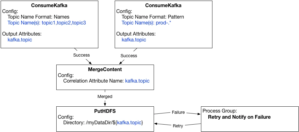

In the image below you can see the configurations and attributes that make this possible. The ConsumeKafka processor can use a list of topics or a regular expression to consume from many topics at once. Each FlowFile (e.g. batch of Kafka messages) has an attribute added called "kafka.topic" to identify its source topic.
Next, in order to load streaming data into HDFS or Hive, it is recommended to use MergeContent to combine records into large files (e.g. every 1GB or every 15 minutes). In MergeContent, setting the “correlation attribute” configuration to “kafka.topic” ensures that only records from the same kafka topic are combined (similar to a group-by clause). After the files are merged, the “directory” configuration in HDFS can be parameterized (e.g. /myDir/${kafka.topic}) in order to load the data into the correct directory based on the kafka topic name.
Note that this diagram includes a retry and notify on failure process group. This type of solution is highly recommended for production flows. More information can be found here.
