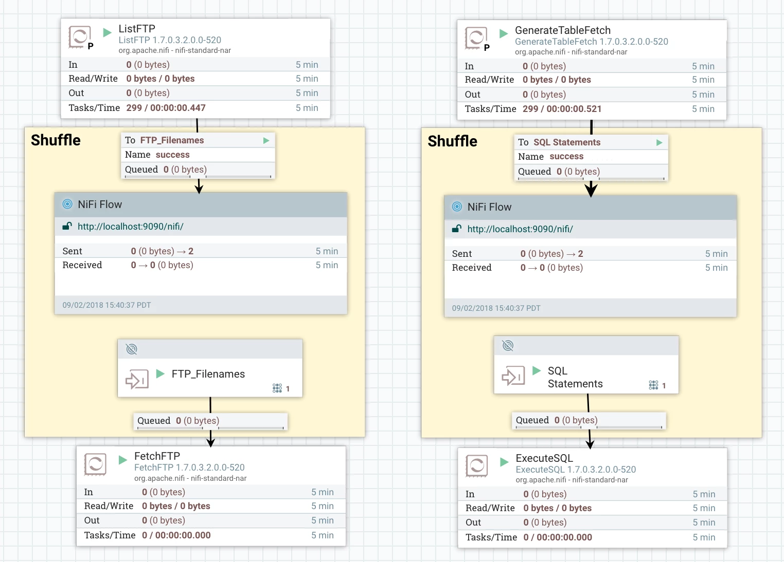

The shuffle step is not an explicit component on the NiFi canvas, but rather the combination of a Remote Input Port and a Remote Process Group pointing at the local cluster. FlowFiles that are sent to the Remote Process Group will be load balanced over Site-to-Site and come back into the flow via the Remote Input Port. Under “Manage Remote Ports” on the Remote Process Group there are batch settings that help control the load balancing.
Here are two example flows that use this design pattern:
