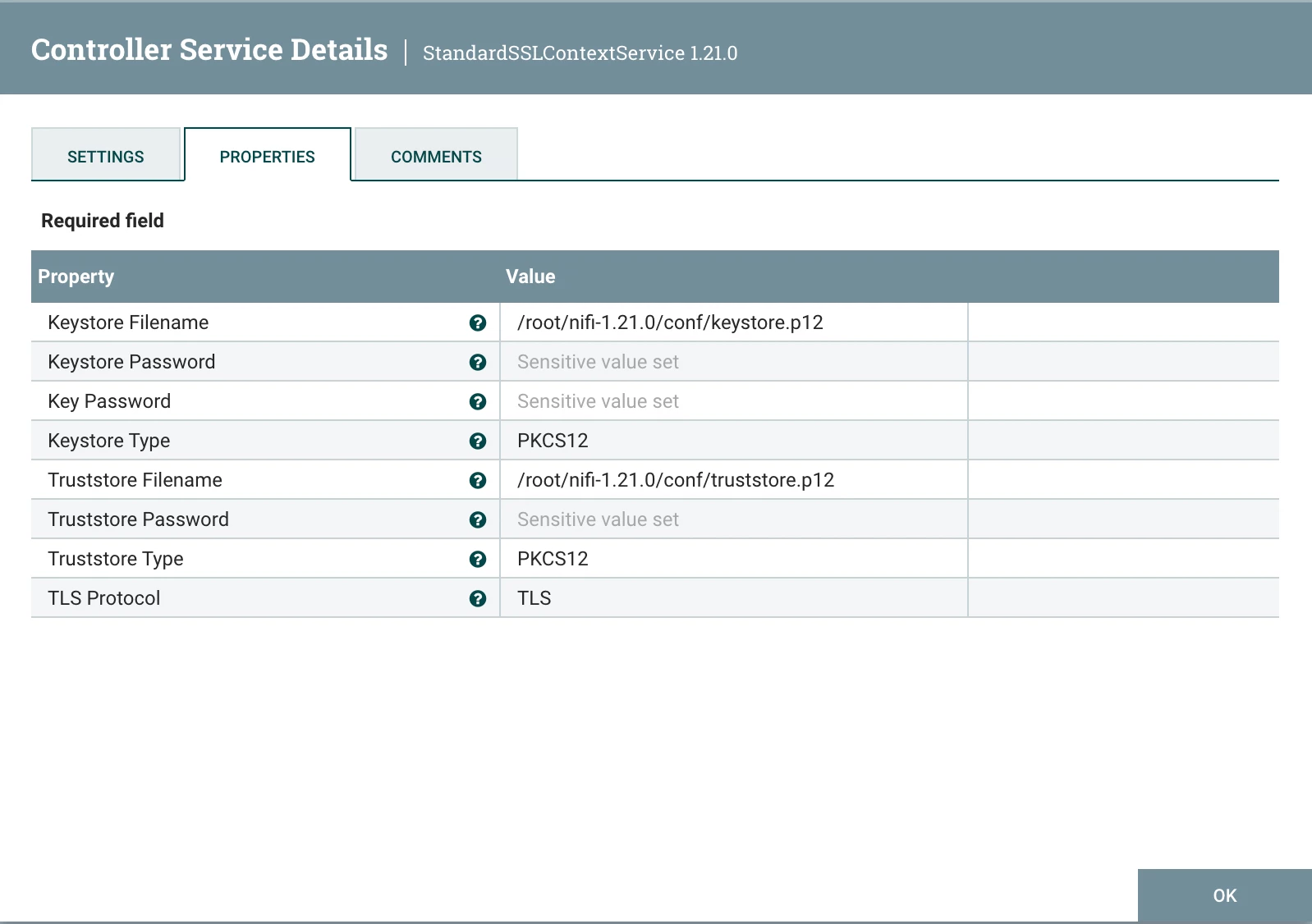

Now that we have the details we need (keystore,truststore,and passwords) we can make a new SSL Context Service like this:

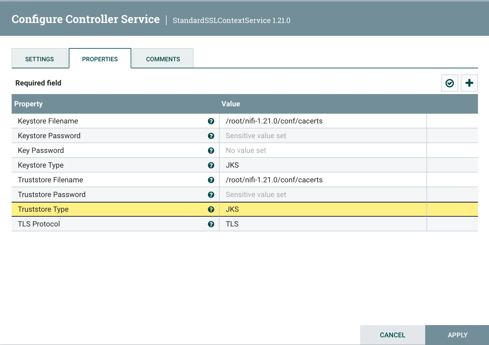

 It is still possible to create more SSL Context Services, especially if you have self signed or custom certs attached to external endpoints you need to communicate with.  To connect to most public signed certs, java's cacerts works great.   This is always the first SSL Context Service I start with for connecting to public https:// endpoints.
First I need to copy cacerts to my nifi conf directory:
cp /usr/lib/jvm/java-11-openjdk-11.0.13.0.8-4.el8_5.x86_64/lib/security/cacerts /root/nifi-1.21.0/conf/
Now I can create a new SSL Context Service like this:
The cacerts password is "changeit".
