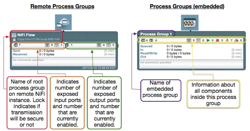

The purpose of this article is to explain what Process Groups and Remote Process Groups (RPGs) are and how input and output ports are used to move FlowFiles between them. Process groups are a valuable addition to any complex dataflow. They give DataFlow Managers (DFMs) the ability to group a set of processors on to their own imbedded canvas. Remote Process groups allow a DFM to treat another NiFi instance or cluster as just another process group in the larger dataflow picture. Simply being able to build flows on different canvases is nice, but what if I need to move NiFi FlowFiles between these canvases? This is where input and output ports come in to play. They allow you move FlowFiles between these canvases that are either local to a single NiFi or between the canvases of complete different NiFi instances/clusters.

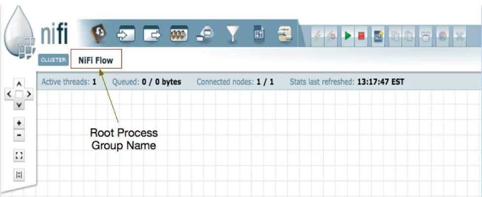

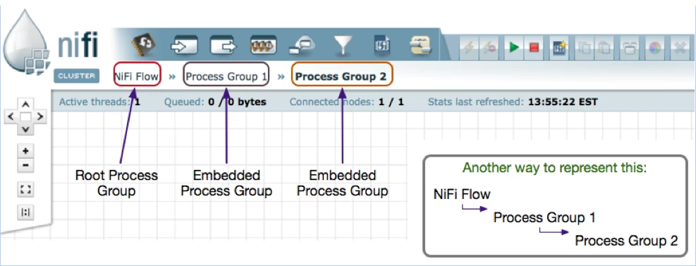

Embedded Process Groups: Lets start by talking about the simplest use of multiple embedded canvases through process groups. When you started NiFi for the very first time you are given a blank canvas. This blank canvas is noting more then a process group in itself. The process group is referred to as the root process group.

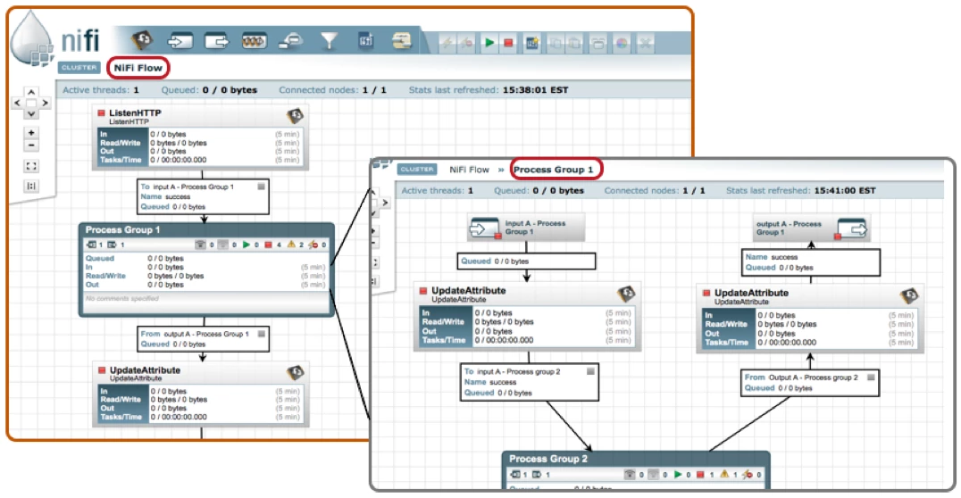

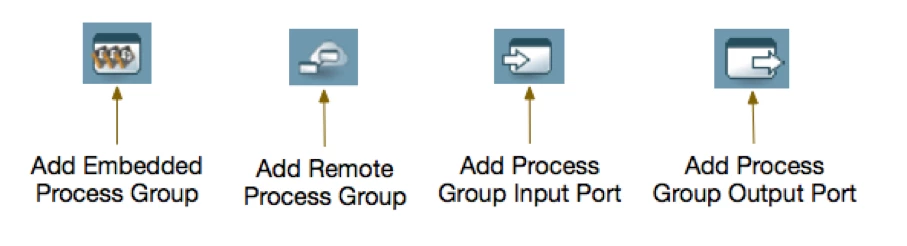

From there you are able to add additional process groups to that top-level canvas. These added process groups allow you drill down in to them giving additional blank canvases you could build dataflows on. When you enter a process group you will see the hierarchy represented just above the canvas in the UI ( NiFi Flow >> Process Group 1 ). NiFi does not restrict the number of process groups you can create or the depth you can go with them. You could compare the process group hierarchy to that of a Windows directory structure. So if you added another process group inside one that you already created, you would essentially now have gone two layers deep. ( NiFi Flow >> Process Group 1 >> Process Group 2 ). The hierarchy represented above you canvas allows you to quickly jump up one or more layers all the way to the root level by simply clicking on the name of the process group.

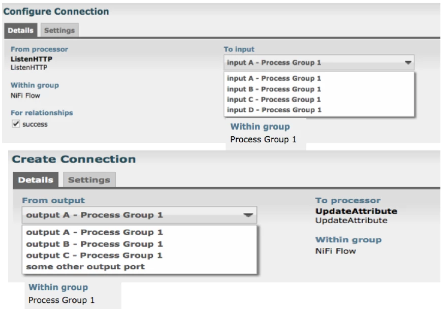

While you can add any number of process groups at the same embedded level, the hierarchy is only shown from root down to the current process group you are in. Now that we understand how to add embedded process groups, lets talk about how we move data in and out of these process groups. This is where input and output ports come in to play. Input and output ports exist to move FlowFIles between a process group andONE LEVEL UPfrom that process group. Input ports will accept FlowFiles coming from one level up and output ports allow FlowFiles to be sent one level up. If I have a process group added to my canvas, I cannot drag a connection to it until at least one input port exists inside that process group. I also cannot drag a connection off of that process group until at least on output port exists inside the process group. You can only move FlowFiles up or down one level at a time. Given the example of a process group within another process group, FlowFiles would need to be moved from the deepest level up to the middle layer before finally being able to be moved to the root canvas.
In the above example I have a small flow pushing FlowFiles into an embedded process group (Process Group 1) and also pulling data from the same embedded process group. As you can see, I have created an input and output port inside Process Group 1. This allowed me to draw a connection to and from the process group on the root canvas layer. You can have as many different input and output ports inside any process group as you like. When you draw the connection to a process group, you will be able to select which input port to send the FlowFiles to. When you draw a connection from a process group to another processor, you will be able to pick which output port to pull FlowFiles from.
Every input and output port within a single process group must have a unique name. NiFi validates the port name to prevent this from happening.
Remote Process Groups:
We refer to the ability to send FlowFiles between different NiFi instances as Site-to-Site. Site-to-Site is configured very much in the same way we just configured moving files between embedded process groups on a single NiFi instance. Instead of moving FlowFiles between different process groups (layers) within the same NiFi, we are moving FlowFiles between different NiFi instances or clusters. If a DFM reaches a point in their dataflow where they want to send data to another NiFi instance or cluster, they would add a Remote Process Group (RPG). These Remote Process Groups are not configured with unique system port numbers, but instead all utilize the same Site-to-Site port number configured in your nifi.properties files. I will not be covering the specific NiFi configuration needed to enable site-to-site in this article. For information on how to enable and configure Site-to-Site on a NiFi instance, see the Site-to-Site Properties section of the Admin Guide. Lets take a quick look at how these two components differ:

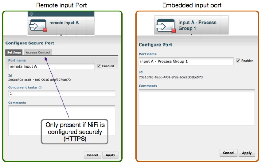

As I explained earlier, input and output ports are used to move FlowFiles one level up from the process group they are created in. At the top level of your canvas (root process group level) adding input or output ports provides the ability for that NiFi to receive (input port) FlowFiles from another NiFi instance or have another NiFi pull files from (output port) that NiFi. We refer to input and output ports added the top level as remote input or output ports. While the same input and output icon in the UI is used to add both remote and embedded input and output ports, you will notice that they are rendered differently when added to the canvas.
If your NiFi has been configured to be secure (HTTPS) using server certificates, the remote input/output port’s configuration windows will have an “Access Control” tab where you must authorize which remote NiFI systems are allowed to see and access these ports. If not running secure, all remote ports are exposed and accessible by any other NiFi instance.
In single instance you can send data to an input port inside a process group by dragging a connection to the process group and selecting the name of the input port from a selection menu provided. Provided that the remote NiFi instance has input ports exposed to your NiFi instance, you can drag a connection to the RPG much in the same way you previously dragged a connection to the embedded process groups within a single instance of NiFi. You can also hover over the RPG and drag a connection off of the RPG, which will allow you to pull data from an available output port on the target NiFi.

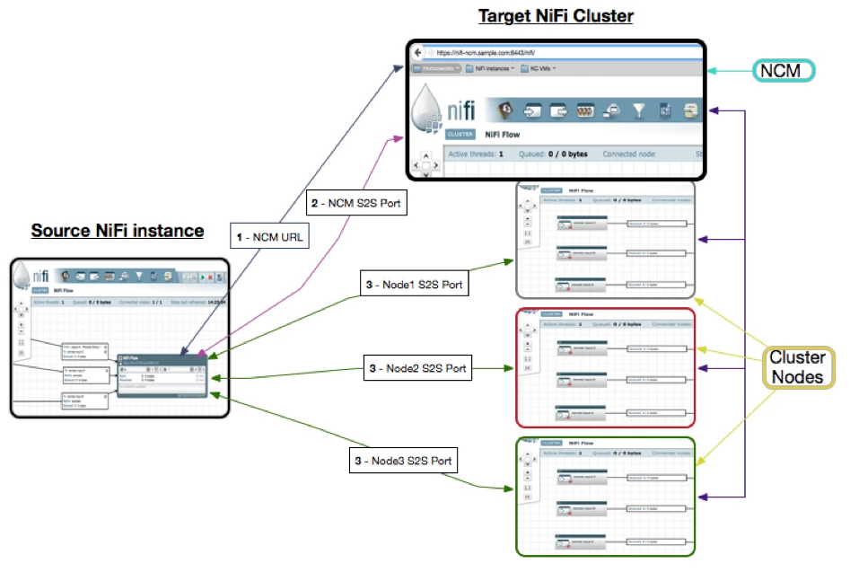

The Source NiFi (standalone or cluster) can have as many RPGs as a DFM would like. You can have multiple RPGs in different areas of your dataflows that all connect to the same remote instance. While the target NiFi contains the input and output ports (Only Input and output ports added to root level process group can be used for Site-to-Site Flowfile transfers).
When sending data between two standalone NiFi instance the setup of your RPG is fairly straight forward. When adding the RPG, simply provide the URL for the target instance. The source RPG will communicate with the URL to get the Site-to-Site port to use for FlowFile transfer. When sending FlowFiles via Site-to-Site to a NiFi that is a NiFi cluster we want the data going to every node in the cluster. The Site-to-Site protocol handles this for you with some additional load-balancing benefits built in. The RPG is added and configured to point at the URL of the NCM. (1)The NCM will respond with the Site-to-Site port for the NCM. (2) The source will connect to the Site-to-Site port of the NCM which will respond to the source NiFi with the URLs, Site-to-Site port numbers, and current loads on every connected node. (3) The source NiFi will then load-balance FlowFile delivery to each of those nodes giving fewer FlowFiles to nodes that are under heavier load. The following diagram illustrates these three steps:
A DFM may choose to use Site-to-Site to redistribute data arriving on a single node in a cluster to every node in that same cluster by adding a RPG that points back at the NCM for that cluster. In this case the source NiFi instance is also one of the target NiFi instances.

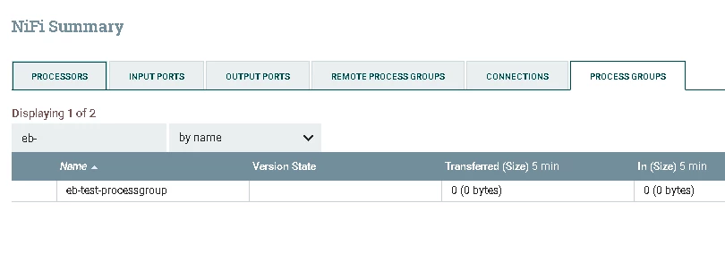

ebeb
Gold ⭐️⭐️
Jan 24, 2022 4:33 PM UTC
Thanks @MattWho , actually found a way to filter/search process groups by name using the Summary option in the top right menu. This is very useful to find all the ETL pipelines once we give proper names and then by entering a part of the name we can show all matching Process Groups. Being a newbie I am trying to compare Streamsets UI to Nifi UI so I can work the same way. Streamsets provides an initial list of all ETL pipelines to filter by name etc. I guess if just after Nifi login if we saw two links: Summary and Canvas then users can click intuitively on the summary screen and review all their Process groups and click on specific PG they want to work with. This would make it similar to other ETL tools like Streamsets.
