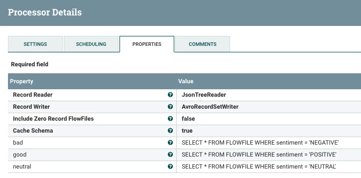

Step 12 - I run QueryRecord to route POSITIVE, NEURAL and NEGATIVE sentiment to different places. Example SQL: SELECT * FROM FLOWFILE WHERE sentiment = 'NEGATIVE' Thanks Apache Calcite! We also convert from JSON to AVRO for sending to Kafka also for easy conversion to Apache ORC for Apache Hive usage.

You can see the queries in the QueryRecord processor.

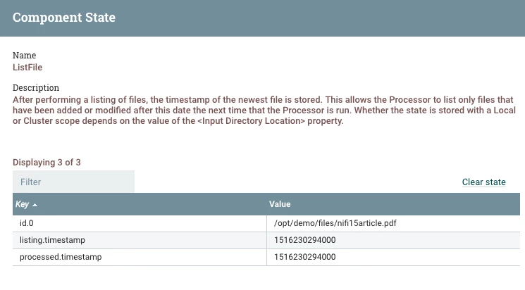

The results of a run showing a sentence, file meta data and sentiment.
54390-listfilestate.png'
We are now waiting for new PDFs (and other file types) to arrive in the directory for immediate processing.
I have a JSONTreeReader, a Hortonworks Schema Registry and and AvroRecordSetWriter.
We set the properties and the schema register for the reader and writer. Obviously we can use other readers and writers as needed for types like CSV.
