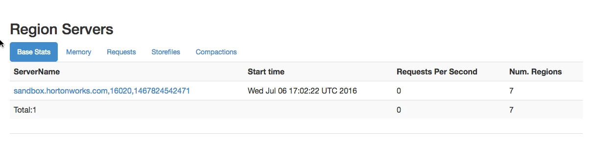

Simple way to check how many regions you have hosted per RS is by going to the HBase Master UI through ambari. On the front page you will find the number:
