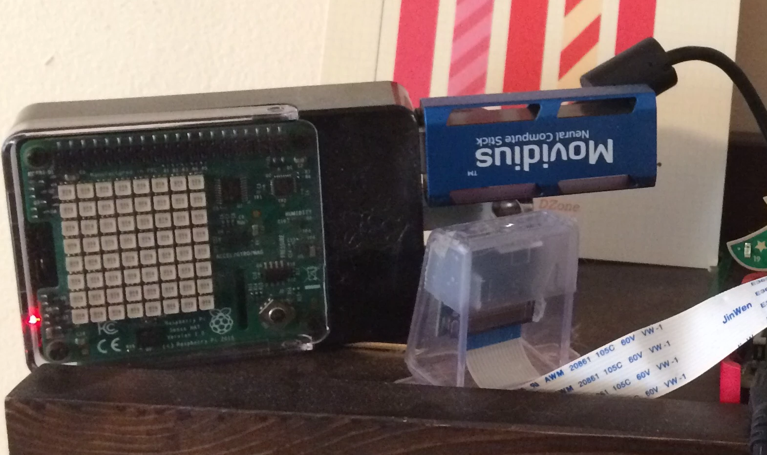

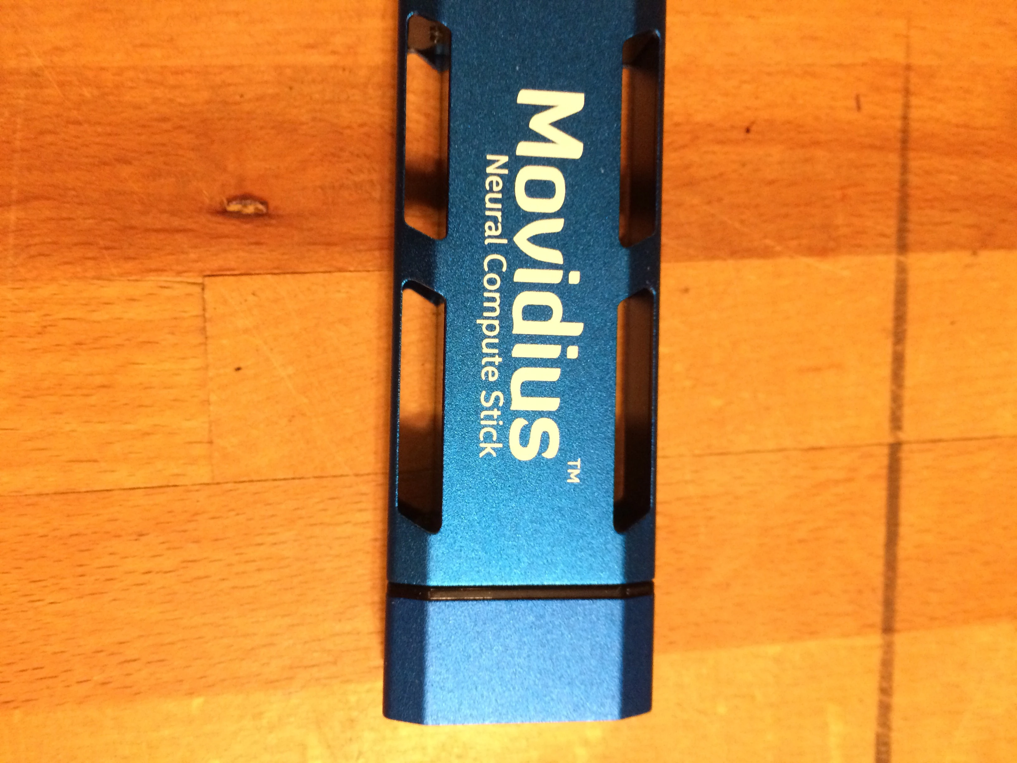

Adding a Movidius NCS to a Raspberry Pi is a great way to augment your deep learning edge programming.
Hardware Setup
  • Raspberry Pi 3
  • Movidius NCS
  • PS 3 Eye Camera
  • 128GB USB Stick

This same device also has a Sense-Hat, so we grab those as well.
Then I combined the two sets of code to produce a row of Sense-Hat sensor data and NCS AI results.

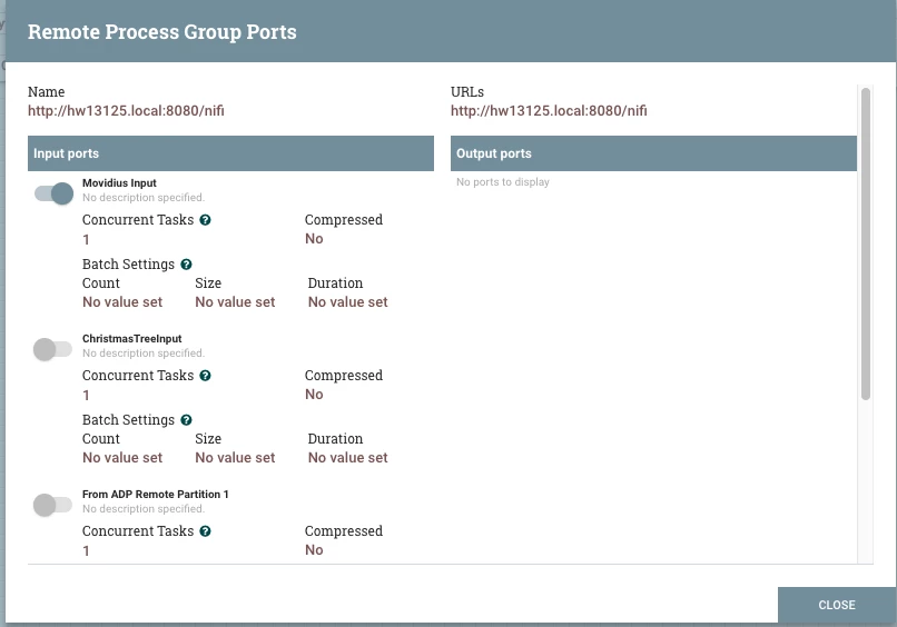

Input Ports:
- id: befe3bd8-b4ac-326c-becf-fc448e4a8ff6
name: MiniFi From TX1 Jetson
comment: ''
max concurrent tasks: 1
use compression: false
- id: 0d6447ee-be36-3ec4-b896-1d57e374580f
comment: ''
- id: e43fd055-eb0c-37b2-ad38-91aeea9380cd
comment: ''
- id: 4689a182-d7e1-3371-bef2-24e102ed9350
name: From ADP Remote Partition 1
comment: ''

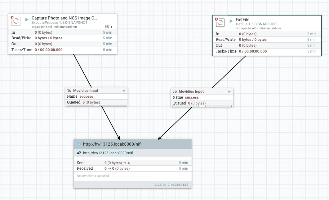

Start Apache MiniFi on Your RPI Box
root@sensehatmovidius:/opt/demo/minifi-0.3.0/logs# ../bin/minifi.sh start1686],offset=0,name=2017-12-28_1452.jpg,size=531686], StandardFlowFileRecord[uuid=ca84bb5f-b9ff-40f2-b5f3-ece5278df9c2,claim=StandardContentClaim [resourceClaim=StandardResourceClaim[id=1514490624975-1, container=default, section=1], offset=1592409, length=531879],offset=0,name=2017-12-28_1453.jpg,size=531879], StandardFlowFileRecord[uuid=6201c682-967b-4922-89fb-d25abbc2fe82,claim=StandardContentClaim [resourceClaim=StandardResourceClaim[id=1514490624975-1, container=default, section=1], offset=2124819, length=527188],offset=0,name=2017-12-28_1455.jpg,size=527188]] (2.53 MB) to http://hostname.local:8080/nifi-api in 639 milliseconds at a rate of 3.96 MB/sec
2017-12-28 15:08:35,588 INFO [Timer-Driven Process Thread-8] o.a.nifi.remote.StandardRemoteGroupPort RemoteGroupPort[name=Movidius Input,targets=http://hostname.local:8080/nifi] Successfully sent [StandardFlowFileRecord[uuid=670a2494-5c60-4551-9a59-a1859e794cfe,claim=StandardContentClaim [resourceClaim=StandardResourceClaim[id=1514490883824-2, container=default, section=2], offset=530145, length=531289],offset=0,name=2017-12-28_1456.jpg,size=531289], StandardFlowFileRecord[uuid=39cad0fd-ccba-4386-840d-758b39daf48e,claim=StandardContentClaim [resourceClaim=StandardResourceClaim[id=1514491306665-2, container=default, section=2], offset=0, length=504600],offset=0,name=2017-12-28_1501.jpg,size=504600], StandardFlowFileRecord[uuid=3c2d4a2b-a10b-4a92-8c8b-ab73e6960670,claim=StandardContentClaim [resourceClaim=StandardResourceClaim[id=1514491298789-1, container=default, section=1], offset=0, length=527543],offset=0,name=2017-12-28_1502.jpg,size=527543], StandardFlowFileRecord[uuid=92cbfd2b-e94a-4854-b874-ef575dcf3905,claim=StandardContentClaim [resourceClaim=StandardResourceClaim[id=1514490883824-2, container=default, section=2], offset=0, length=529618],offset=0,name=2017-12-28_1454.jpg,size=529618]] (2 MB) to http://hostname.local:8080/nifi-api in 439 milliseconds at a rate of 4.54 MB/sec
2017-12-28 15:08:41,341 INFO [Timer-Driven Process Thread-2] o.a.nifi.remote.StandardRemoteGroupPort RemoteGroupPort[name=Movidius Input,targets=http://hostname.local:8080/nifi] Successfully sent [StandardFlowFileRecord[uuid=3fb7ca68-3e10-40c6-8f37-49532134689d,claim=StandardContentClaim [resourceClaim=StandardResourceClaim[id=1514491710195-1, container=default, section=1], offset=0, length=567],offset=0,name=21532511724407,size=567]] (567 bytes) to http://hostname.local:8080/nifi-api in 113 milliseconds at a rate of 4.88 KB/sec

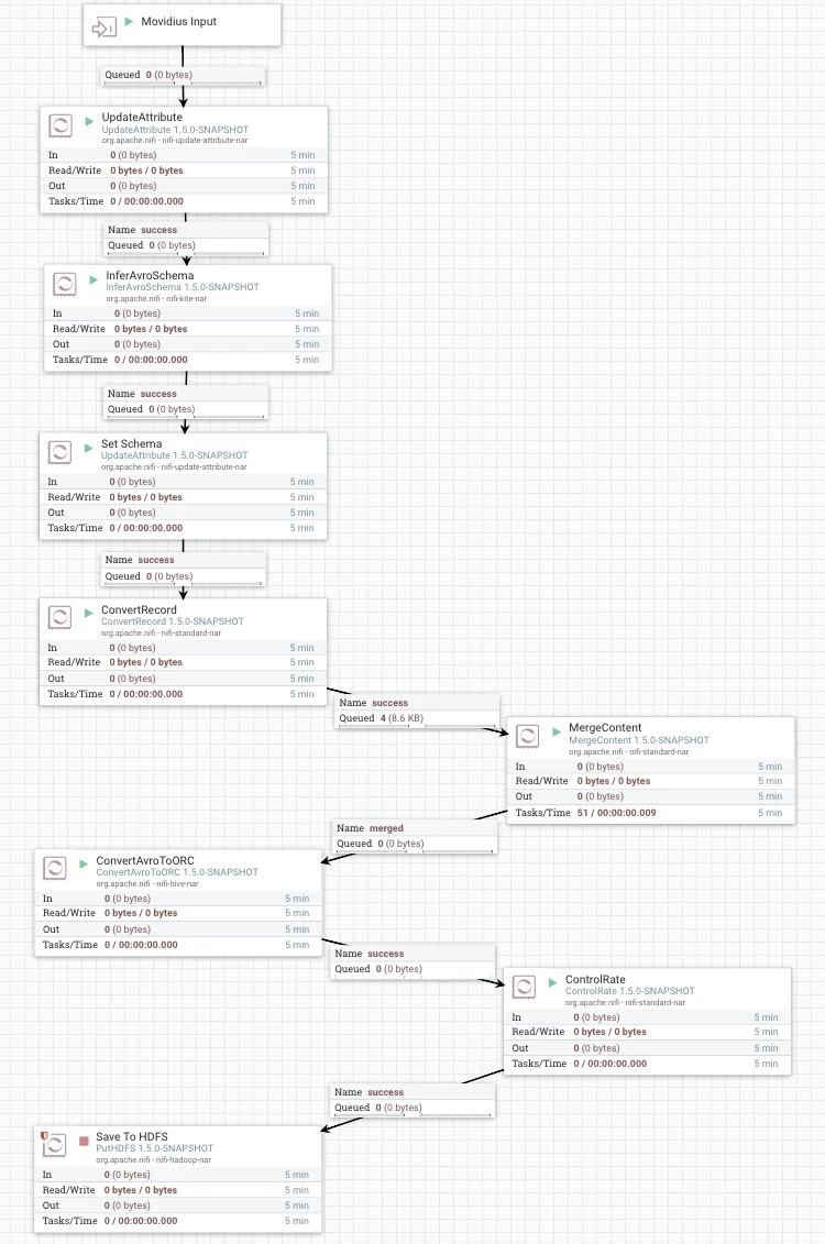

Our Apache MiniFi flow sends that data via HTTP to our Apache NiFi server for processing and converting into a standard Apache ORC file in HDFS for Apache Hive queries.

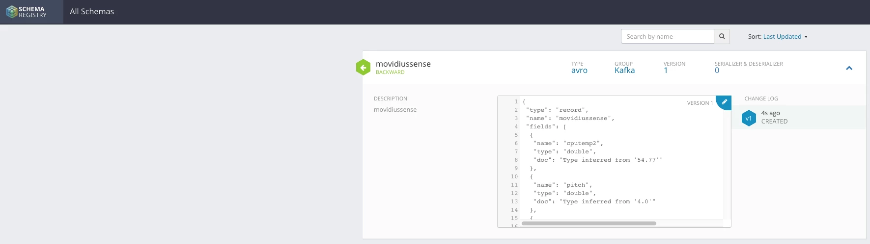

Using InferAvroSchema we build a schema and upload it to the Hortonworks Schema Registry for processing.
Schema
"type": "record",
"name": "movidiussense",
"fields": [
"name": "cputemp2",
"type": "double",
"doc": "Type inferred from '54.77'"
"name": "pitch",
"type": "double",
"doc": "Type inferred from '4.0'"
"name": "label5",
"type": "string",
"doc": "Type inferred from '\"b'n04238763 slide rule, slipstick'\"'"
"name": "starttime",
"type": "string",
"doc": "Type inferred from '\"2017-12-28 20:08:37\"'"
"name": "label2",
"type": "string",
"doc": "Type inferred from '\"b'n02871525 bookshop, bookstore, bookstall'\"'"
"name": "y",
"type": "double",
"doc": "Type inferred from '1.0'"
"name": "currenttime",
"type": "string",
"doc": "Type inferred from '\"2017-12-28 20:08:39\"'"
"name": "x",
"type": "double",
"doc": "Type inferred from '-0.0'"
"name": "label4",
"type": "string",
"doc": "Type inferred from '\"b'n03482405 hamper'\"'"
"name": "roll",
"type": "double",
"doc": "Type inferred from '94.0'"
"name": "temp",
"type": "double",
"doc": "Type inferred from '35.31'"
"name": "host",
"type": "string",
"doc": "Type inferred from '\"sensehatmovidius\"'"
"name": "diskfree",
"type": "string",
"doc": "Type inferred from '\"15817.0 MB\"'"
"name": "memory",
"type": "double",
"doc": "Type inferred from '39.2'"
"name": "label3",
"type": "string",
"doc": "Type inferred from '\"b'n02666196 abacus'\"'"
"name": "label1",
"type": "string",
"doc": "Type inferred from '\"b'n02727426 apiary, bee house'\"'"
"name": "yaw",
"type": "double",
"doc": "Type inferred from '225.0'"
"name": "cputemp",
"type": "int",
"doc": "Type inferred from '55'"
"name": "humidity",
"type": "double",
"doc": "Type inferred from '17.2'"
"name": "tempf",
"type": "double",
"doc": "Type inferred from '75.56'"
"name": "z",
"type": "double",
"name": "pressure",
"type": "double",
"doc": "Type inferred from '1033.2'"
"name": "ipaddress",
"type": "string",
"doc": "Type inferred from '\"192.168.1.156\"'"
Our data is now in HDFS with an Apache Hive table that Apache NiFi has generated the Create Table DDL for as follows:
CREATE EXTERNAL TABLE IF NOT EXISTS movidiussense (cputemp2 DOUBLE, pitch DOUBLE, label5 STRING, starttime STRING, label2 STRING, y DOUBLE, currenttime STRING, x DOUBLE, label4 STRING, roll DOUBLE, temp DOUBLE, host STRING, diskfree STRING, memory DOUBLE, label3 STRING, label1 STRING, yaw DOUBLE, cputemp INT, humidity DOUBLE, tempf DOUBLE, z DOUBLE, pressure DOUBLE, ipaddress STRING) STORED AS ORC LOCATION '/movidiussense'
