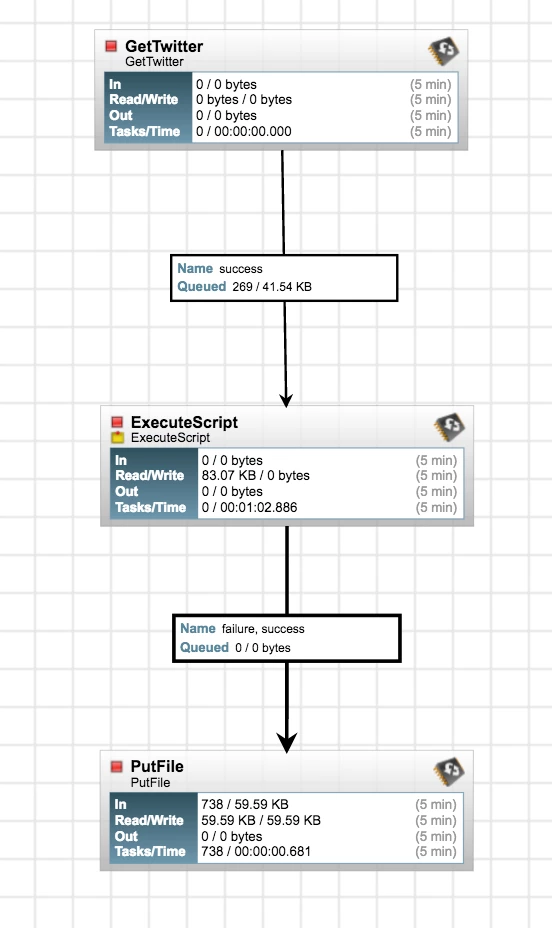

In NiFi the data being passed between operators is referred to as a FlowFile and can be accessed via various scripting languages in the ExecuteScript operator.
In order to access the data in the FlowFile you need to understand a few requirements first.
In this example we will access the json data being passed into the ExecuteScript operator via a getTwitter operator.
This could be any data ingestion operator.
Using the ExecuteScript (Note: Execute script will use Jython libraries which are good but limited. If you have a python script which uses other libs and produces an output you can use Execute Process instead which will execute the python script on the machine using the full python lib and the output will become your flow file. )  operator set the script type to python and in the "script body" section enter the following code:

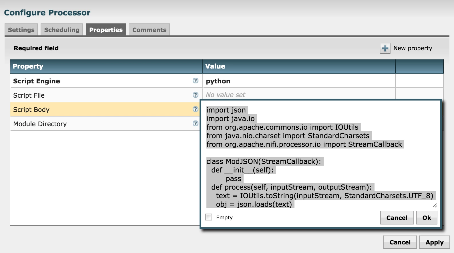

import json
import java.io
from org.apache.commons.io import IOUtils
from java.nio.charset import StandardCharsets
from org.apache.nifi.processor.io import StreamCallback
class ModJSON(StreamCallback):
def __init__(self):
pass
def process(self, inputStream, outputStream):
text = IOUtils.toString(inputStream, StandardCharsets.UTF_8)
obj = json.loads(text)
newObj = {
"Source": "NiFi",
"ID": obj['id'],
"Name": obj['user']['screen_name']
outputStream.write(bytearray(json.dumps(newObj, indent=4).encode('utf-8')))
flowFile = session.get()
if (flowFile != None):
flowFile = session.write(flowFile, ModJSON())
flowFile = session.putAttribute(flowFile, "filename", flowFile.getAttribute('filename').split('.')[0]+'_translated.json')
session.transfer(flowFile, REL_SUCCESS)
session.commit()
the import statements are required to take advantage of the NiFi components.
The way we actually access the flowfile is through a global variable available to you in NiFi called "session".
As you can see:
is how we grab the IOStream from NiFi and the pass to the processing Class via the session.write() method.
You can build up a new JSON object while referencing attributes from the source JSON as you can see in the script:
newObj = {
"Source": "NiFi",
"ID": obj['id'],
This should help you get started with using python scripts inside of NiFi.
I hope to see some posts of how you modify this to create more interesting flows.

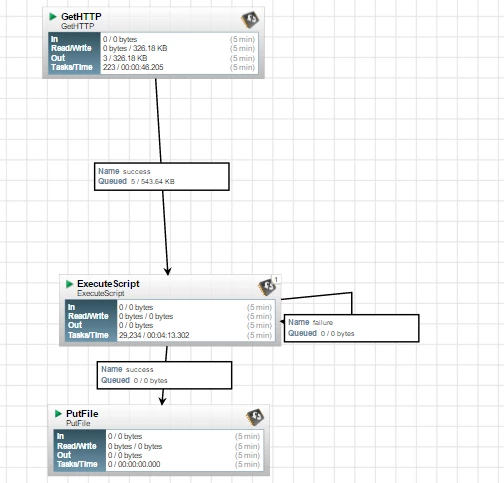

Hi,
Thank you very much for the tutorial. I am new to Nifi and trying out some use cases. I followed your steps to write a Jython script where I read from an xml file(rss) and then convert it into a string and write to outputStream and routed to putFile. The problem I am facing is that the data is getting queued in the connection to ExecuteScript and not getting into the processor. I am posting the code I wrote here in the ExecuteScript Script body. Did I need to point it to a module directory?

That is strange. I see that you loop the failures back into the script processor. Can you delete that and route failure and success to the PutFile processor?

I did as you said but to no avail. It's the same. And, there's nothing populating the bulletin board for me to debug.

It looks like flowFile.get() is in a method in a class All that script does is define a class and exit. Gotta move the indents so the flowFile.get() block is outside the class definition (so no indent at all). That might fix the issue.

In the example above, ExecuteScript Processor is showing some error and write is zero bytes from it.
GetTwitter (In: 0/0 bytes)
ExecuteScript (In: 0/0 bytes)
PutFile (In : 738 /59.59 KB) How ?
Is this example working.

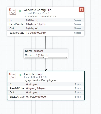

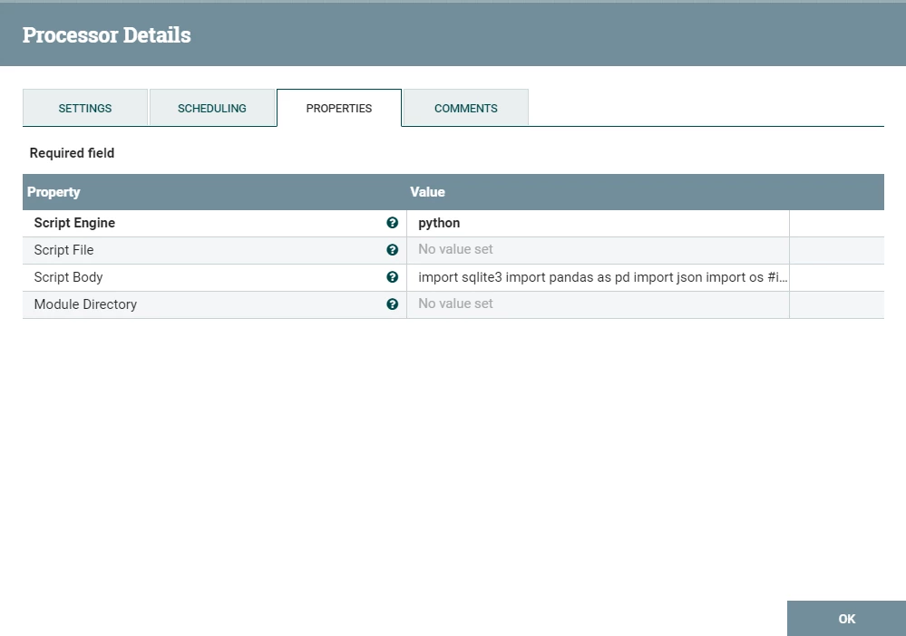

I am trying to create a data flow with nifi using python scripts. To begin the process I used ExecuteProcess processor and to execute subsequent scripts I am trying to use ExecuteScript processor.as I need to build dependency between my flow. I want the subsequent job to run only if the dependent job executes successfully.
However, I see that the 'ExecuteProcess' jobs runs successfully but the subsequent 'ExecuteScript' jobs does not starts. I also see the relationship queue is empty. How can I make the flow run successfully.
Here are the screenshots for your reference:
