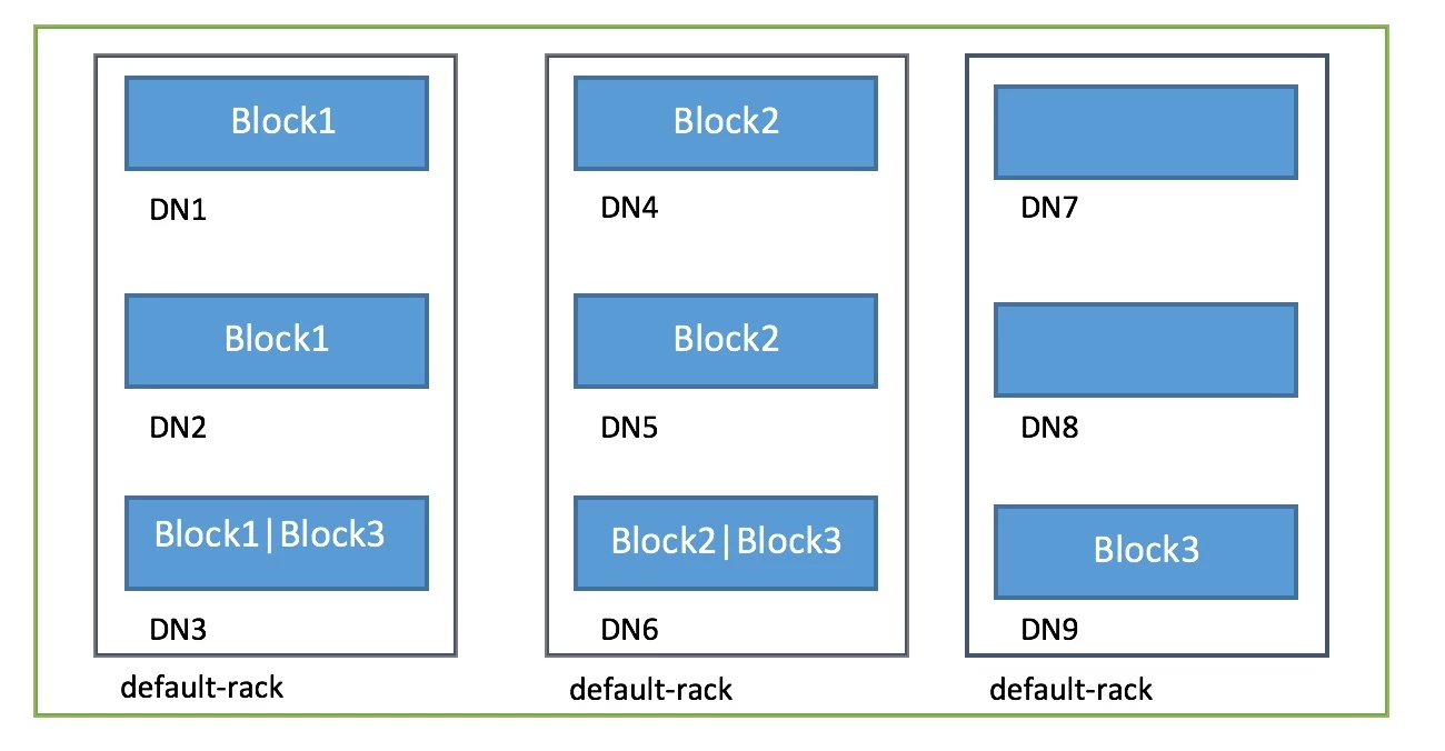

The following diagram depicts an example block placement when HDFS and Yarn are not rack aware:
  • What happens if Rack1 goes down? -> Potentially data in Block1 might be lost
    • Not being Rack aware the entire cluster is thought of placed in default-rack

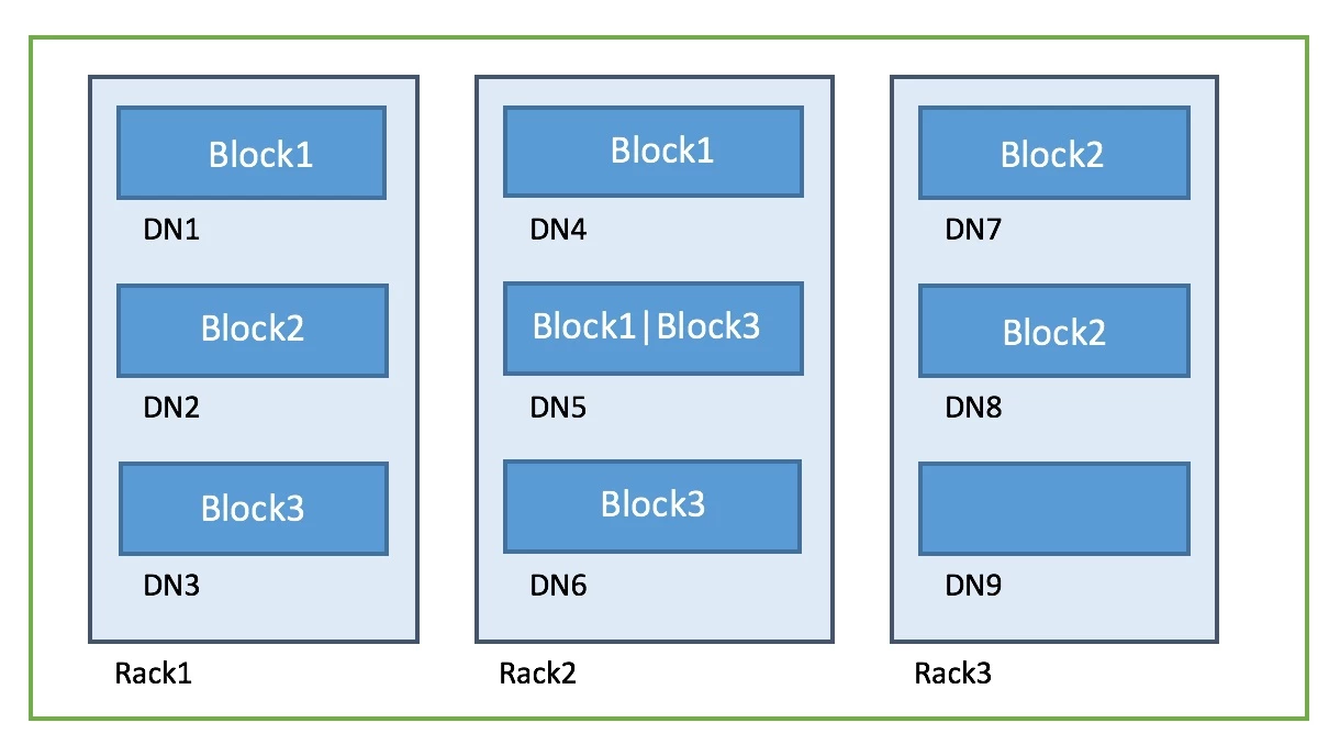

The following diagram depicts an example block placement when HDFS and Yarn are rack aware:
  • What happens if Rack1 goes down? We still have the block replicas in other data nodes
So evidently Rack awareness increases data availability. Also the HDFS balancer and decommissioning of data nodes are rack aware operations.
What about performance?
  • Faster replication operation. Since the replicas are placed within the same rack it would use higher bandwidth and lower latency hence making it faster.
  • If YARN is unable to create a container in the same data node where the queried data is located it would try to create the container in a data node within the same rack. This would be more performant because of the higher bandwidth and lower latency of the data nodes inside the same rack.
