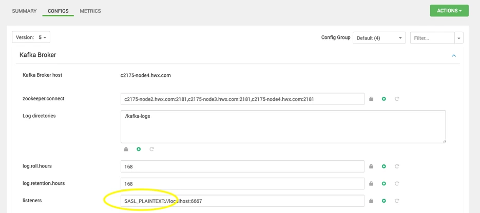

Make sure that Kerberos is correctly enabled for kafka on your cluster. We will want to verify that the kafka broker properties are set to listen on SASL_PLAINTEXT through ambari -> kafka -> configs:

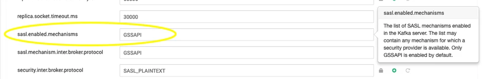

Also verify that GSSAPI is listed in the sasl.enabled.mechanisms property:
