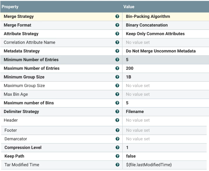

a. MergeContent

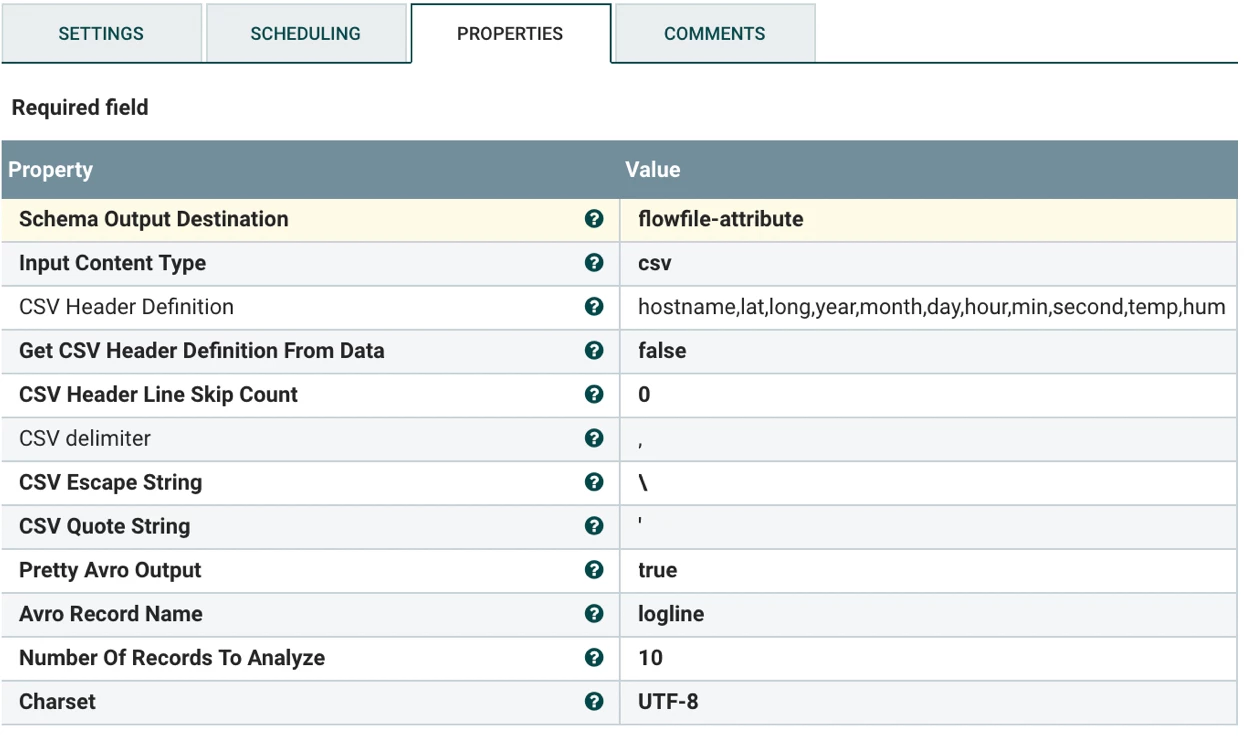

b. InferAvroSchema – In the CSV header definition put all the headers of your data separated by delimiter.

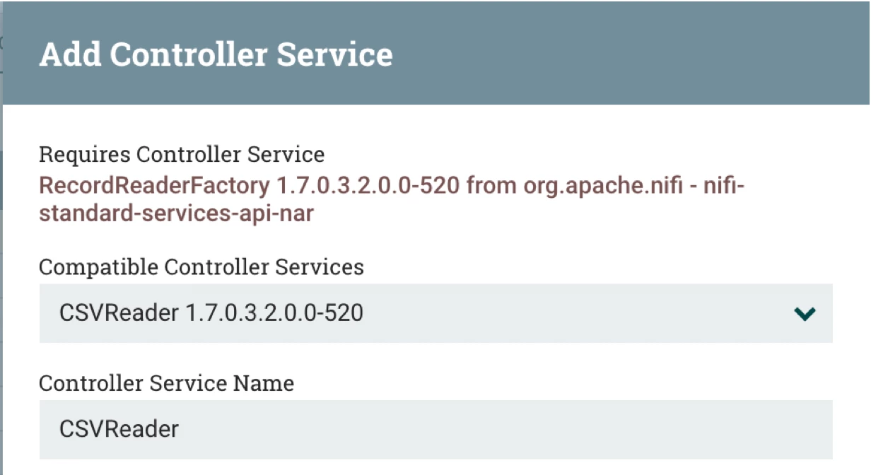

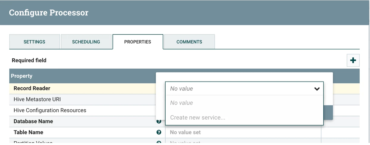

c. PutHive3Streaming – Here we need to configure the record reader. Right click on the processor > configure > Record reader > create new service.
d. Add CSV reader and save.
e. Click on the record reader again and then enable by clicking on middle sign on upper right-side corner.

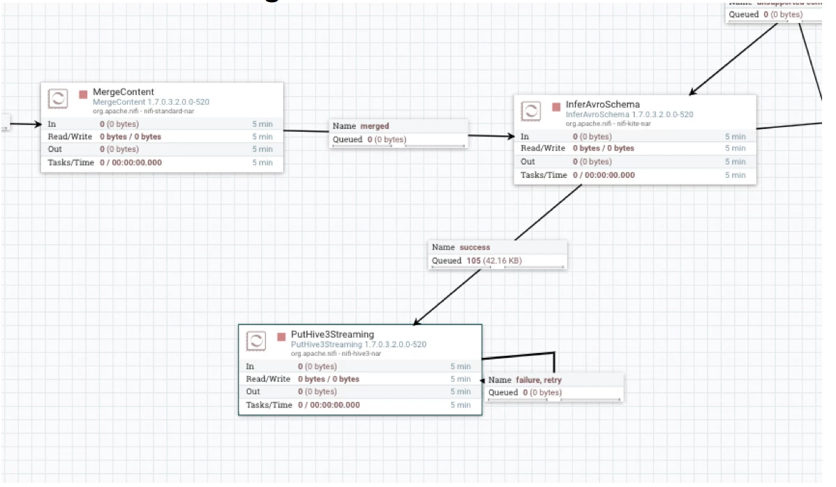

f. Connect all three processor and address the errors if any. For any configuration reference, you can try importing the attached workflow.
