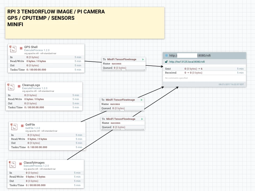

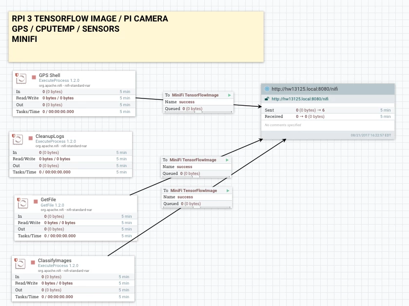

The MiniFi flow executes two scripts: one to call TensorFlow Python that captures an OpenCV Raspberry Pi Camera and runs Inception on it. That message is formatted as JSON and sent on. The second script reads GPS values from a USB GSP sensor and outputs JSON. Get File reads the Pi Camera image produced by the ClassifyImages process. Cleanup logs is a standalone timed script that cleans up old logs on the Raspberry Pi.

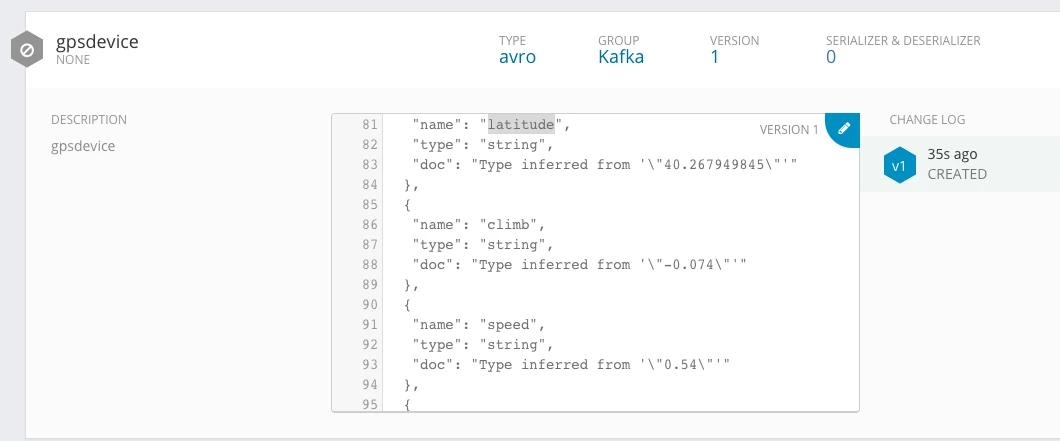

Using InferredAvroSchema I created a schema for the GPS unit and stored it in the Hortonworks Schema Registry.

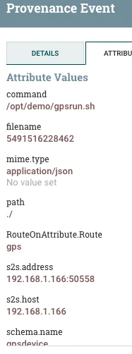

This is the provenance event for a typical GPS message sent. You can see what shell script we ran and from what host.

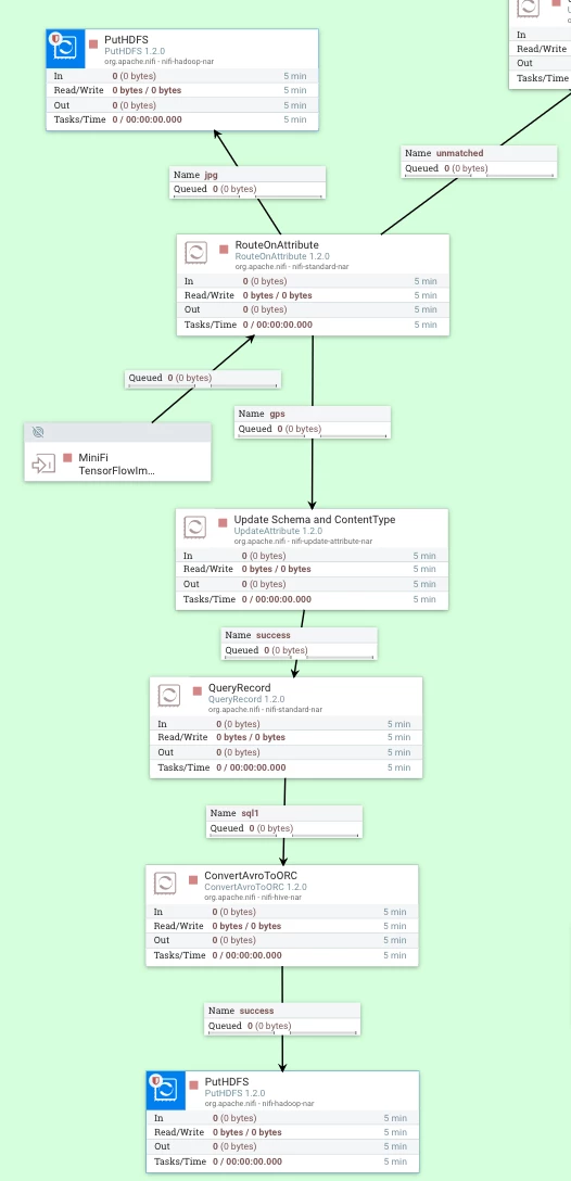

In Apache NiFi we process the message, routing to the correct place, setting a schema and querying it for a latitude. Then we convert the AVRO record to ORC to save as a Hive table.
MiniFi requires we change the NiFi created template to a configuration file via the command-line MiniFi Toolkit.
minifi-toolkit-0.2.0/bin/config.sh transform gpstensorflowpiminifi2.xml config.yml
scp config.yml pi@192.168.1.167:/opt/demo/minifi/conf/
./gpsrun.sh
