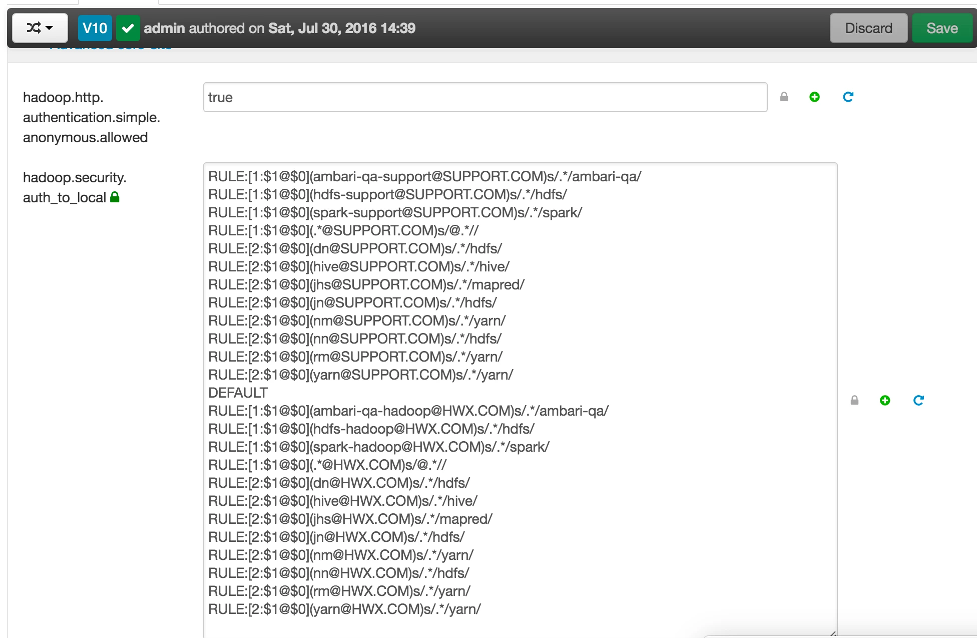

Step 6: Configure auth_to_local rules on both the clusters:
On Cluster1, append auth_to_local rules from Cluster2
Example on Cluster 1:
RULE:[1:$1@$0](ambari-qa-hadoop@HWX.COM)s/.*/ambari-qa/
RULE:[1:$1@$0](hdfs-hadoop@HWX.COM)s/.*/hdfs/
RULE:[1:$1@$0](spark-hadoop@HWX.COM)s/.*/spark/
RULE:[1:$1@$0](.*@HWX.COM)s/@.*//
RULE:[2:$1@$0](dn@HWX.COM)s/.*/hdfs/
RULE:[2:$1@$0](hive@HWX.COM)s/.*/hive/
RULE:[2:$1@$0](jhs@HWX.COM)s/.*/mapred/
RULE:[2:$1@$0](jn@HWX.COM)s/.*/hdfs/
RULE:[2:$1@$0](nm@HWX.COM)s/.*/yarn/
RULE:[2:$1@$0](nn@HWX.COM)s/.*/hdfs/
RULE:[2:$1@$0](rm@HWX.COM)s/.*/yarn/
RULE:[2:$1@$0](yarn@HWX.COM)s/.*/yarn/
DEFAULT
RULE:[1:$1@$0](ambari-qa-support@SUPPORT.COM)s/.*/ambari-qa/
RULE:[1:$1@$0](hdfs-support@SUPPORT.COM)s/.*/hdfs/
RULE:[1:$1@$0](spark-support@SUPPORT.COM)s/.*/spark/
RULE:[1:$1@$0](.*@SUPPORT.COM)s/@.*//
RULE:[2:$1@$0](dn@SUPPORT.COM)s/.*/hdfs/
RULE:[2:$1@$0](hive@SUPPORT.COM)s/.*/hive/
RULE:[2:$1@$0](jhs@SUPPORT.COM)s/.*/mapred/
RULE:[2:$1@$0](jn@SUPPORT.COM)s/.*/hdfs/
RULE:[2:$1@$0](nm@SUPPORT.COM)s/.*/yarn/
RULE:[2:$1@$0](nn@SUPPORT.COM)s/.*/hdfs/
RULE:[2:$1@$0](rm@SUPPORT.COM)s/.*/yarn/
RULE:[2:$1@$0](yarn@SUPPORT.COM)s/.*/yarn/
On Cluster2, append auth_to_local rules from Cluster1
Example on Cluster 2:
DEFAULT

@Kuldeep Kulkarni,
In the auth-to-local rule set examples, DEFAULT should be the last rule.
Also, this is a bit more than setting up the trust relationship between two MIT KDCs. It also includes some details about allowing two clusters to access each other's data. To do this, I believe that there are a few more steps. See https://community.hortonworks.com/articles/18686/kerberos-cross-realm-trust-for-distcp.html
Translate
KuldeepK
Gold ⭐️
KuldeepKAuthor
Gold ⭐️
Aug 12, 2016 12:17 PM UTC
@Robert Levas - DEFAULT at the middle worked when I tried this setup.
I checked given article and I agree that modifying dfs.namenode.kerberos.principal.pattern was somehow missed while writing this article. I will add that missing step now.
Thank you! 🙂
