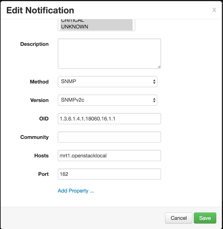

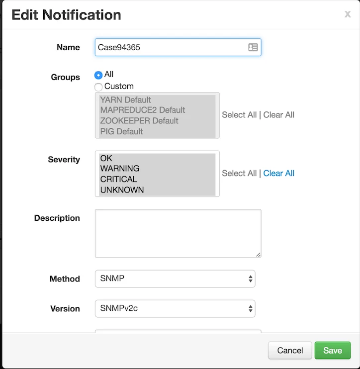

9) Below is the notification I setup on Ambari

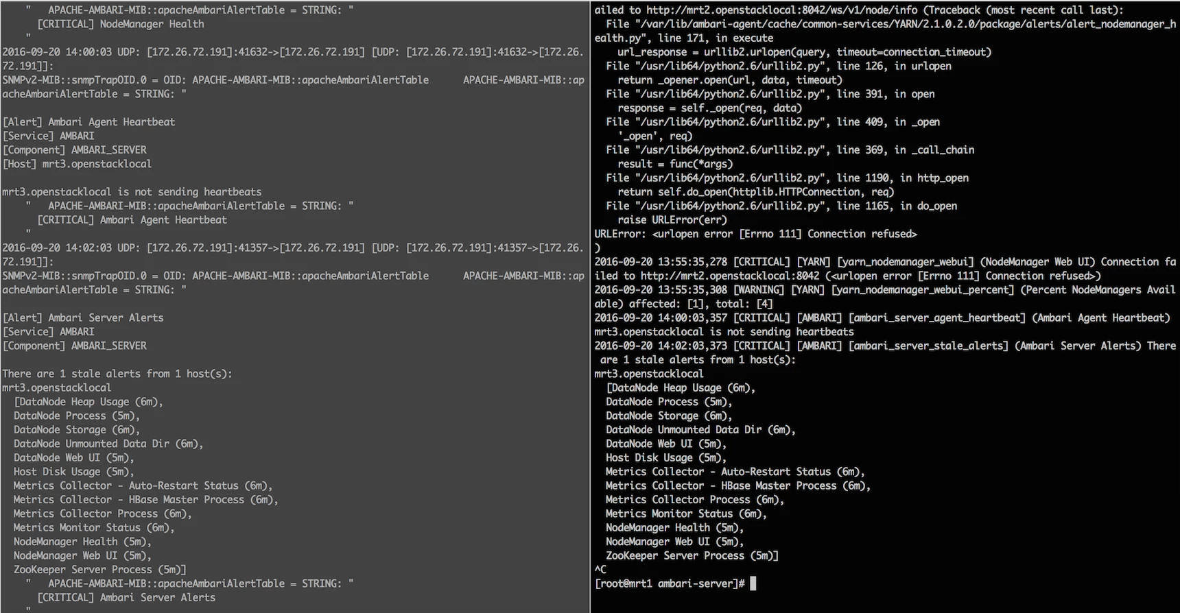

11) Test the alert by manually stopping a component, in this example yarn node manager and ambari-agent was stopped which showed up on both /var/log/ambari-server/ambari-alerts.log and also in /tmp/traps.log file. I have attached the screenshot of the snmp alert on the left side and ambari alert on the right side of the screen shot. Please note sometimes the alert might take a while to show up.
