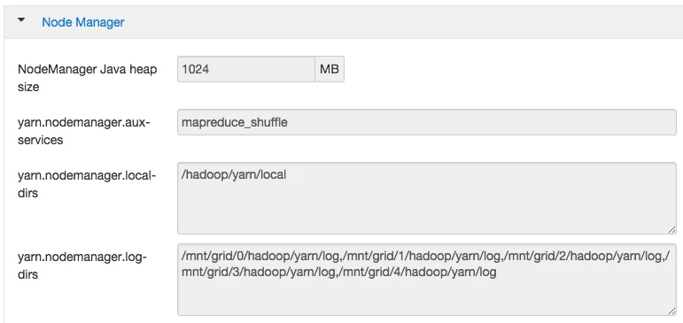

Check out where your yarn.nodemanager.local-dirs parameter is pointing to and increase disk space.

The problem was solved by setting the following parameters:
In file hadoop/conf/core-site.xml parameter hadoop.tmp.dir
In file hadoop/conf/tez-site.xml parameter tez.runtime.framework.local.dirs
In file hadoop/conf/yarn-site.xml parameter yarn.nodemanager.local-dirs
In file hadoop/conf/mapred-site.xml parameter mapreduce.cluster.local.dir
Set a valid directory with sufficient free space available and the query will execute.
