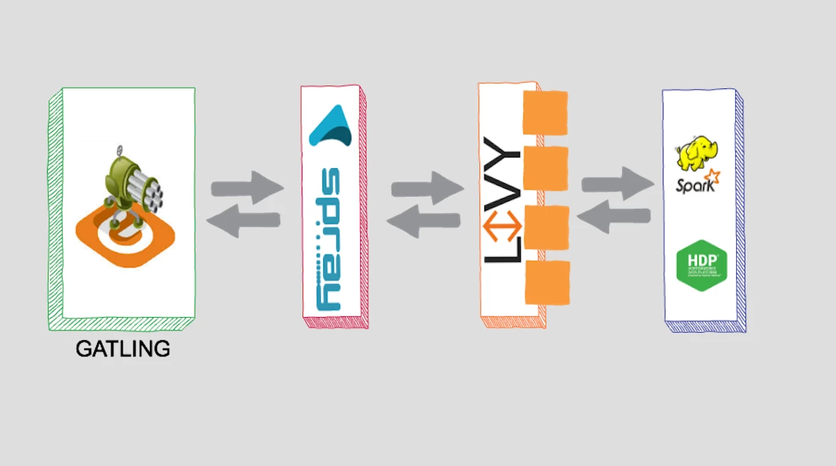

Spark Load testing framework built on a number of distributed technologies, including Gatling, Livy, Akka, and HDP. Using Akka Server powered by LIVY {Spark as a Service} provides the following benefits.

Livy Server
Livy is an open source REST interface for interacting with Apache Spark from anywhere. It supports executing snippets of code or programs in a Spark context that runs locally or in Apache Hadoop YARN.

Gatling Server
Gatling is a highly capable load testing tool. It is designed for ease of use, maintainability and high performance. Gatling server provides the following benefits.
