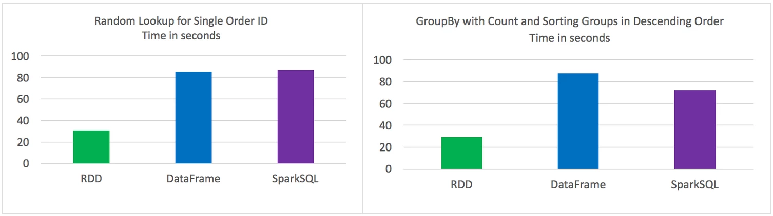

Test results:
  • RDD’s outperformed DataFrames and SparkSQL for certain types of data processing
  • DataFrames and SparkSQL performed almost about the same, although with analysis involving aggregation and sorting SparkSQL had a slight advantage
  • Syntactically speaking, DataFrames and SparkSQL are much more intuitive than using RDD’s
  • Took the best out of 3 for each test
  • Times were consistent and not much variation between tests
  • Jobs were run individually with no other jobs running

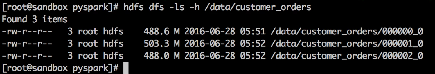

Source data files in HDFS:

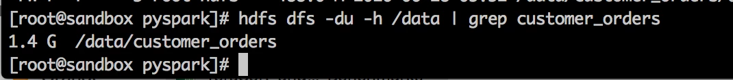

Total size of source data files in HDFS:

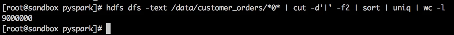

Order ID is second field in pipe delimited file. There are 9 Million unique order ID records:

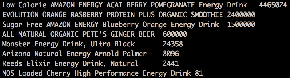

Output produced by GroupBy, Count, and Sort Descending (format will not be same for all, however, numbers will be same):
