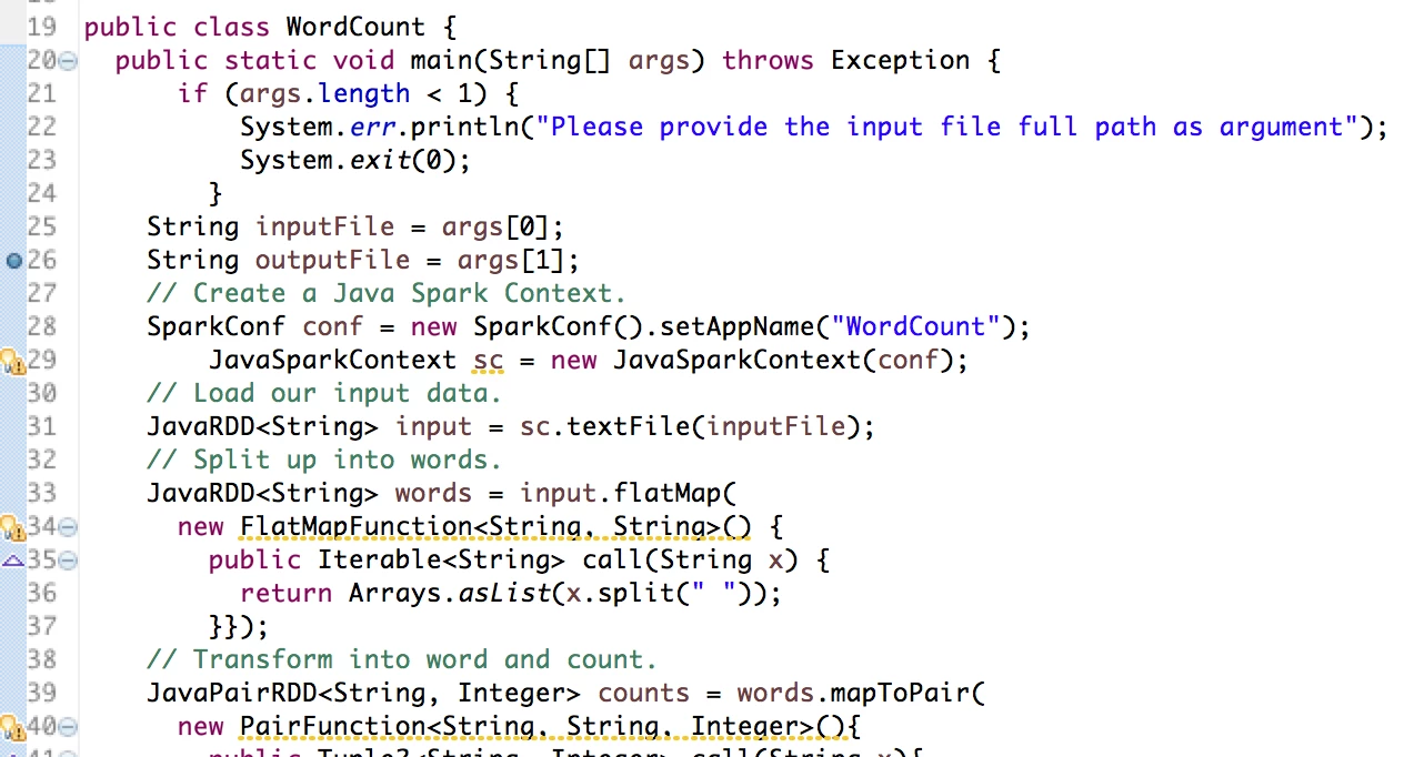

First we will use a very standard wordcount example you can get in all the spark tutorials. Set up a quick maven project to bundle your jar and dependent libs you might be using. Notice the breakpoint on the 26th line, it will make sense later on.

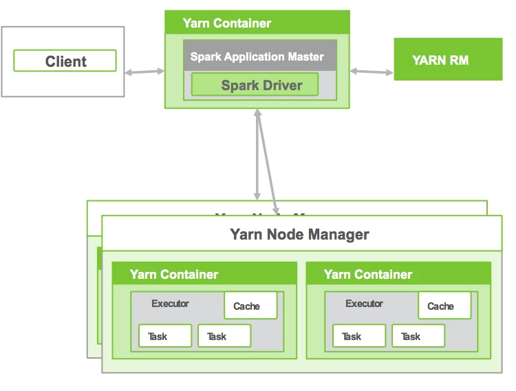

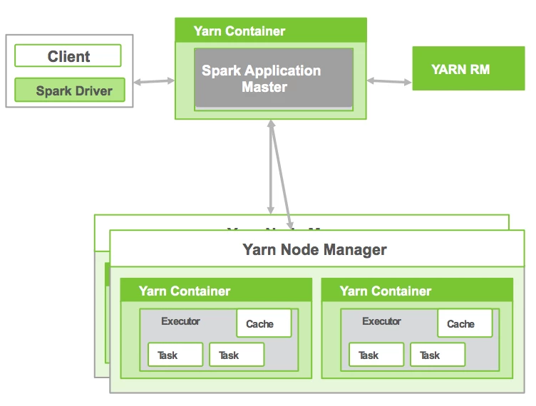

Spark has three modes Standalone,Yarn,Mesos. Most examples talk about standalone so I will focus on Yarn. In yarn every application has an application master process where the first container for the application is started, it responsible for requesting ressources for the application and driving the application as a whole.
For spark this means you get to choose if the yarn application master runs the whole application and hence the spark driver or if your client is active and keeps the spark driver.
1870-capture-decran-2016-02-06-a-171353.png 1881-capture-decran-2016-02-06-a-171401.png

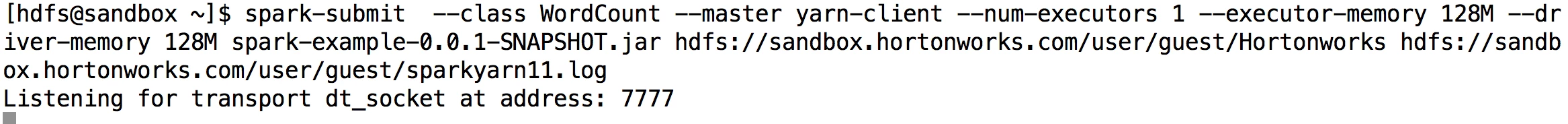

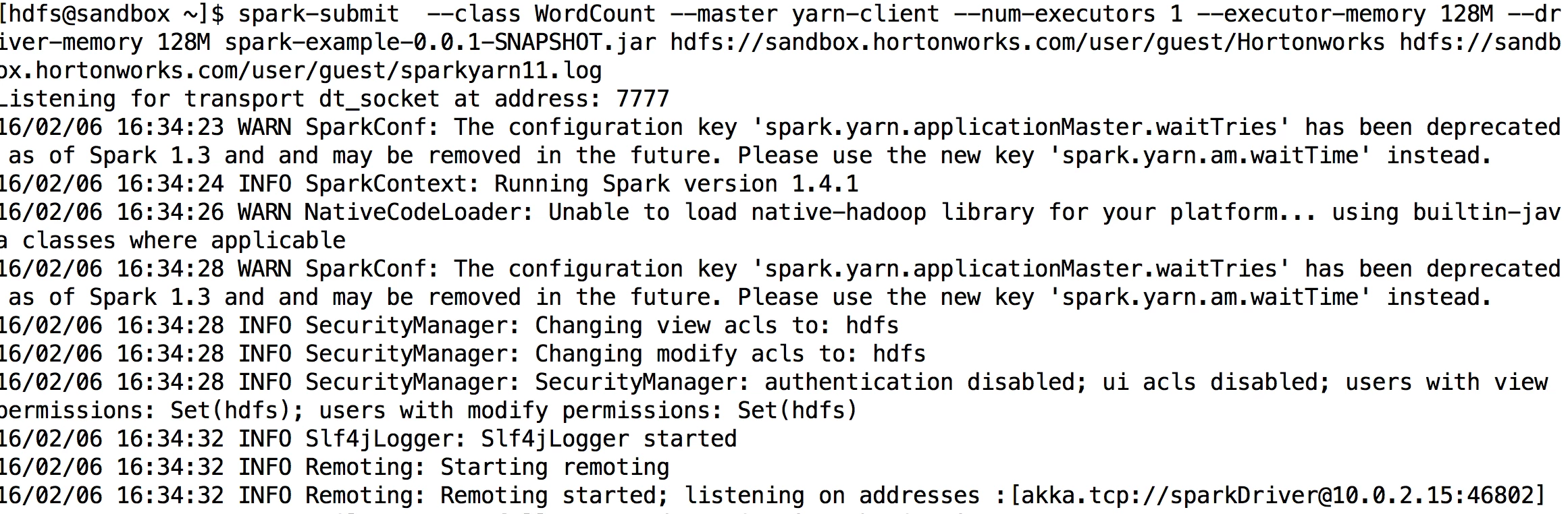

Notice address=7777, back to my port I talked about earlier and suspend=y to have the process wait for my IDE to bind. let’s now launch our normal spark submit command
If we look at the line a little bit closer I have specified low memory settings for my specific sandbox context and given an input file Hortonworks and an outputfile sparkyarn11.log. Notice we are using here the –master yarn-client deployment mode. As the prompt shows us the system is now waiting on port 7777 for the IDE to bind.

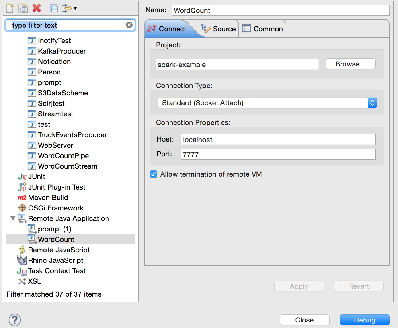

Now back in our IDE we will use the remote debug function to bind to our spark cluster.

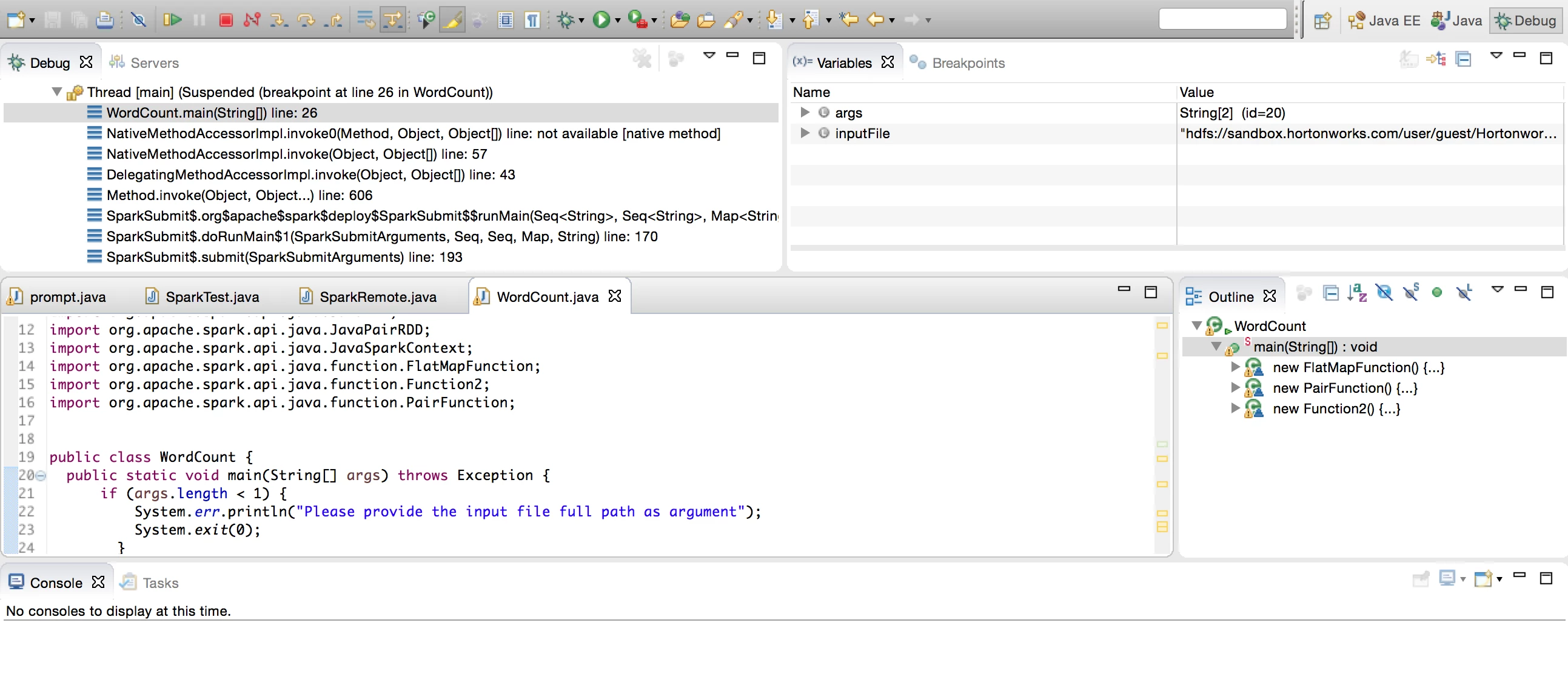

Once you run debug the prompt on your cluster will start showing your IDE bind and you can now run your work from Eclipse directly
Back in Eclipse you will be prompted to the debug view and you can go ahead and skip from breakpoint to breakpoint. Remember the breakpoint I pointed out in the code. Your IDE is on this breakpoint waiting to move one. On the right variable panel you can see the file input variable we get from the command line, it is set tohdfs://sandbox.hortonworks.com/user/guest/Hortonworks exactly like our command line input.
