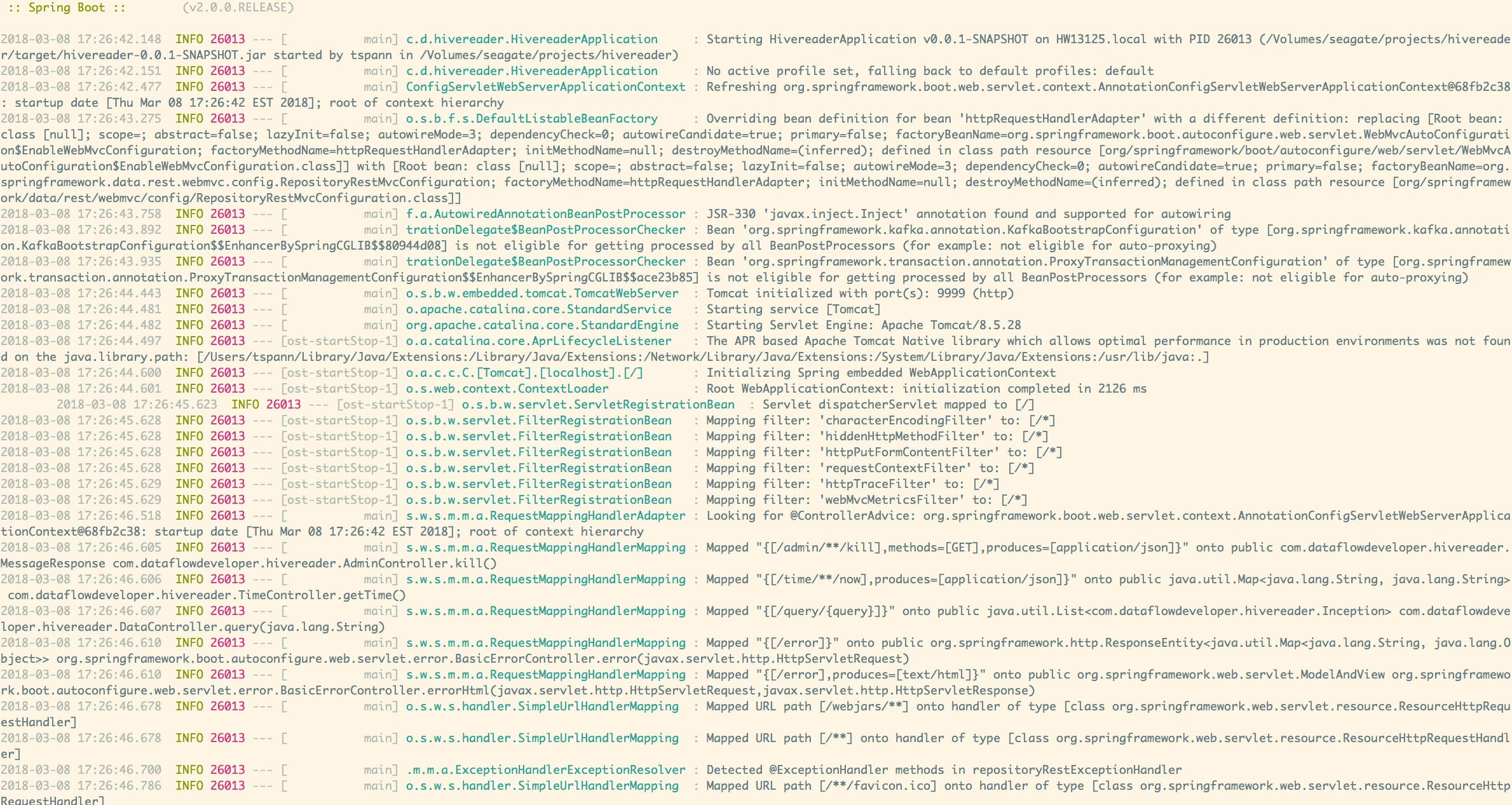

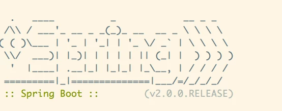

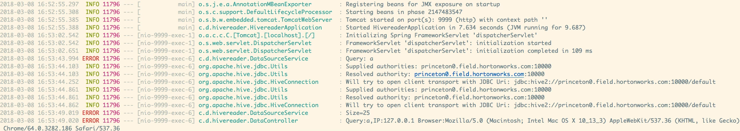

Running the Spring Boot Microservices JAR

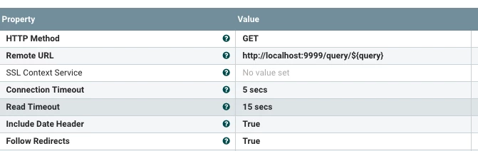

Let's Call the Spring Boot 2.0 REST API

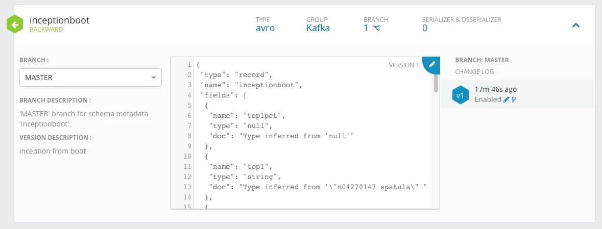

Let's build a schema for this data

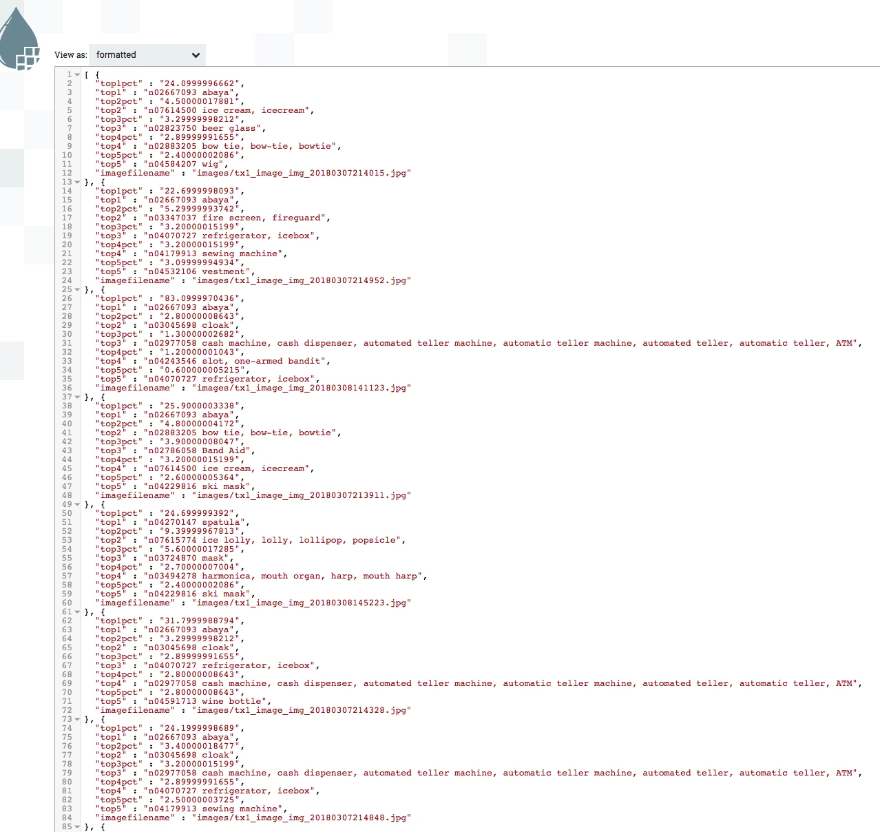

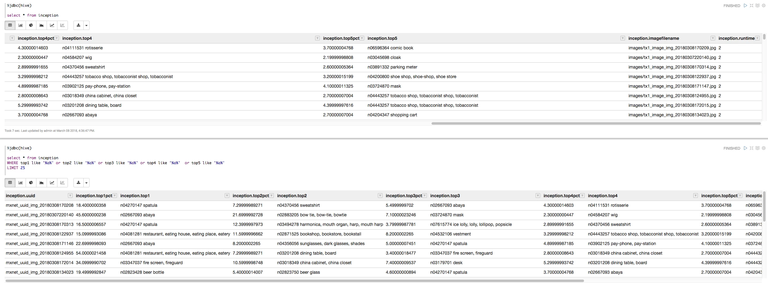

Let's examine the data in Apache Zeppelin

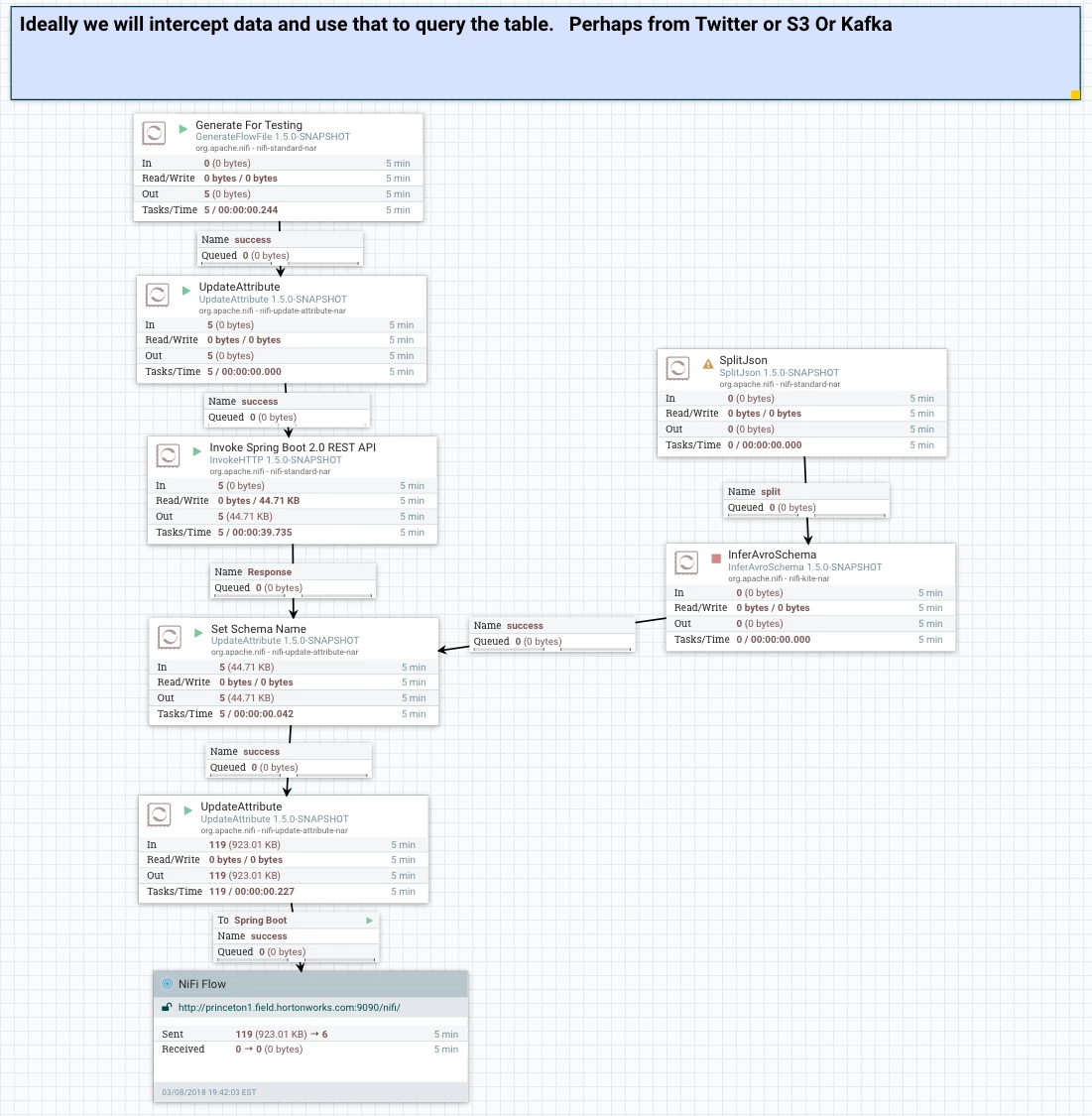

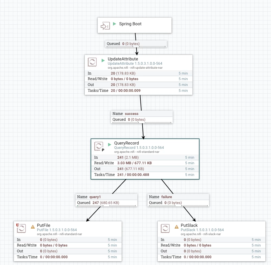

The Main Apache NiFi Flow to Ingest the Spring Boot REST API

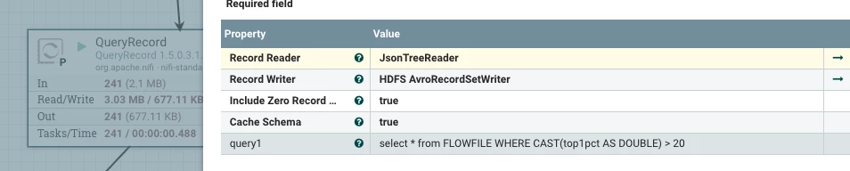

Let's use the QueryRecord Processor to Query our Records and only look at ones with a good Top 1 Percent.

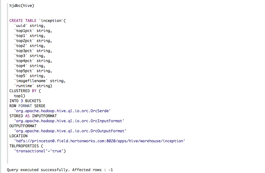

Let's Create a Table on ACID!!!!

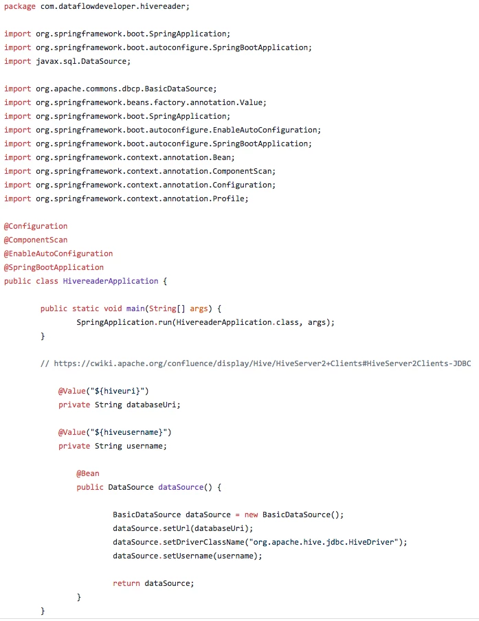

HivereaderApplication
We need a class to setup the Hive datasource and initial the Spring Application. This is the only boiler plate and it's pretty minimal. Great job Spring people!

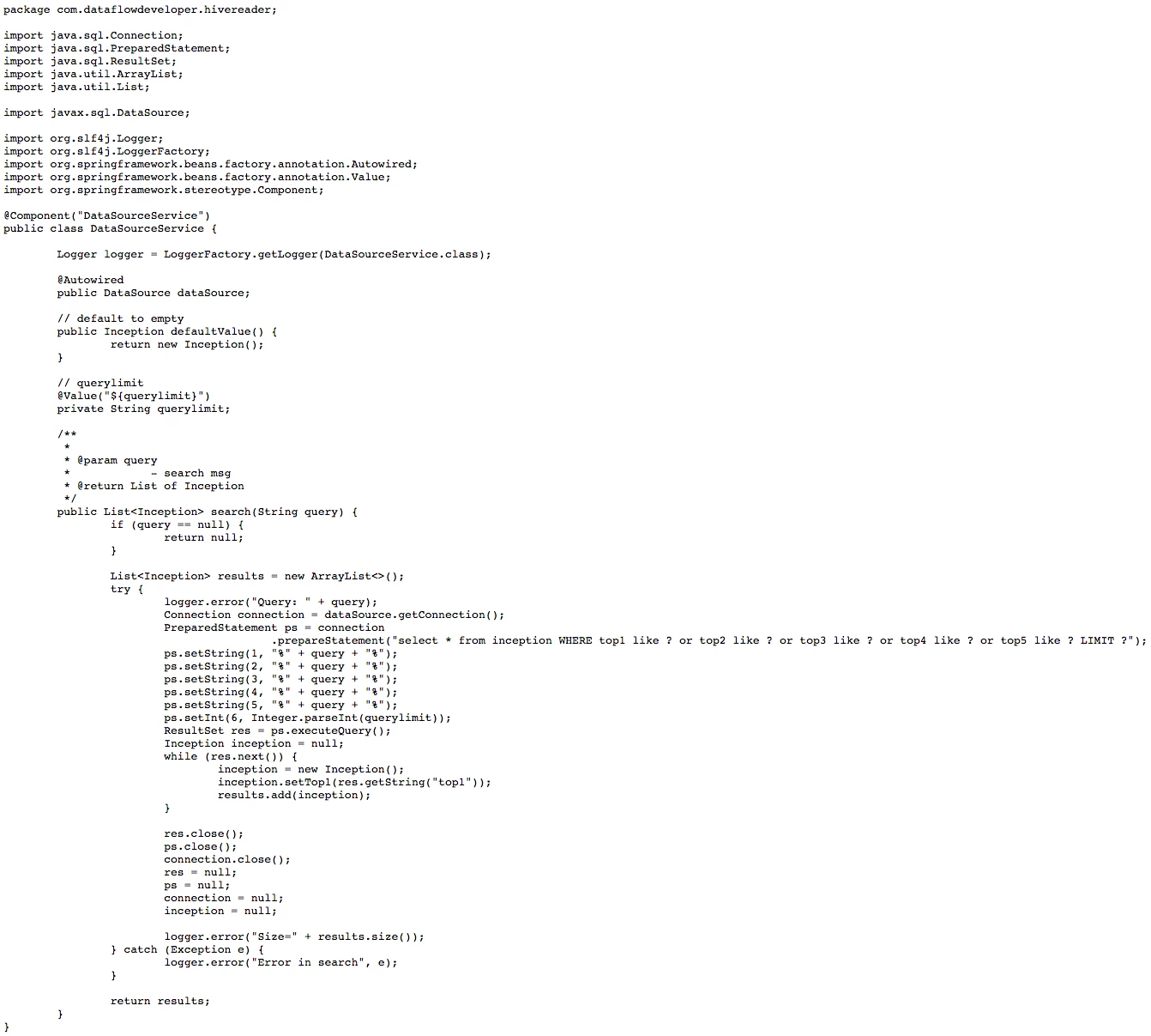

DataSourceService
Get the datasource, the limit to the query and then our one search method. It takes a query parameter received from the REST API and sets that in a few places to query all of our text results and adds the limit. We add that to our handy object and put it in a list. There are tons of helpers and short cuts to make this easier, but this works for me. Close everything up and return this list. Spring Boot returns this as a JSON array of clean data. This is very easy to work with in Apache NiFi. This makes for a nice combination.

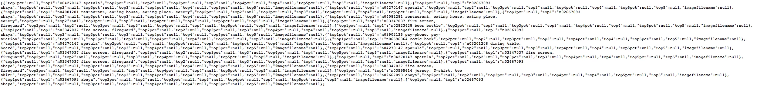

Running the Raw REST API
http://localhost:9999/time/now
{"time":"1520548296121"}
http://localhost:9999/query/ice
[{"top1pct":"16.5000006557","top1":"n04270147 spatula","top2pct":"12.3999997973","top2":"n03494278 harmonica, mouth organ, harp, mouth harp","top3pct":"3.79999987781","top3":"n07615774 ice lolly, lolly, lollipop, popsicle","top4pct":"2.89999991655","top4":"n04370456 sweatshirt","top5pct":"2.60000005364","top5":"n03891332 parking meter","imagefilename":"images/tx1_image_img_20180308170314.jpg"},{"top1pct":"8.50000008941","top1":"n04270147 spatula","top2pct":"6.80000036955","top2":"n02823428 beer bottle","top3pct":"4.50000017881","top3":"n03902125 pay-phone, pay-station","top4pct":"3.90000008047","top4":"n07614500 ice cream, icecream","top5pct":"3.59999984503","top5":"n03657121 lens cap, lens cover","imagefilename":"images/tx1_image_img_20180308170832.jpg"},{"top1pct":"11.2000003457","top1":"n04270147 spatula","top2pct":"5.20000010729","top2":"n03814639 neck brace","top3pct":"4.69999983907","top3":"n07615774 ice lolly, lolly, lollipop, popsicle","top4pct":"4.10000011325","top4":"n03494278 harmonica, mouth organ, harp, mouth harp","top5pct":"3.79999987781","top5":"n02823428 beer bottle","imagefilename":"images/tx1_image_img_20180308165958.jpg"},{"top1pct":"8.90000015497","top1":"n02823428 beer bottle","top2pct":"5.70000000298","top2":"n03902125 pay-phone, pay-station","top3pct":"5.20000010729","top3":"n04525305 vending machine","top4pct":"4.30000014603","top4":"n04200800 shoe shop, shoe-shop, shoe store","top5pct":"4.30000014603","top5":"n07614500 ice cream, icecream","imagefilename":"images/tx1_image_img_20180308171043.jpg"},{"top1pct":"14.8000001907","top1":"n04270147 spatula","top2pct":"7.50000029802","top2":"n04579432 whistle","top3pct":"4.80000004172","top3":"n07614500 ice cream, icecream","top4pct":"4.60000000894","top4":"n02883205 bow tie, bow-tie, bowtie","top5pct":"4.50000017881","top5":"n03494278 harmonica, mouth organ, harp, mouth harp","imagefilename":"images/tx1_image_img_20180308173619.jpg"},{"top1pct":"16.5999993682","top1":"n04111531 rotisserie","top2pct":"8.69999974966","top2":"n04270147 spatula","top3pct":"3.59999984503","top3":"n07614500 ice cream, icecream","top4pct":"3.5000000149","top4":"n03666591 lighter, light, igniter, ignitor","top5pct":"2.70000007004","top5":"n03902125 pay-phone, pay-station","imagefilename":"images/tx1_image_img_20180308152145.jpg"},{"top1pct":"24.0999996662","top1":"n02667093 abaya","top2pct":"4.50000017881","top2":"n07614500 ice cream, icecream","top3pct":"3.29999998212","top3":"n02823750 beer glass","top4pct":"2.89999991655","top4":"n02883205 bow tie, bow-tie, bowtie","top5pct":"2.40000002086","top5":"n04584207 wig","imagefilename":"images/tx1_image_img_20180307214015.jpg"},{"top1pct":"6.40000030398","top1":"n04370456 sweatshirt","top2pct":"5.4999999702","top2":"n07614500 ice cream, icecream","top3pct":"5.40000014007","top3":"n04229816 ski mask","top4pct":"4.69999983907","top4":"n03724870 mask","top5pct":"4.39999997616","top5":"n04270147 spatula","imagefilename":"images/tx1_image_img_20180308151828.jpg"},{"top1pct":"8.60000029206","top1":"n04579432 whistle","top2pct":"6.19999989867","top2":"n04270147 spatula","top3pct":"5.99999986589","top3":"n07614500 ice cream, icecream","top4pct":"5.99999986589","top4":"n03494278 harmonica, mouth organ, harp, mouth harp","top5pct":"5.90000003576","top5":"n07880968 burrito","imagefilename":"images/tx1_image_img_20180308151620.jpg"},{"top1pct":"22.6999998093","top1":"n02667093 abaya","top2pct":"5.29999993742","top2":"n03347037 fire screen, fireguard","top3pct":"3.20000015199","top3":"n04070727 refrigerator, icebox","top4pct":"3.20000015199","top4":"n04179913 sewing machine","top5pct":"3.09999994934","top5":"n04532106 vestment","imagefilename":"images/tx1_image_img_20180307214952.jpg"},{"top1pct":"7.99999982119","top1":"n02667093 abaya","top2pct":"5.60000017285","top2":"n02823428 beer bottle","top3pct":"3.59999984503","top3":"n07614500 ice cream, icecream","top4pct":"3.09999994934","top4":"n02883205 bow tie, bow-tie, bowtie","top5pct":"3.09999994934","top5":"n04584207 wig","imagefilename":"images/tx1_image_img_20180307213659.jpg"},{"top1pct":"83.0999970436","top1":"n02667093 abaya","top2pct":"2.80000008643","top2":"n03045698 cloak","top3pct":"1.30000002682","top3":"n02977058 cash machine, cash dispenser, automated teller machine, automatic teller machine, automated teller, automatic teller, ATM","top4pct":"1.20000001043","top4":"n04243546 slot, one-armed bandit","top5pct":"0.600000005215","top5":"n04070727 refrigerator, icebox","imagefilename":"images/tx1_image_img_20180308141123.jpg"},{"top1pct":"9.00000035763","top1":"n07614500 ice cream, icecream","top2pct":"7.69999995828","top2":"n04376876 syringe","top3pct":"5.79999983311","top3":"n04270147 spatula","top4pct":"3.20000015199","top4":"n07880968 burrito","top5pct":"2.89999991655","top5":"n07695742 pretzel","imagefilename":"images/tx1_image_img_20180307213805.jpg"},{"top1pct":"25.9000003338","top1":"n02667093 abaya","top2pct":"4.80000004172","top2":"n02883205 bow tie, bow-tie, bowtie","top3pct":"3.90000008047","top3":"n02786058 Band Aid","top4pct":"3.20000015199","top4":"n07614500 ice cream, icecream","top5pct":"2.60000005364","top5":"n04229816 ski mask","imagefilename":"images/tx1_image_img_20180307213911.jpg"},{"top1pct":"9.20000001788","top1":"n02786058 Band Aid","top2pct":"7.59999975562","top2":"n04229816 ski mask","top3pct":"5.79999983311","top3":"n02883205 bow tie, bow-tie, bowtie","top4pct":"5.70000000298","top4":"n04370456 sweatshirt","top5pct":"4.69999983907","top5":"n07614500 ice cream, icecream","imagefilename":"images/tx1_image_img_20180308163321.jpg"},{"top1pct":"9.7000002861","top1":"n04270147 spatula","top2pct":"5.40000014007","top2":"n02786058 Band Aid","top3pct":"4.80000004172","top3":"n04356056 sunglasses, dark glasses, shades","top4pct":"4.39999997616","top4":"n03250847 drumstick","top5pct":"3.79999987781","top5":"n07615774 ice lolly, lolly, lollipop, popsicle","imagefilename":"images/tx1_image_img_20180308161932.jpg"},{"top1pct":"5.60000017285","top1":"n07614500 ice cream, icecream","top2pct":"5.00000007451","top2":"n02786058 Band Aid","top3pct":"3.5000000149","top3":"n04270147 spatula","top4pct":"3.40000018477","top4":"n01984695 spiny lobster, langouste, rock lobster, crawfish, crayfish, sea crawfish","top5pct":"3.20000015199","top5":"n02992529 cellular telephone, cellular phone, cellphone, cell, mobile phone","imagefilename":"images/tx1_image_img_20180308142106.jpg"},{"top1pct":"6.10000006855","top1":"n04270147 spatula","top2pct":"5.90000003576","top2":"n03250847 drumstick","top3pct":"3.40000018477","top3":"n02883205 bow tie, bow-tie, bowtie","top4pct":"3.29999998212","top4":"n03249569 drum, membranophone, tympan","top5pct":"3.09999994934","top5":"n07614500 ice cream, icecream","imagefilename":"images/tx1_image_img_20180308162554.jpg"},{"top1pct":"13.0999997258","top1":"n02787622 banjo","top2pct":"8.60000029206","top2":"n03447721 gong, tam-tam","top3pct":"5.79999983311","top3":"n03250847 drumstick","top4pct":"3.70000004768","top4":"n07614500 ice cream, icecream","top5pct":"3.59999984503","top5":"n07695742 pretzel","imagefilename":"images/tx1_image_img_20180308141540.jpg"},{"top1pct":"24.699999392","top1":"n04270147 spatula","top2pct":"9.39999967813","top2":"n07615774 ice lolly, lolly, lollipop, popsicle","top3pct":"5.60000017285","top3":"n03724870 mask","top4pct":"2.70000007004","top4":"n03494278 harmonica, mouth organ, harp, mouth harp","top5pct":"2.40000002086","top5":"n04229816 ski mask","imagefilename":"images/tx1_image_img_20180308145223.jpg"},{"top1pct":"15.5000001192","top1":"n02667093 abaya","top2pct":"5.40000014007","top2":"n01985128 crayfish, crawfish, crawdad, crawdaddy","top3pct":"4.60000000894","top3":"n07614500 ice cream, icecream","top4pct":"4.50000017881","top4":"n03980874 poncho","top5pct":"3.79999987781","top5":"n03720891 maraca","imagefilename":"images/tx1_image_img_20180307213449.jpg"},{"top1pct":"31.7999988794","top1":"n02667093 abaya","top2pct":"3.29999998212","top2":"n03045698 cloak","top3pct":"2.89999991655","top3":"n04070727 refrigerator, icebox","top4pct":"2.80000008643","top4":"n02977058 cash machine, cash dispenser, automated teller machine, automatic teller machine, automated teller, automatic teller, ATM","top5pct":"2.80000008643","top5":"n04591713 wine bottle","imagefilename":"images/tx1_image_img_20180307214328.jpg"},{"top1pct":"24.1999998689","top1":"n02667093 abaya","top2pct":"3.40000018477","top2":"n03045698 cloak","top3pct":"3.20000015199","top3":"n02977058 cash machine, cash dispenser, automated teller machine, automatic teller machine, automated teller, automatic teller, ATM","top4pct":"2.89999991655","top4":"n04070727 refrigerator, icebox","top5pct":"2.50000003725","top5":"n04179913 sewing machine","imagefilename":"images/tx1_image_img_20180307214848.jpg"},{"top1pct":"23.1000006199","top1":"n03721384 marimba, xylophone","top2pct":"5.40000014007","top2":"n04370456 sweatshirt","top3pct":"4.89999987185","top3":"n01704323 triceratops","top4pct":"3.29999998212","top4":"n03980874 poncho","top5pct":"2.80000008643","top5":"n03944341 pinwheel","imagefilename":"images/tx1_image_img_20180308152459.jpg"}]
