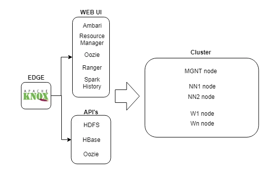

This article will explain how to setup a static edge node as an entry point to a Hadoop cluster deployed using Cloudbreak.
This setup it's not supported by default, because it's not possible to join external vm's in a cluster deployed with Cloudbreak, but in the next article you will find the steps in order to do it.
Cloudbreak is a manager/operator tool to deploy clusters that provides some extra features like scaling, start/stop resources etc in a simple UI. It's a good tool that is growing and sometimes could be a bit rigid and for some core changes on the cluster you will need to deploy a new cluster, for example to change the type of VM or change the HDP version etc.
For this reason in our case we decided to setup a static IaaS virtual machine as edge node, that give us a single and immutable entry point to the cluster, this will never change even we will deploy a new cluster. With this and Knox server we have the ability to deploy a new cluster and then make the switch without deliver again the new URL's and API's to the users.
We will divide the article in three parts:
  1. How to join the edge node in the cluster
  2. How to install Knox server in the edge node
  3. How to add the hostname resolution in the edge node

Install Knox on the edge node
We will need a Knox server running in the edge node in order to redirect the UI's and API's from the edge to the current cluster.
To setup Knox follow the next steps using Ambari:
  1. Go to Ambari UI and then add Knox server on the edge node.
  2. Configure the topology files to point to the cluster services. Suggestion, copy the default topology under "/etc/knox/2.6.5.0-292/0/topologies/" and rename it with your topology file and fill the correct url's.
  3. Enable the LDAP cache to speed up the connections.
  4. In case that you have HTTPS enabled on Ambari Server you will need to install the certificate from Ambari server on the java keystore in the edge node; this is required for the handshake between the edge node and Ambari server.

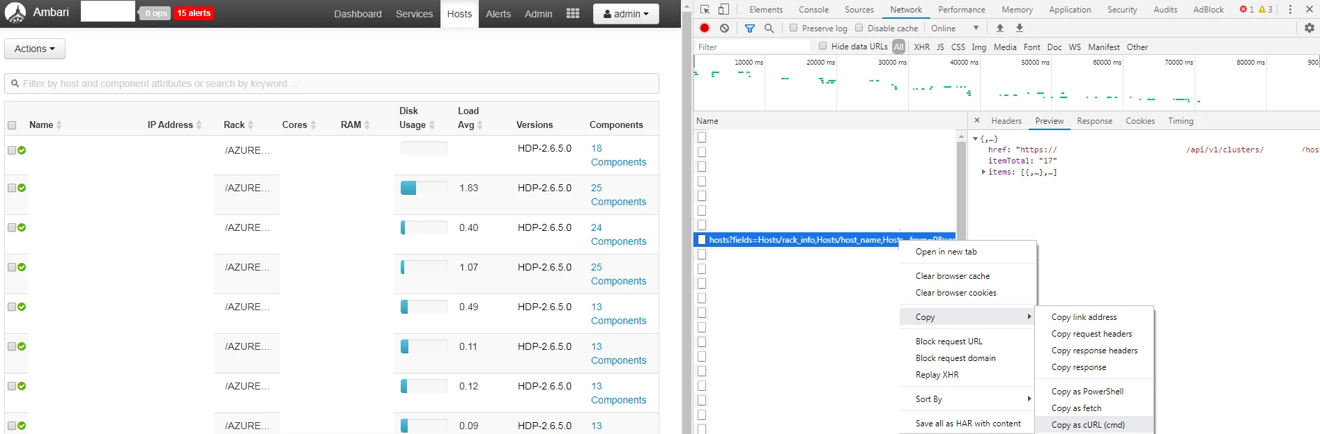

From Ambari UI and hosts tab we can take the API call to list the servers:
This is the full curl:
curl "https://edgeFQDN:8080/api/v1/clusters/clustername/hosts?fields=Hosts/rack_info,Hosts/host_name,Hosts/maintenance_state,Hosts/public_host_name,Hosts/cpu_count,Hosts/ph_cpu_count,Hosts/last_agent_env,alerts_summary,Hosts/host_status,Hosts/last_heartbeat_time,Hosts/ip,host_components/HostRoles/state,host_components/HostRoles/maintenance_state,host_components/HostRoles/stale_configs,host_components/HostRoles/service_name,host_components/HostRoles/display_name,host_components/HostRoles/desired_admin_state,metrics/disk,metrics/load/load_one,Hosts/total_mem,stack_versions/HostStackVersions,stack_versions/repository_versions/RepositoryVersions/repository_version,stack_versions/repository_versions/RepositoryVersions/id,stack_versions/repository_versions/RepositoryVersions/display_name^&minimal_response=true,host_components/logging"
We just want the hostname and IP.
https://edgeFQDN:8443/gatewayPath/gateway/ambari/api/v1/clusters/clustername/hosts?fields=Hosts/host_name,Hosts/ip
With this curl and some transformations we will fix the issue.
