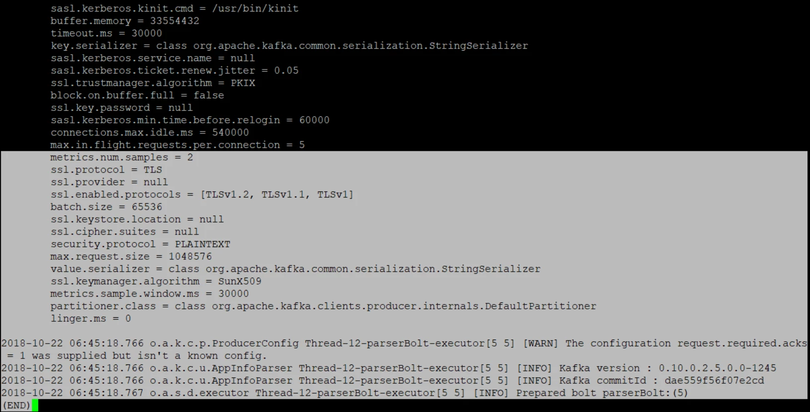

I am new to HCP and Storm, I am running though the squid use case. From Kafka console consumer, my kafka is receiving data, and from metron UI, my squid sensor is running but throughput is 0kb/s, from Storm UI squid topology is active and 1 worker 5 executors, but data not coming in to the topology. The logs in storm/workers-artifacts for worker.log.err is empty, for worker.log it stopped below image.
