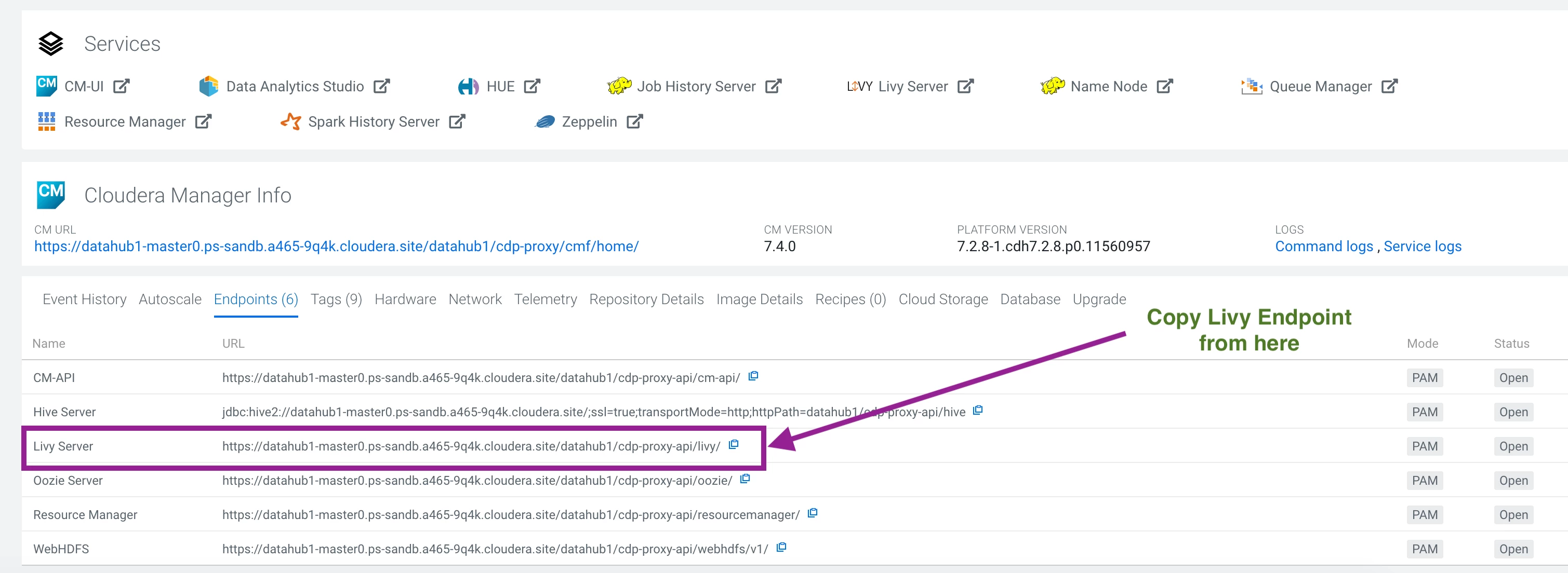

  1. Get the Livy endpoint for Data hub from the CDP control plane

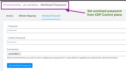

  2. Ensure that you have the workload password set for the environment
