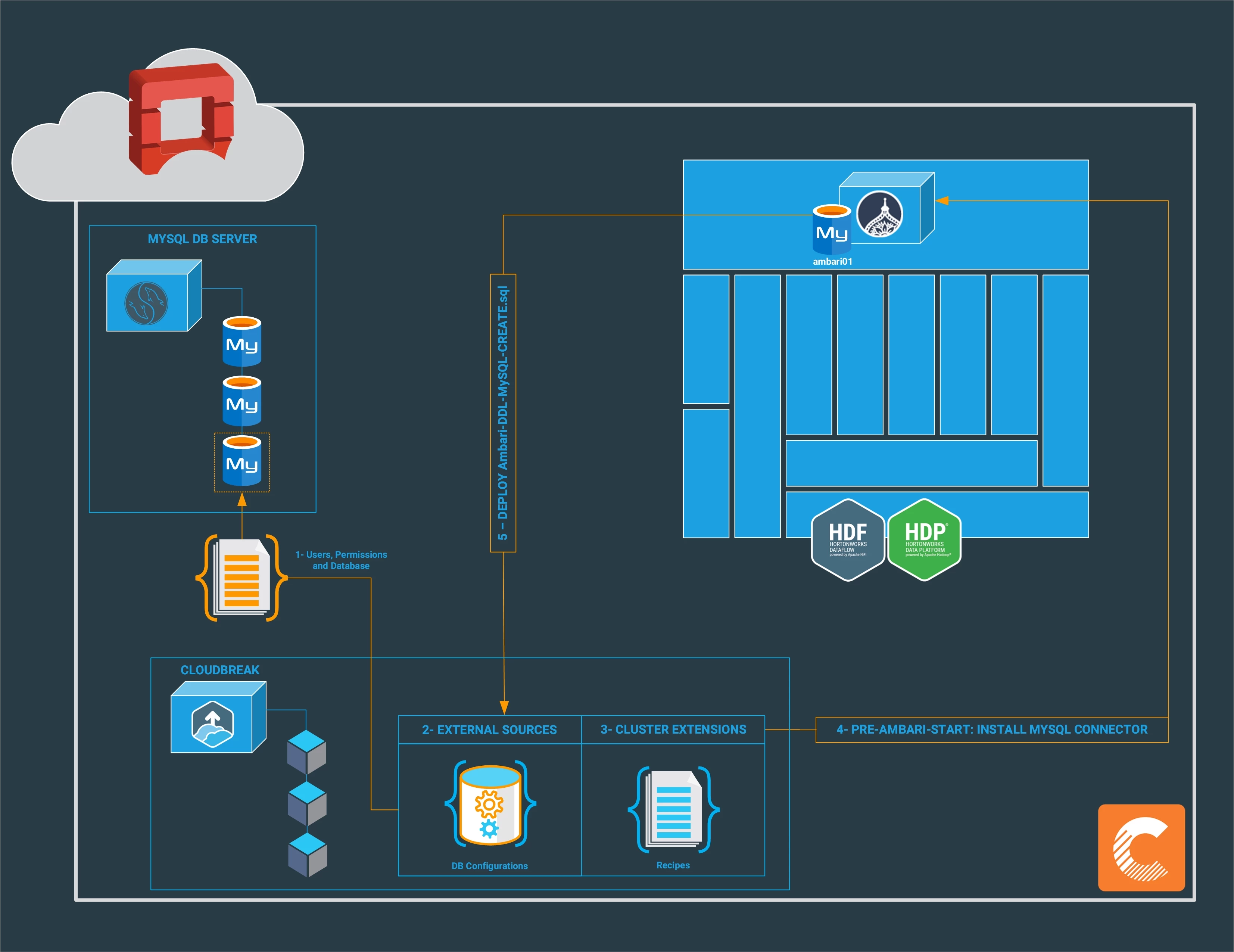

From Ambari 2.6, for all MYSQL_SERVER components in a blueprint, the mysql-connector-java.jar needs to be manually installed and registered. This video describes how to install and register MySQL connector to replace the embedded database instance that is by default used by Ambari Server.
For certain services, Cloudbreak allows registering an existing RDBMS instance as an external source for a database. After registering the RDBMS with Cloudbreak, it can be used for multiple clusters. However, as this configuration needs to be used by Ambari before its installation, MySQL Connector needs to be connected the remote MySQL database.

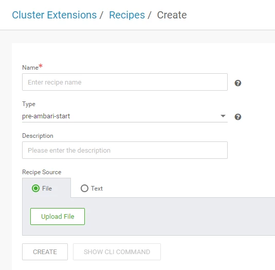

  1. Create a pre-ambari-start recipe to install the mysql-connector-java.jar:
    #!/bin/bash # Provide the JDBC Connector JAR file.
    # During cluster creation, Cloudbreak uses /opts/jdbc-drivers directory
    for the JAR file yum -y localinstall
    https://dev.mysql.com/get/mysql57-community-release-el7-8.noarch.rpm yum -y
    install mysql-connector-java* if [[ ! -d /opt/jdbc-drivers ]]
    then mkdir /opt/jdbc-drivers cp /usr/share/java/mysql-connector-java.jar
    /opt/jdbc-drivers/mysql-connector-java.jar fi

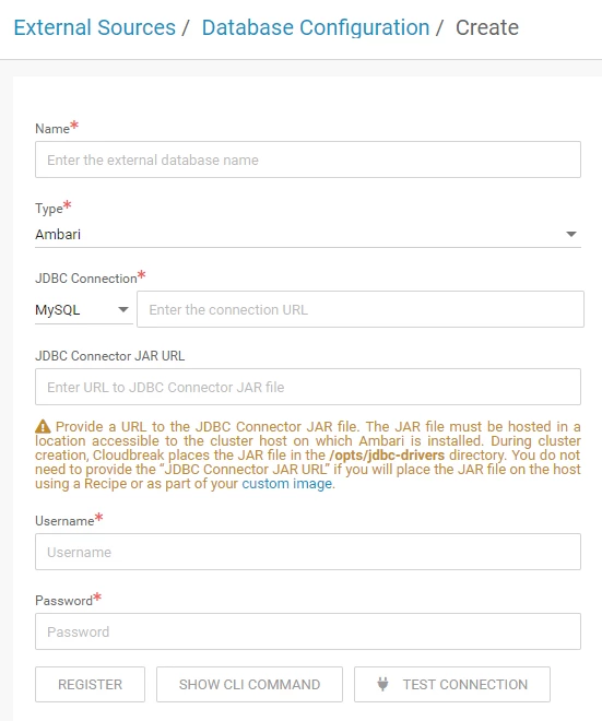

  2. Register the database configuration: Database:
    MySQL MySQL Server: MySQL_DB_IP/FQDN MySQL User:
    ambari MySQL Password: Hadoop1234! JDBC Connector JAR URL:
    Empty JDBC Connection jdbc:mysql://MySQL_DB_IP/FQDN:Port/ambari01
