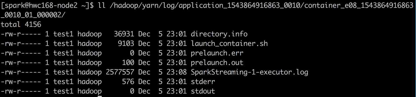

After running the Spark streaming application, the following information will be listed in NodeManager nodes where an executor is launched:

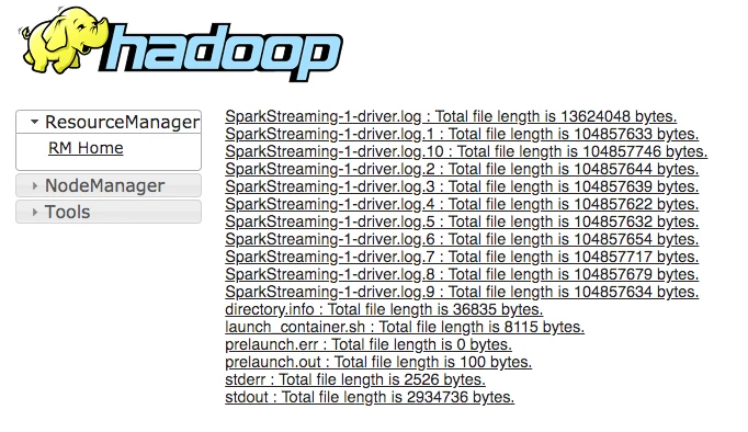

This way it's easier to find and collect the necessary executor logs. Also, from the Resource Manager UI, the current log and any previous (backup) file will be listed:
