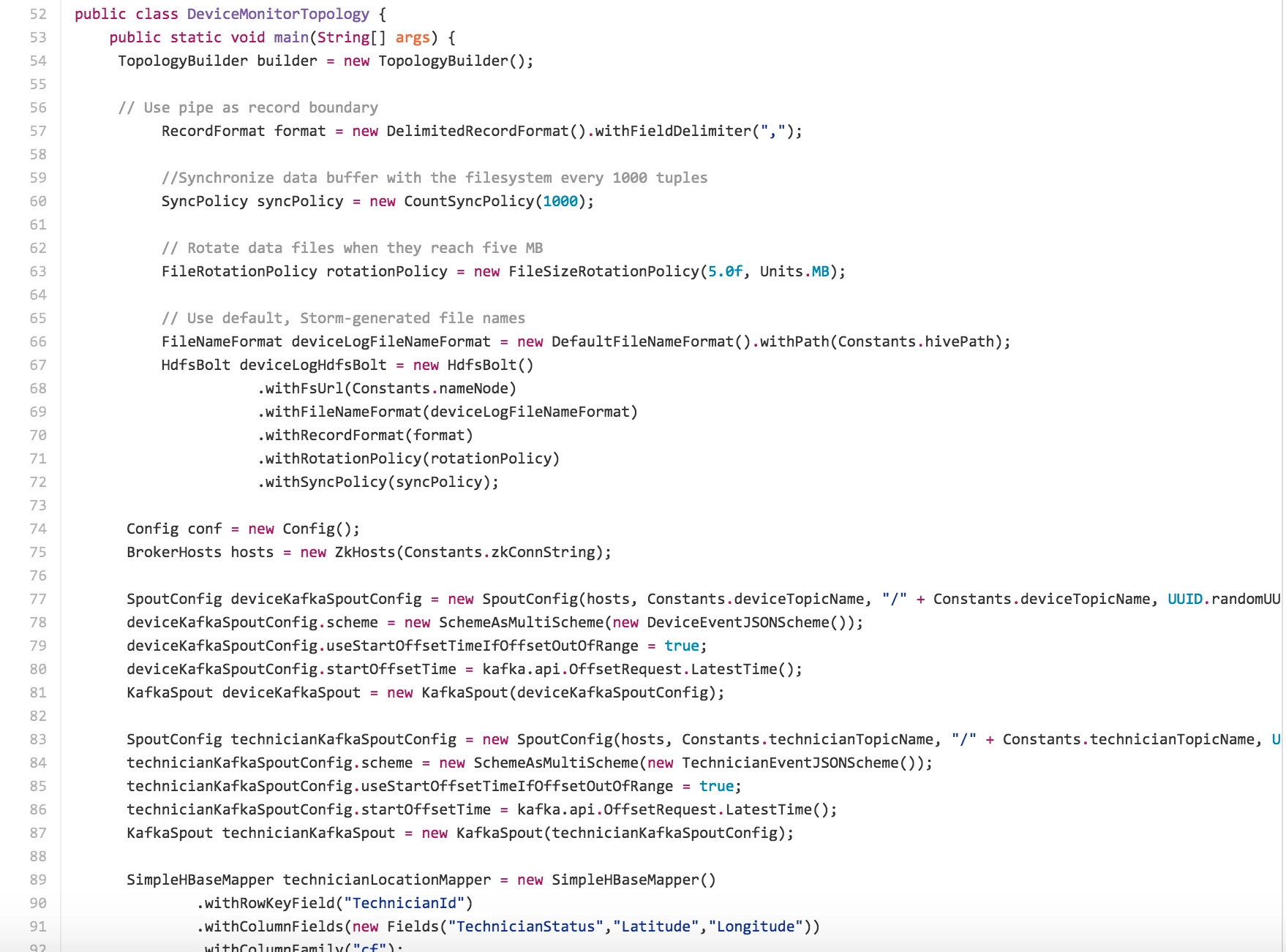

What each of the spouts does is simply look for the status of the device('Normal' or not) and technician( 'Assigned' or not) and enqueue or emit the status to bolts for future event decisions. Bolts process the data based on the event type (device/technician) like publishing the device status and technician location, updating the Hbase tables, enriching the device status, intelligent incident detection, printing alerts, routing the technician etc.
Various configurations are done in DeviceMonitorTopology (detailed code here )that set the bolts and spouts using several methods like TopologyBuilder() ,setBolt(), setSpout(), SpoutConfig() etc

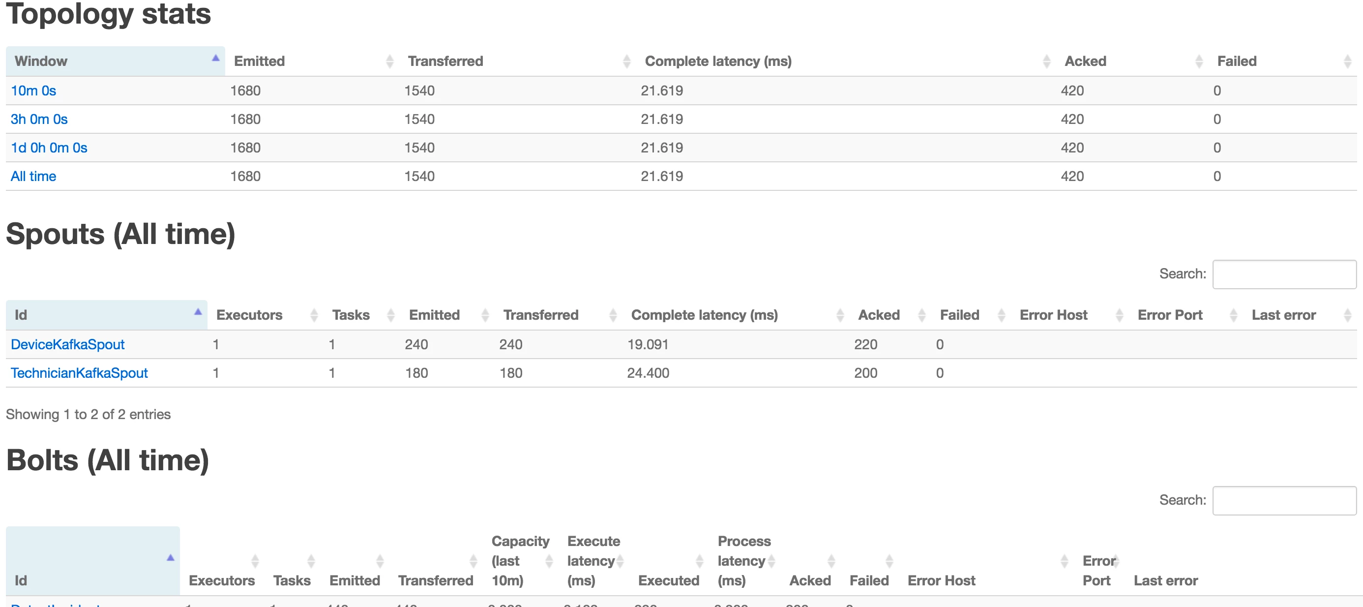

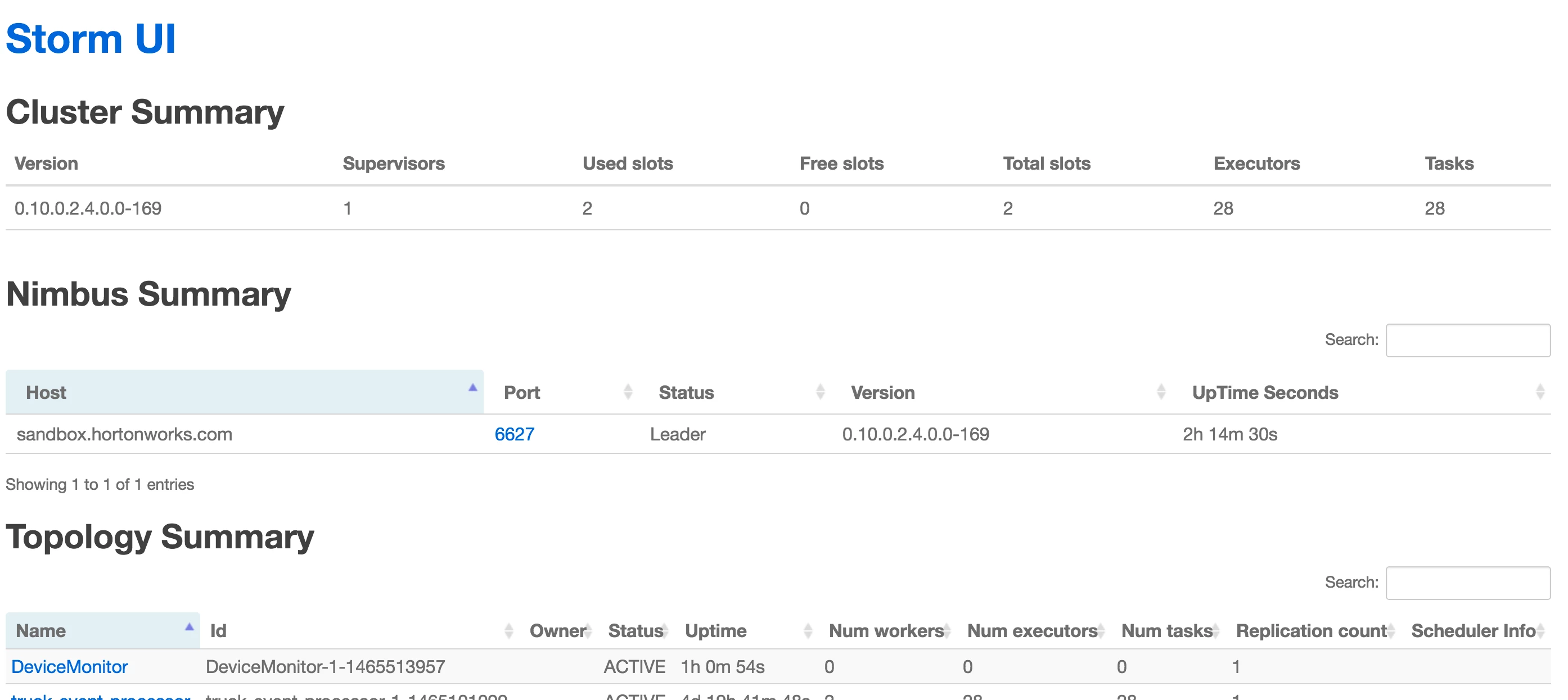

3. Verify the storm topology is properly submitted, by going to the StormUI quick link on Ambari and you should see below:
Spouts and Bolts on the Storm UI:

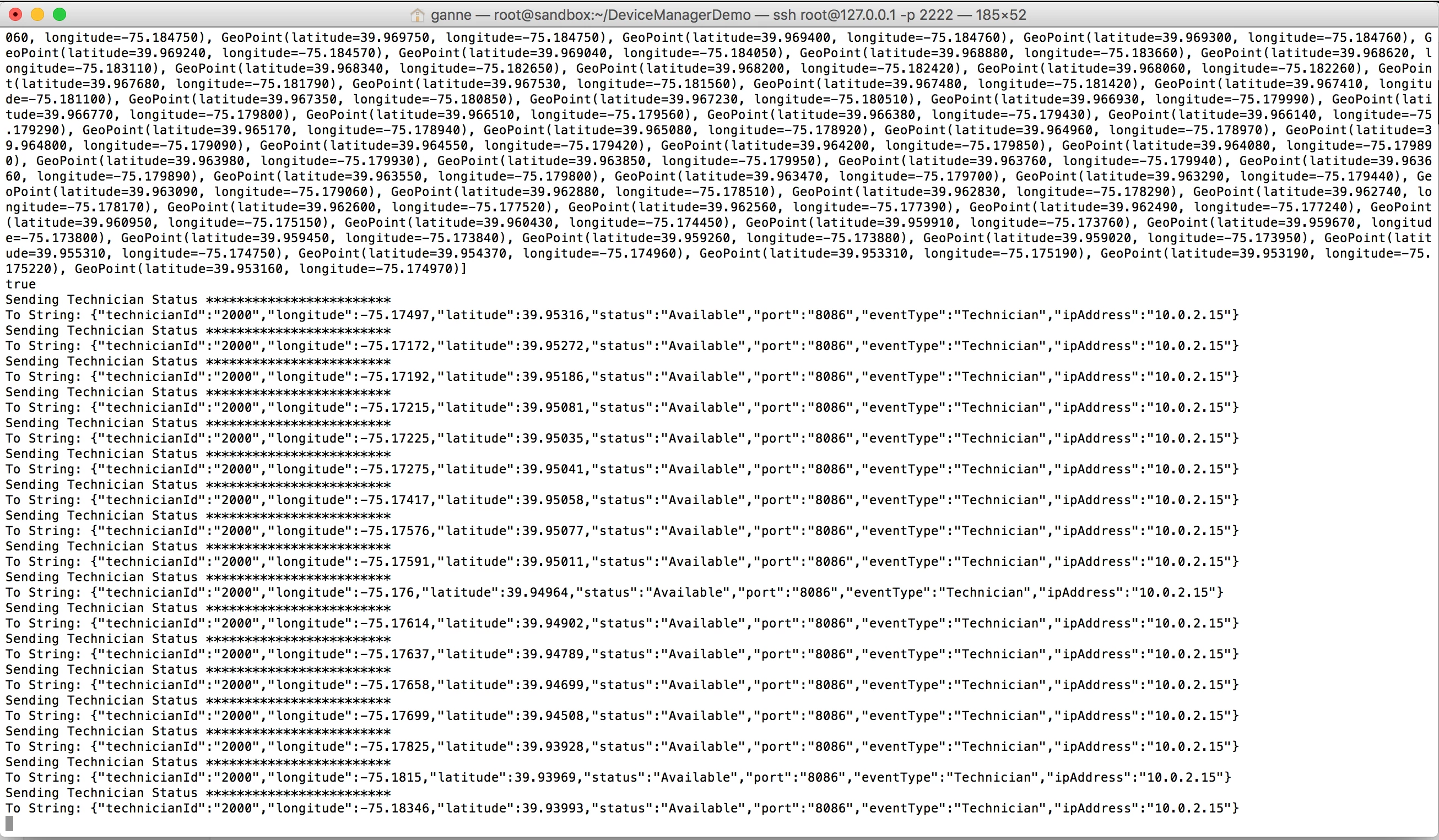

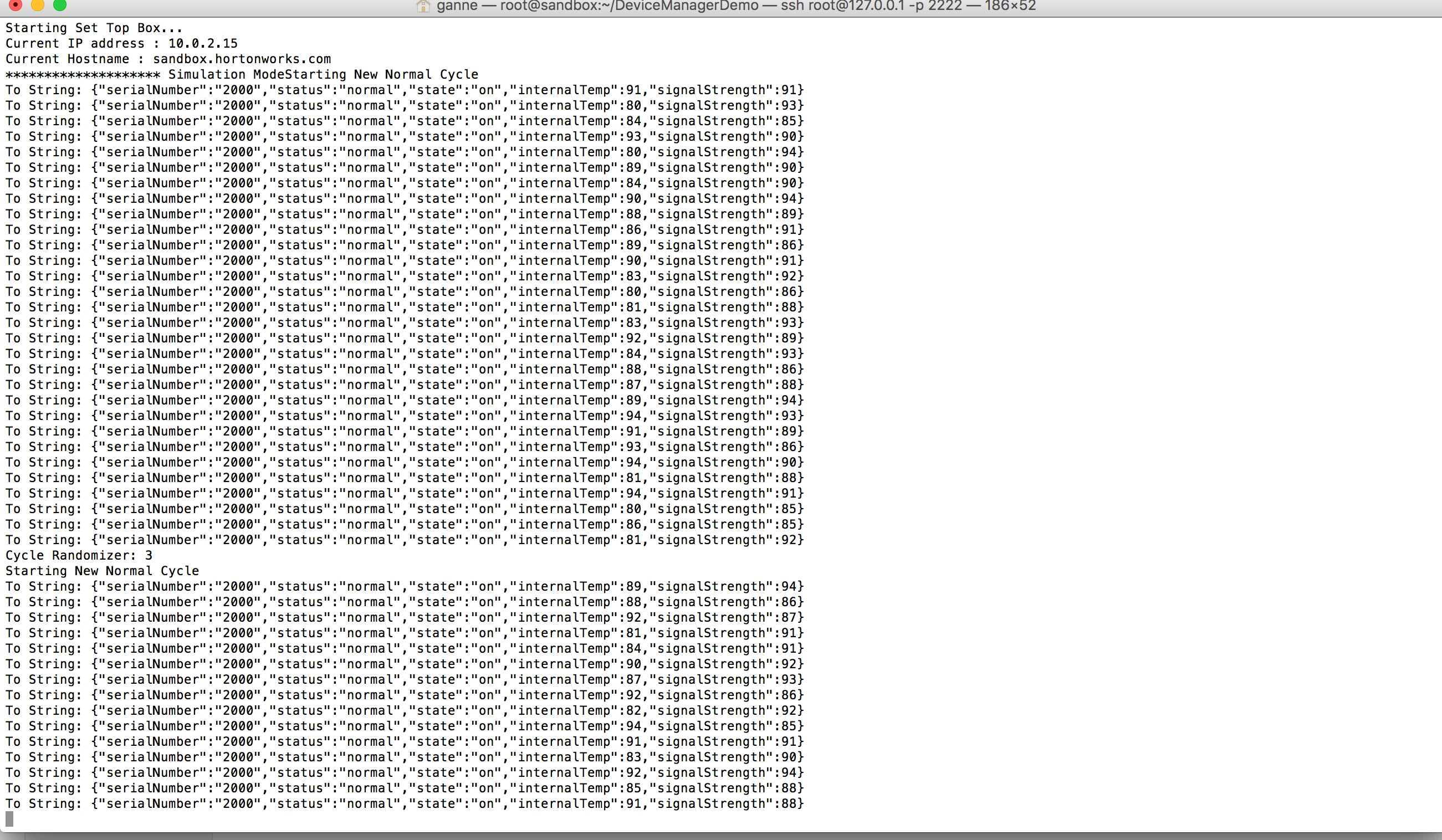

4. Inoder to see the events get simulated,Run the simulator jars from two different CLIs:
cd DeviceManagerDemo
java -jar DeviceSimulator-0.0.1-SNAPSHOT-jar-with-dependencies.jar Technician 1000 Simulation
java -jar DeviceSimulator-0.0.1-SNAPSHOT-jar-with-dependencies.jar STB 1000 Simulation
DeviceStatus and TechnicianLocation Events are generated by the jars:
Technician:

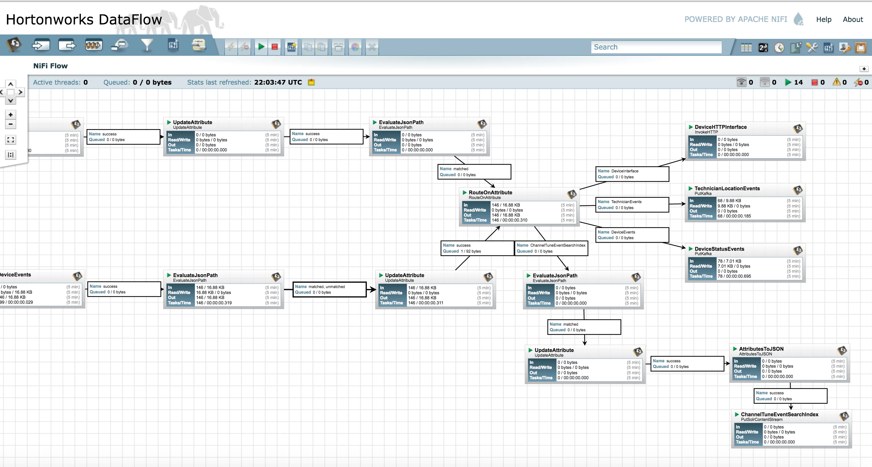

5. After importing the Devicemangerdemo Nifi template, it look like below, with several processors connected and running the data flow in sequential fashion.
6.Some of the major decision making processors involved and by viewing their configurations,one can see the content in 'properties' tab as below:

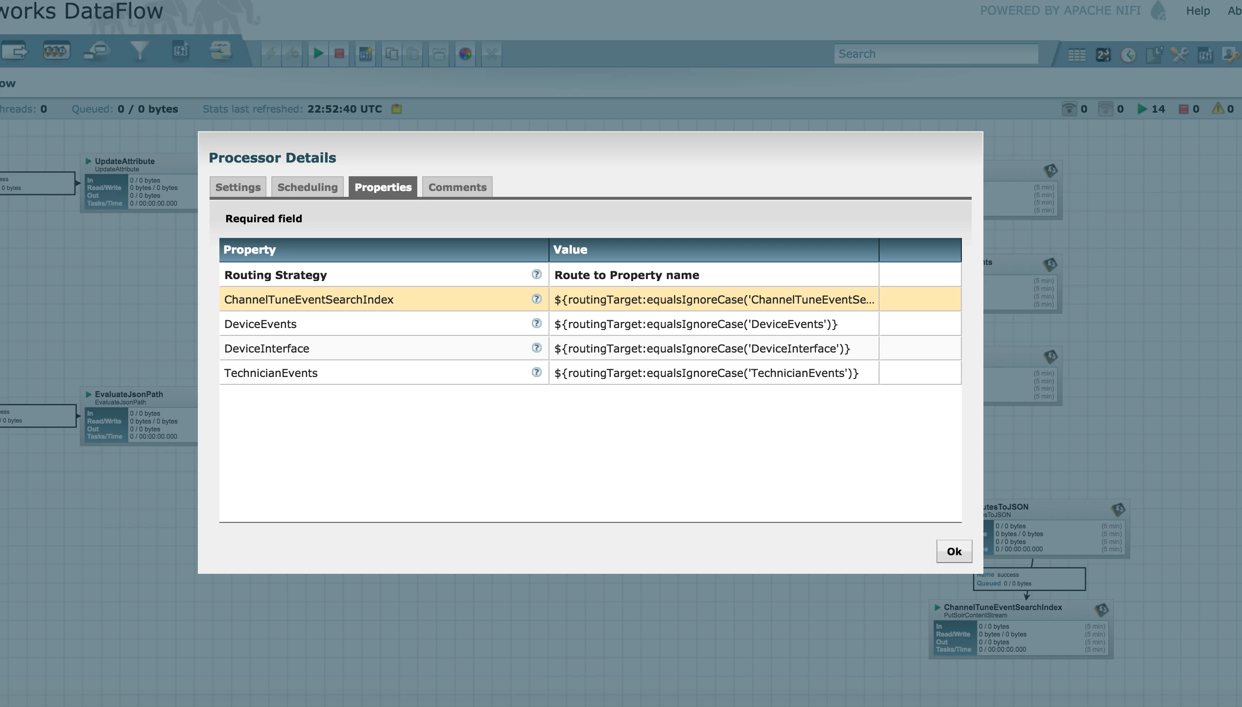

1.RouteOnAttribute:
ChannelTuneEventSearchIndex :${routingTarget:equalsIgnoreCase('ChannelTuneEventSearchIndex')}
DeviceEvents :${routingTarget:equalsIgnoreCase('DeviceEvents')}
TechnicianEvents :${routingTarget:equalsIgnoreCase('TechnicianEvents')}
DeviceInterface :${routingTarget:equalsIgnoreCase('DeviceInterface')}

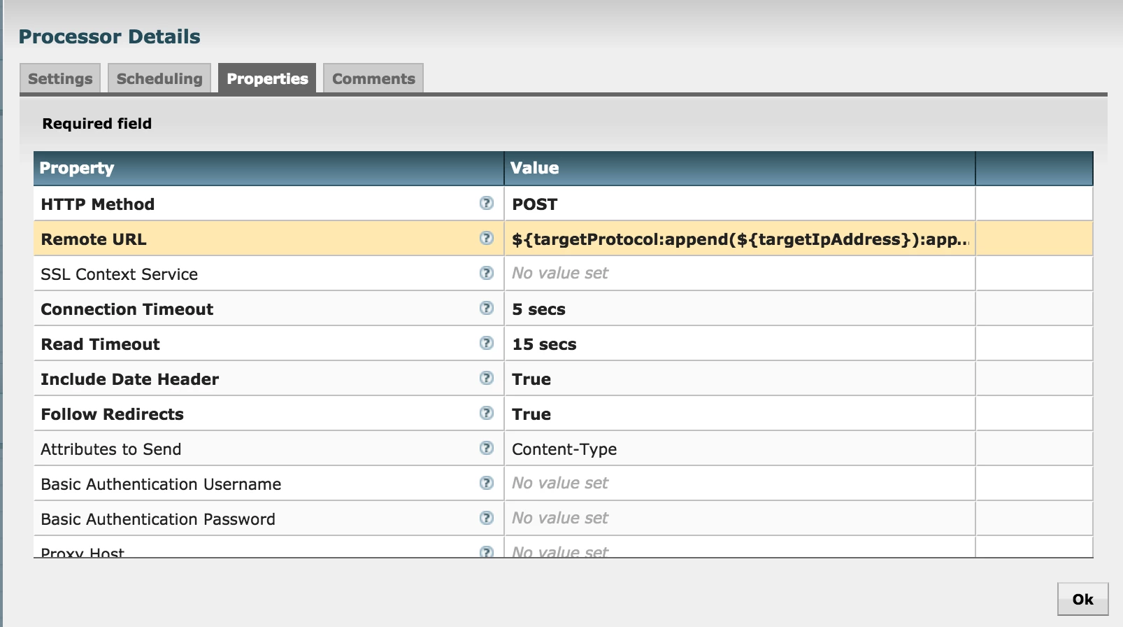

2.DeviceHTTPInterface:
HTTP Method: POST
RemoteURL: ${targetProtocol:append(${targetIpAddress}):append(':'):append(${targetPort}):append('/server/TechnicianService')}

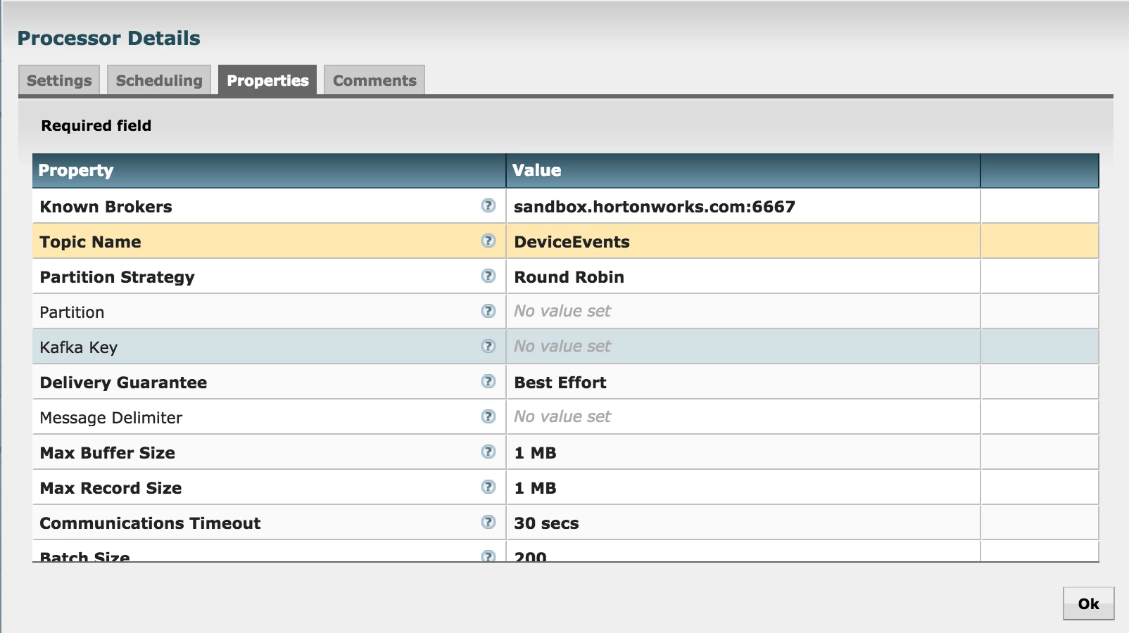

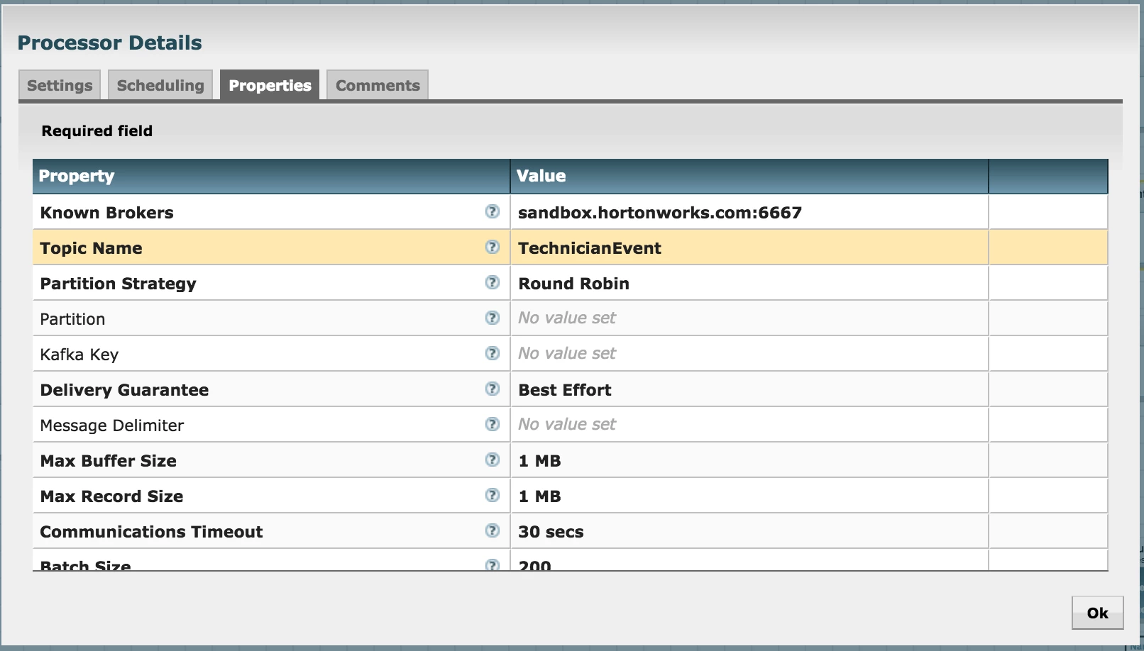

3.TechnicianlocationEvents: These technician information is pushed to the corresponding Kafka topic.
4.DeviceStatusEvents : Device status and other related event data is pushed to the corresponding Kafka topic.

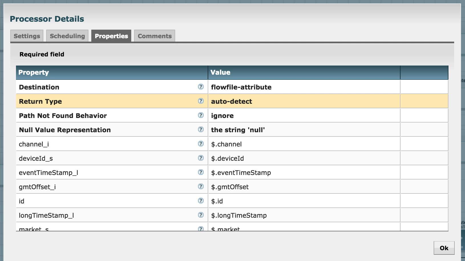

5. EvaluateJSONPath
Several jsonpaths that are user-defined properties like channel_i,deviceId_s,eventTimeStamp_I etc are evaluated against the content of the flowfile and written to the corresponding attributes in the next step of dataflow.

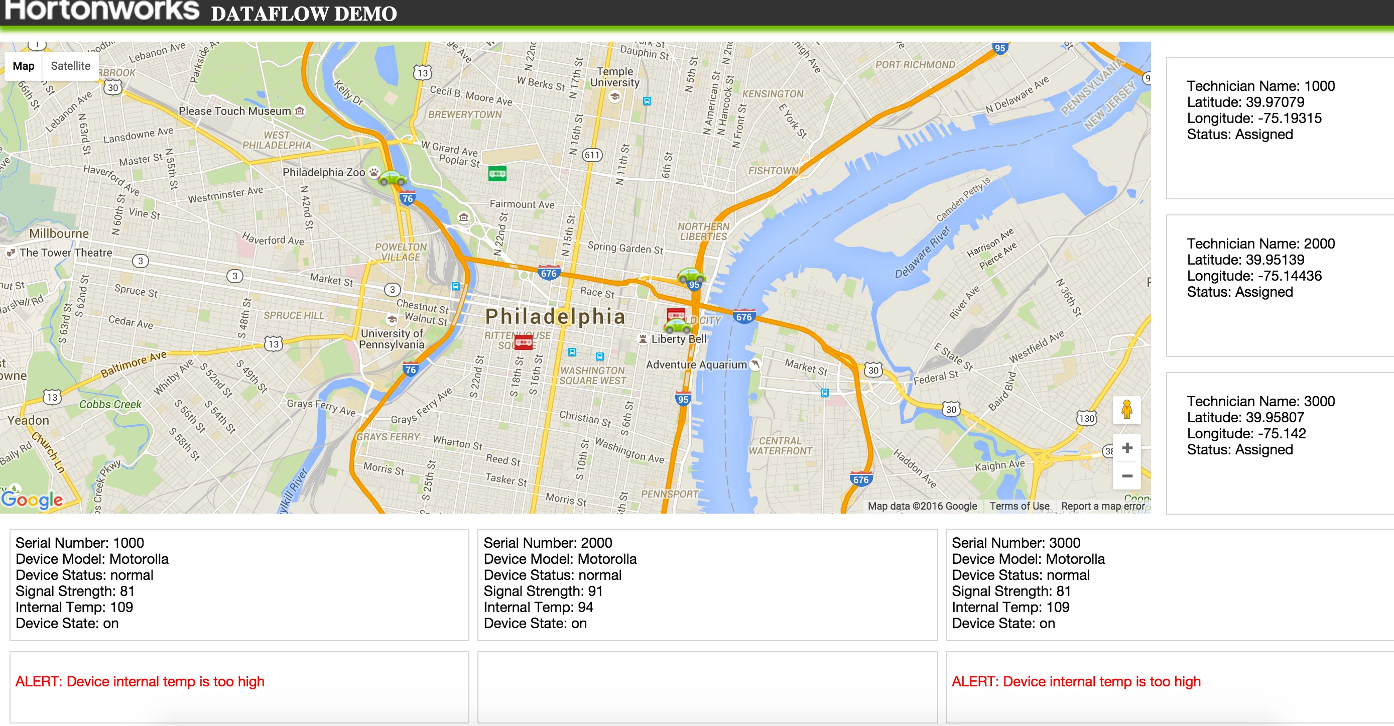

7. Now navigate to the MapUI to see the car of the technician moving arround, which was initiated by Slider here http://sandbox.hortonworks.com:8090/MapUI/DeviceMap
