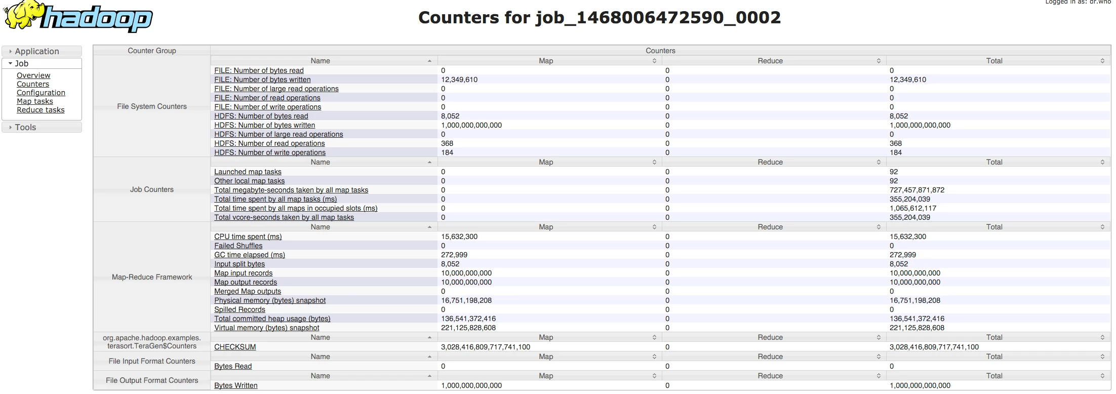

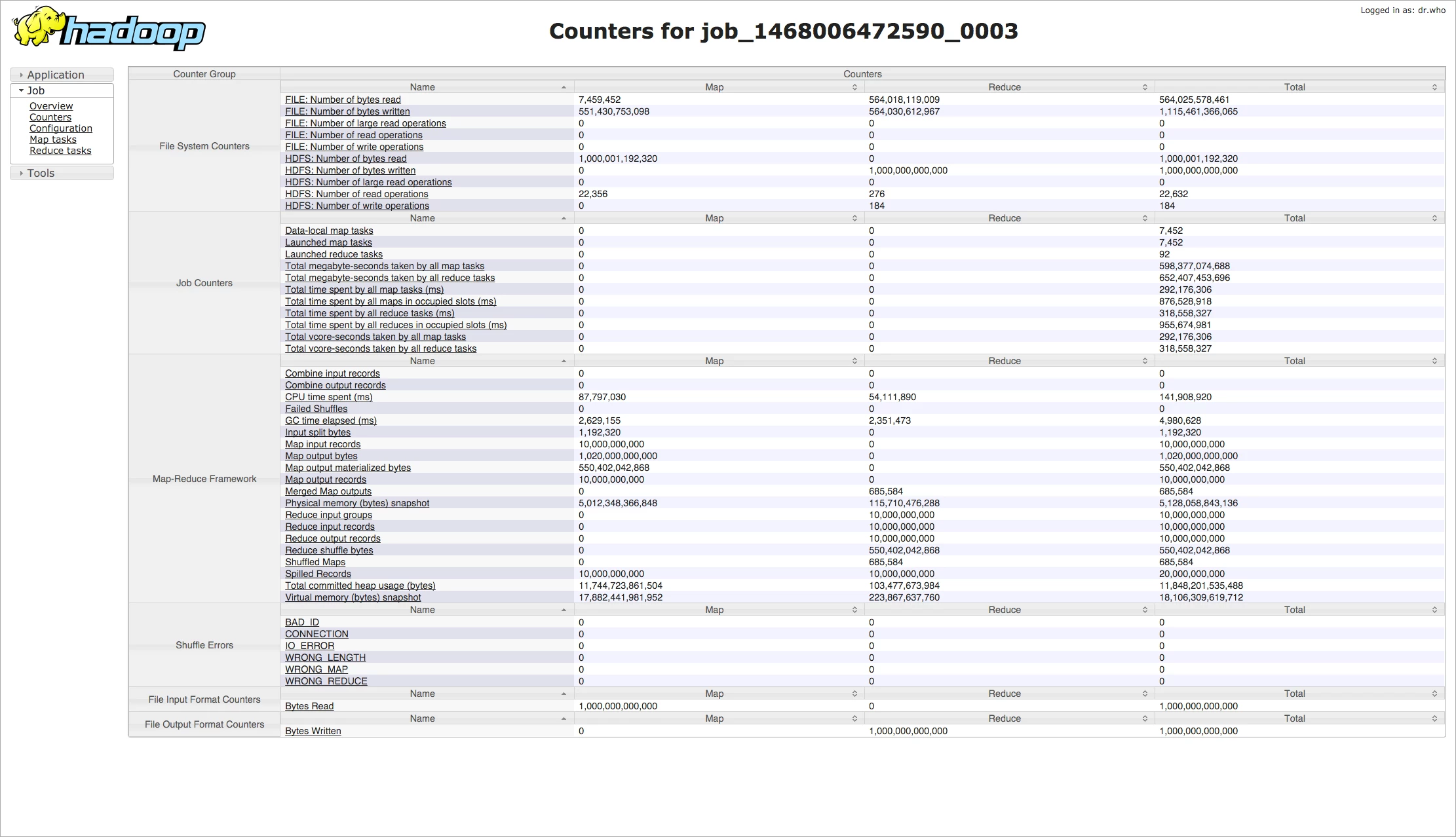

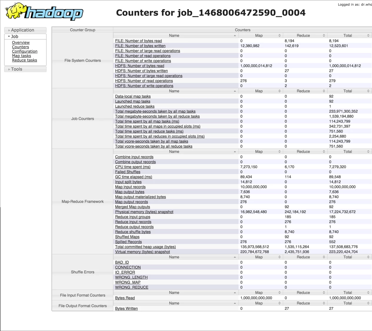

This article should be used with extreme care. Do not use as benchmark. I performed this test to simply run a quick 1 Terabype teragen test on AWS to determine what type of performance I can get from mapreduce on AWS with VERY LITTLE configuration tweaking/tuning
On my github page here you will find the following:
  • teragen script
  • hadoop,yarn,mapred,capacity scheduler configurations used during testing
Hardware: (Master & Datanode)
1 Master, 3 Data nodes
d2.4xlarge, 16vCPU, 122GB ram, (max) 12x2000 Storage
TeraGen Results:
1hrs, 6mins, 38sec

Terasort Results:
1hrs, 34mins, 20sec
Teravalidate Results:
25mins, 27sec
