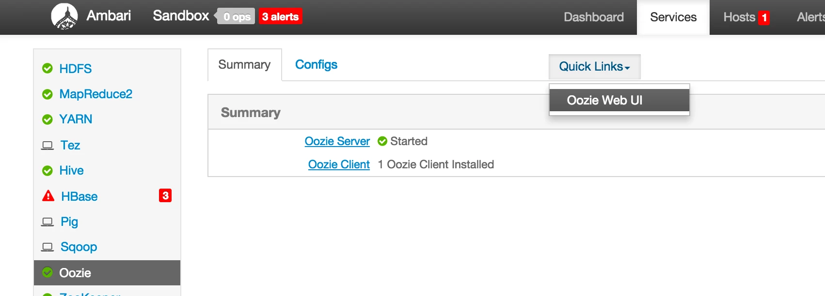

1) Open Oozie UI

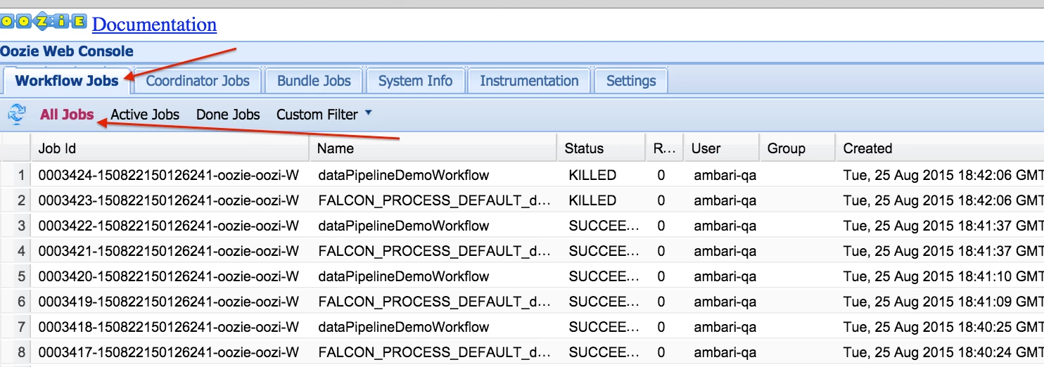

2) Locate the job instance that failed and double click on it

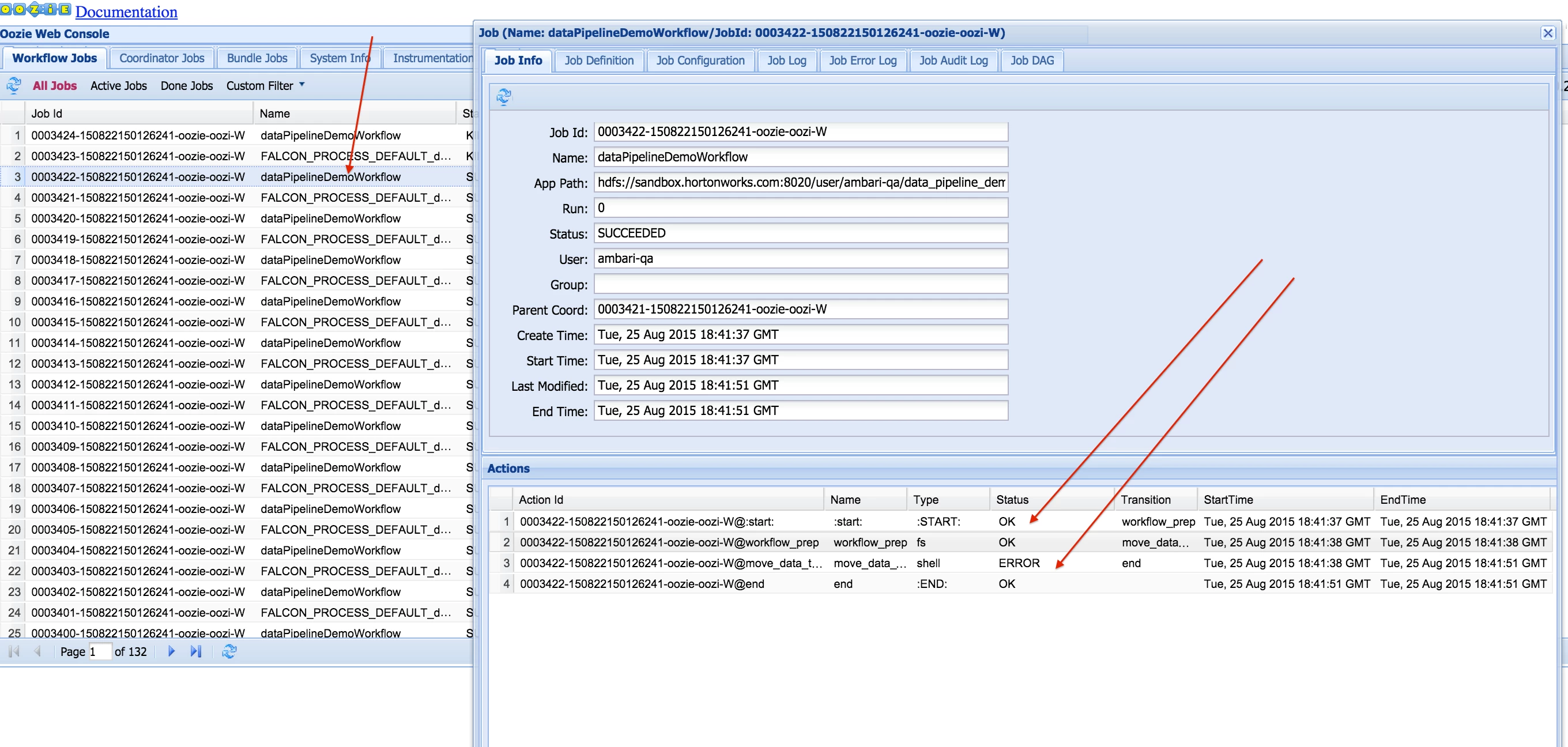

3) Locate the step that failed and double click on it

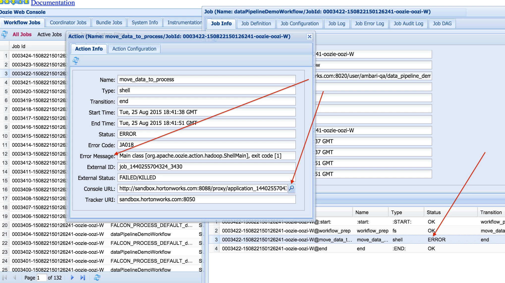

4) From the Action pop-up, (which also has the cryptic error message in Error Message) click on the small magnifying glass on the right hand side of the Console URL.
5) From the next screen, click on the link that reads "logs" and view the details. (TBD - Add Screen snapshot)
