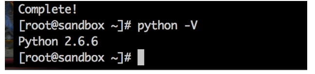

iPython has a requirement for Python 2.7 or higher. Check which version of Python you are using:4940-screen-shot-2016-06-10-at-113400-am.png
In my case, I had an older version of Python so I then had to install a new version.

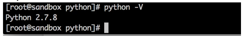

Install Python 2.7:
  1. wget http://python.org/ftp/python/2.7.6/Python-2.7.6.tar.xz
  2. tar xf Python-2.7.6.tar.xz
  3. cd Python-2.7.6
  4. ./configure --prefix=/usr/local --enable-unicode=ucs4 --enable-shared LDFLAGS="-Wl,-rpath /usr/local/lib"
  5. make && make altinstall
  6. source /opt/rh/python27/enable

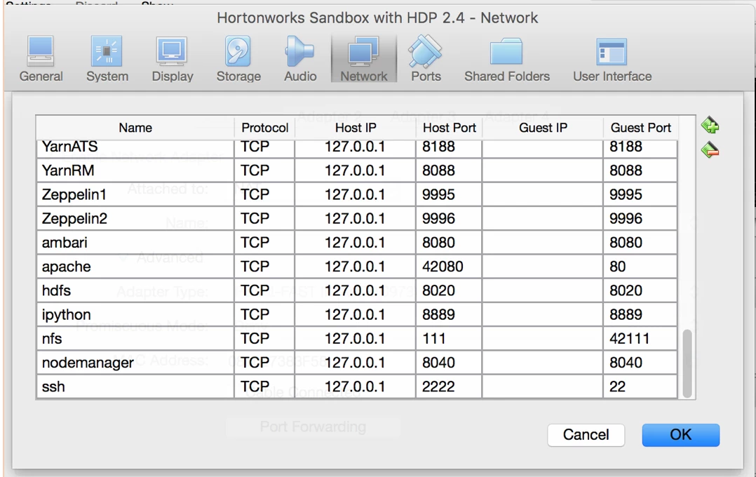

STEP 8
Add a port forwarding rule for port 8889

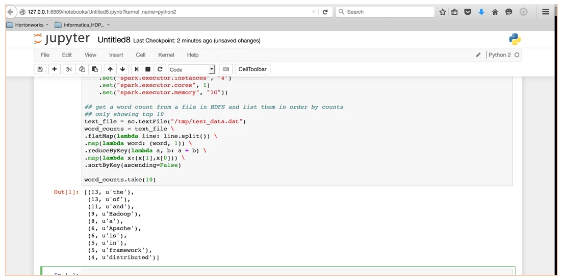

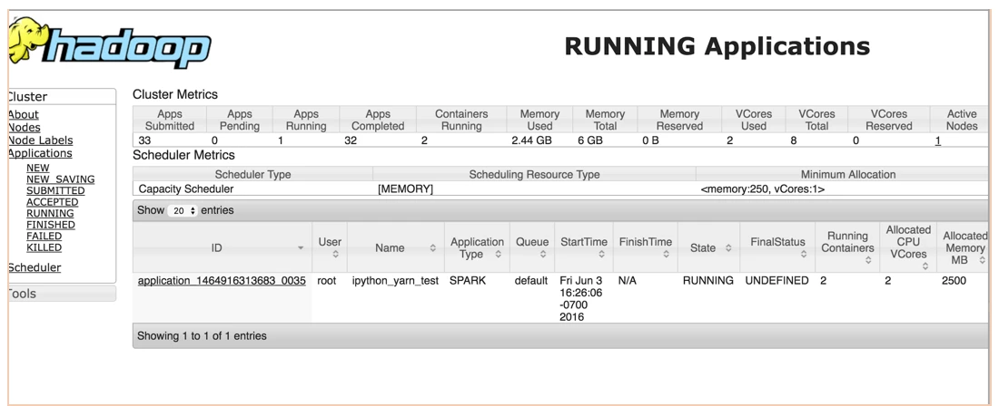

Below is my PySpark code (from notebook), a screenshot of my my job running in Resource Manager showing YARN resource allocation, and the output shown in the notebook.
CODE:
## stop existing SparkContext
## i did this because i create a new SparkContext with my specific properties
sc.stop()
import os
from pyspark import SparkContext, SparkConf
## set path to Python 2.7
os.environ["PYSPARK_PYTHON"] = "/usr/local/bin/python2.7"
sc = SparkContext(
conf = SparkConf()
.setMaster("yarn-client")
.setAppName("ipython_yarn_test")
.set("spark.dynamicAllocation.enabled", "false")
.set("spark.executor.instances", "4")
.set("spark.executor.cores", 1)
.set("spark.executor.memory", "1G"))
## get a word count from a file in HDFS and list them in order by counts
## only showing top 10
text_file = sc.textFile("/tmp/test_data.dat")
word_counts = text_file .flatMap(lambda line: line.split()) .map(lambda word: (word, 1)) .reduceByKey(lambda a, b: a + b) .map(lambda x:(x[1],x[0])) .sortByKey(ascending=False)
word_counts.take(10)
STEP 12
Finally, run the code in the Notebook. Below is the output from the Notebook and Resource Manager showing the job.
