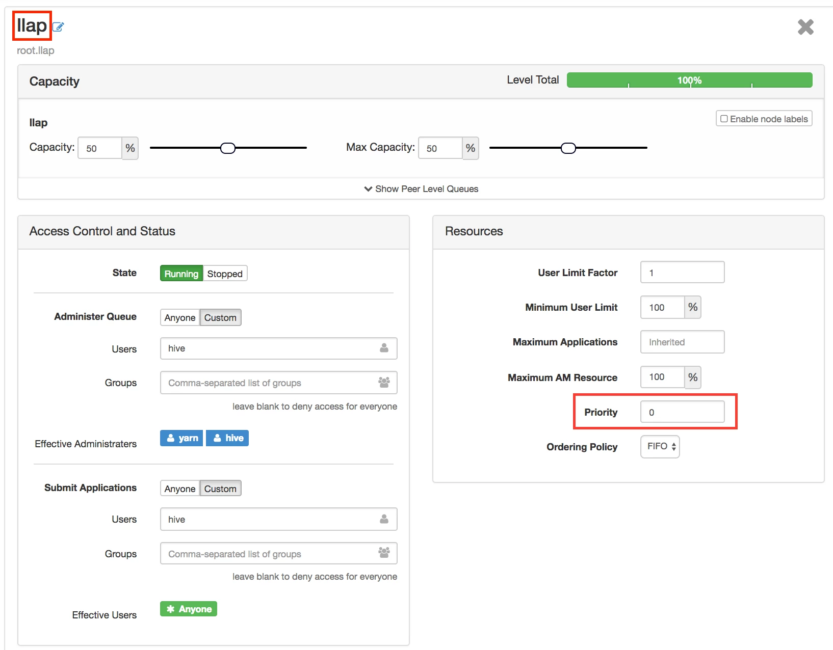

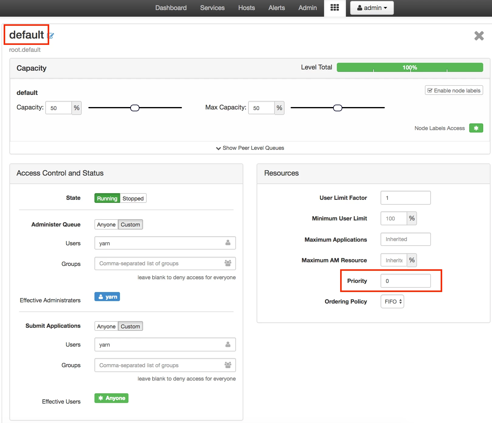

    Root Cause:
    This issue occurs when there is an issue with queue prioritization, where both queues have priority set to 0 which means both are of equal priority. This can be viewed from Ambari > Yarn Queue Manager view.
    The Hive LLAP (Low-Latency Analytical Processing) enables us to run Hive queries with low-latency in near real-time. To ensure low-latency, set the priority of the queue used for LLAP to a higher priority, especially if the cluster includes long-running applications.
    Solution
    To resolve this issue, set the priority of queue LLAP to a higher value higher than the default queue.
    After setting the higher priority, ensure to save and refresh the queues for the change to take effect.
