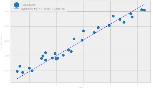

In this article we’re going to look at linear regression, which is a technique for estimating linear relationships between various features and a continuous target variable. Linear regression provides the ability to measure a correlation between your input data and a response variable. We’ll illustrate this concept with a simple example. Suppose you have collected data for employees’ years of experience and their corresponding salaries. To understand the distribution of this data we can generate a plot as shown in Fig 1. You can see that there’s a linear relationship between years of experience (x) and salary (y). This correlation allows us to build a linear regression model that outputs a salary given years of experience.
Fig1 : Points plotted using training examples (years of experience, salary)

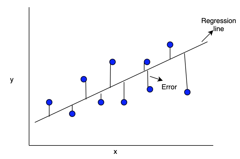

Let’s look at the internals of a linear regression algorithm. The  algorithm will fit a line in the form of y = β0 + β1x to your data. Here we call x the independent variable or input variable and y is called the dependent variable or output variable, β1 represents the slope of the line and β0 represents the intercept of the line. The goal of the algorithm is to find a line that best fits a set of points to minimize the error where the error is the distance from the line to the points.
Fig 2: Describes the error which is the distance between actual value and the estimated regression line.

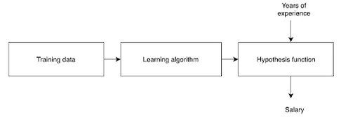

Linear regression algorithm
Fig3 : Showcasing Linear regression model using input variable as Years of Experience and Salary
Hypothesis function refers to the equation h(x) = β0 + β1x which maps input x (years of experience) to target y (salary).

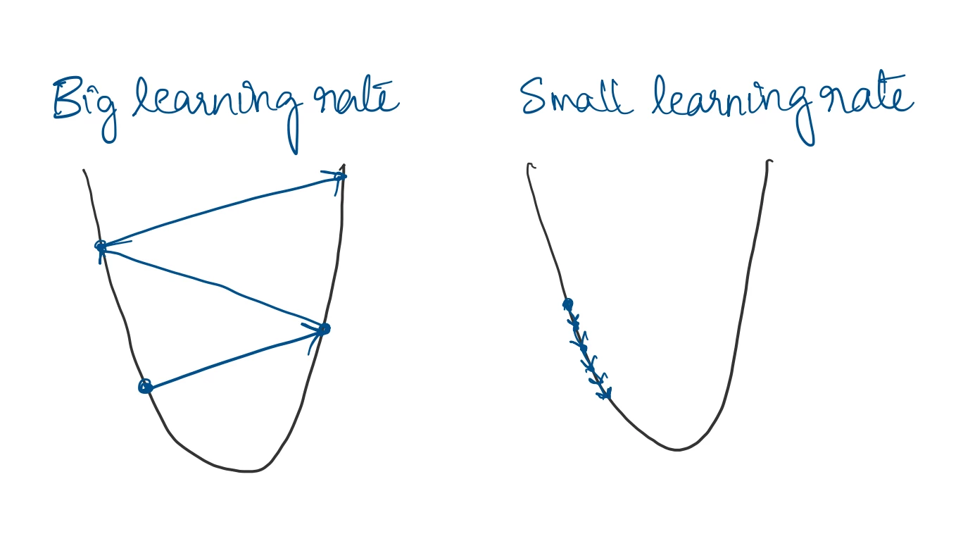

Gradient descent is one of the methods that can be used to reduce the error, which helps by taking steps in the direction of a negative gradient. Gradient descent is an optimization algorithm that tweaks its parameters iteratively. In machine learning, gradient descent is used to update parameters in a model. Let us relate gradient descent with a real-life analogy for better understanding. Think of a valley you would like to descend, you first will take a step and look for the slope of the valley, whether it goes up or down. Once you are sure of the downward slope you will follow that and repeat the step again and again until you have descended completely (or reached the minima).Gradient descent does exactly the same. The algorithm makes use of learning rate parameter to take steps. Choosing the learning rate is an important step as big learning rate can skip the minima and very small learning rate can take infinite time to reach the minima.
Fig 4: Very big learning rate can skip the minima and very small learning rate might take infinite steps to reach minima
