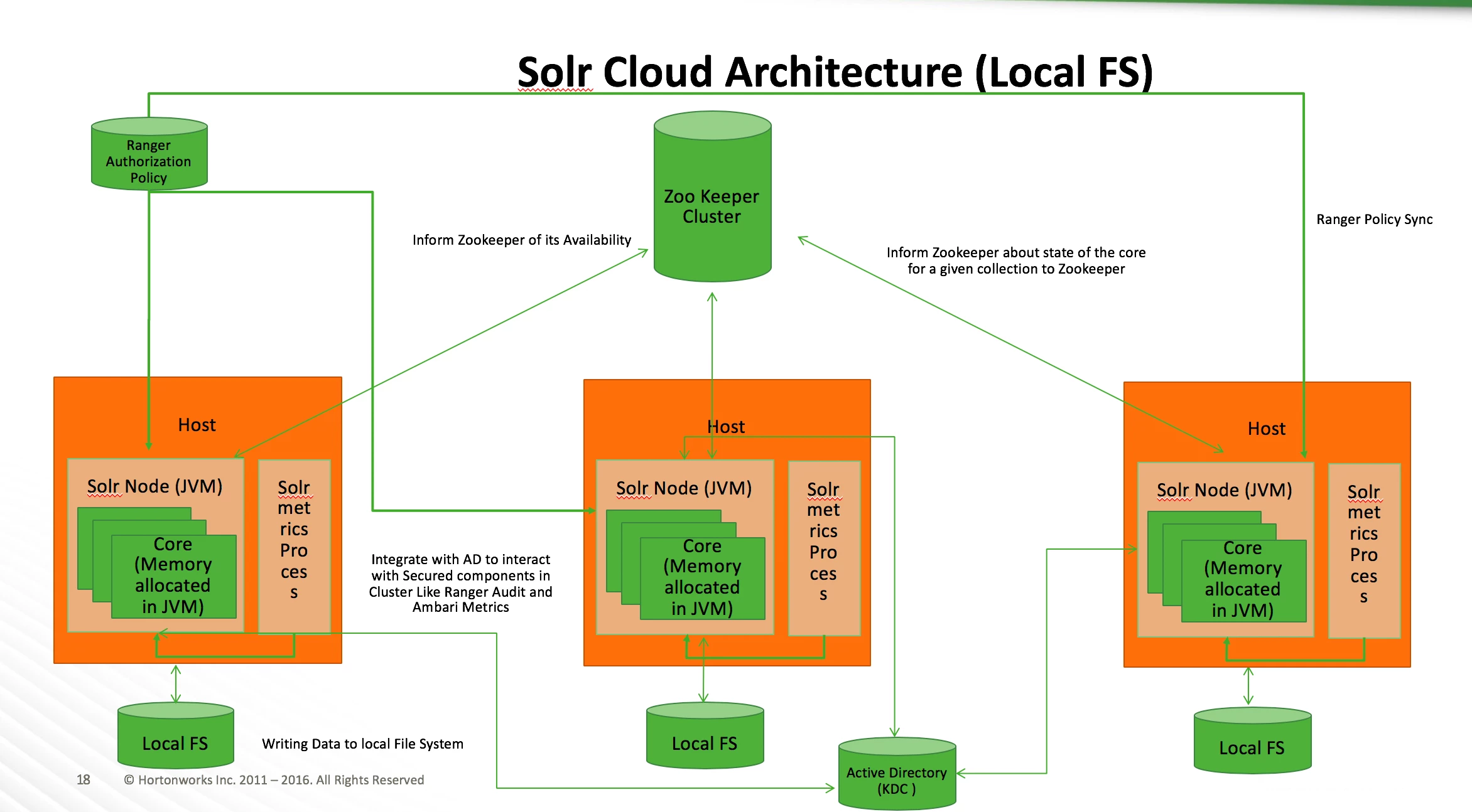

1. Solr works on a non master-slave architecture, every solr node is master of its own. Solr nodes uses Zookeper to learn about the state of the cluster.
2. A solr Node (JVM) can host multiple core
3. Core is the place where Lucene (Index) engine is running. Every core has its own Lucene engine
4. A collection will be divided in shards.
5. A shard will be represented as core (A part of JVM) in the Solr Node (JVM)
6. Every solr node keeps sending heartbeat to Zookeeper to inform about its availability.
7. Usage of Local FS provides the most stable and best IO for solr.
8. A replication factor of 2 should be maintained on local mode to avoid any data loss.
9. Do remember every replication will have a core attached to it and also space is disk.
10. If a collection is divided into 3 shards with replication factor of 3 : in total 9 cores will be hosted across the solr nodes.
Data saved on local fs will be 3X

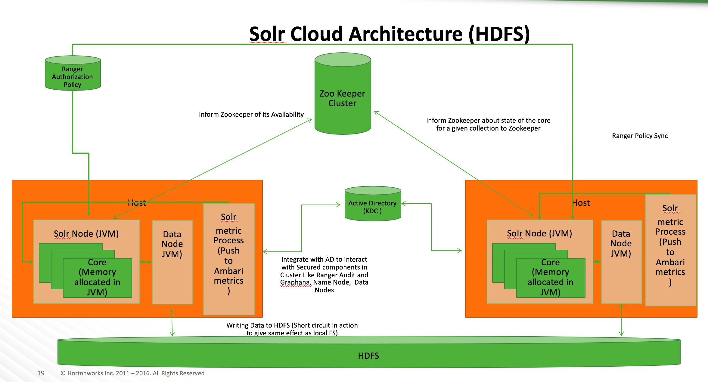

Solr on HDFS
1. Solr node should be colocated with data nodes for best performance.
2. Because of DataNodes are used used by Spark, Hbase this setup can result into unstable Solr Cloud easily.
3. Because of heavy CPU consumption on data nodes solr nodes can loose to establish heart beat connection to zookeeper resulting in the solr node being removed from solr cluster.
4. Watch for solr logs to make sure short-circuit writes are being used.
5. At collection level you are compelled to use replication factor of 2 else a restart of one node will result in the collection being unavailable.
6. Replication of 2 at collection level and Replication Factor of 3 at HDFS can significantly impact the Write peroformance.
7. Ensure the RF of the Sole HDFS directory is set to 1.

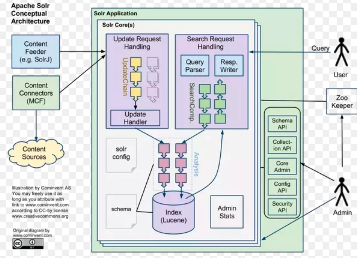

Lucene Indexing on single Core
Pic taken from : https://www.quora.com/What-is-the-internal-architecture-of-Apache-solr
