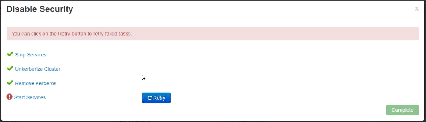

ISSUE: While performing unkerberizing cluster all services were down and nothing was coming up. Also the unkeberized cluster step failed. The start of services was failed.

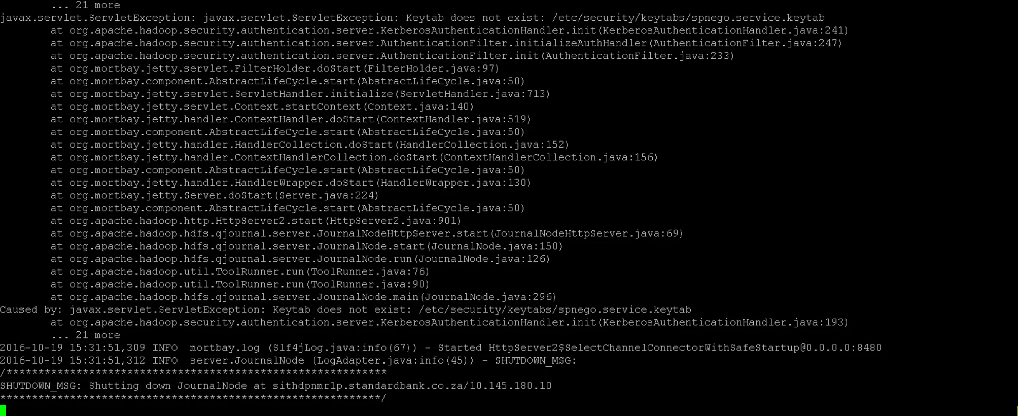

Tried to manually start Namenodes which came up but the status was not displayed correctly in Ambari UI. The journal node were not able to start and was failing with error as shown below.
ERROR: Screenshot is attached below
Journal node error:

1. From the JN error it says "missing spnego keytab". From the error It seems the kerberos was not properly disabled on cluster.
