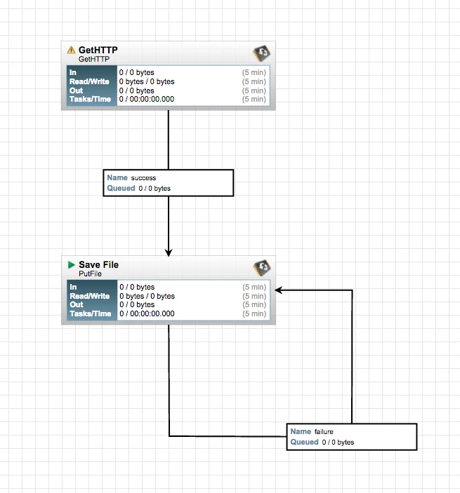

Here’s the test flow we will be working with today:
Prepare the test flow:
  • Add a PutFile component to the canvas.
  • Rename the processor to Save File (right-click -> Configure -> Settings -> Name field). We will be using this name to look up the processor later via API.
  • Add a GetHTTP processor and create a connection from GetHTTP to ‘Save File’. GetHTTP settings can be ignored for now, the Save File processor simply needs an input connected.

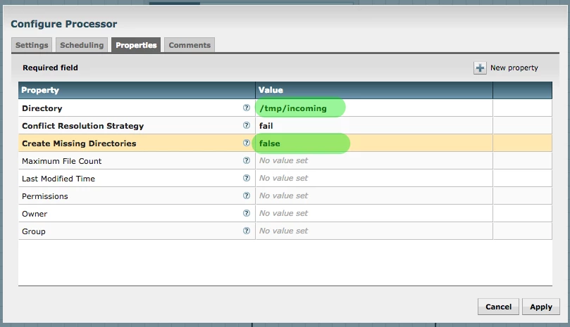

  • Set the Save File properties as below (these settings will be modified programmatically next)
  • Start the Save File processor (no need to start GetHTTP for our purposes)

Next, we will update the Save File processor to use a different directory (/tmp/staging) and set Create Missing Directories to true.

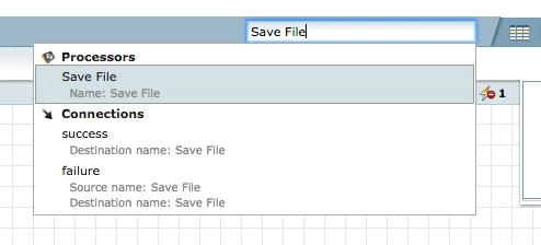

  1. Search the data flow for a component to operate on. Lookup term is 'Save File'. This is the same API used by the Search field in the UI.
  2. Validate there’s only 1 processor returned - we want to make sure we’re modifying the expected one.

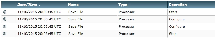

If you check the NiFi processor again, you will see the updated Directory and Create Missing Dirs. Additionally, every step has been captured and recorded in the flow history:
When you see a warning message in the UI, simply hit the Refresh link right next to it - I will explain the concurrency controls at the end of this article.

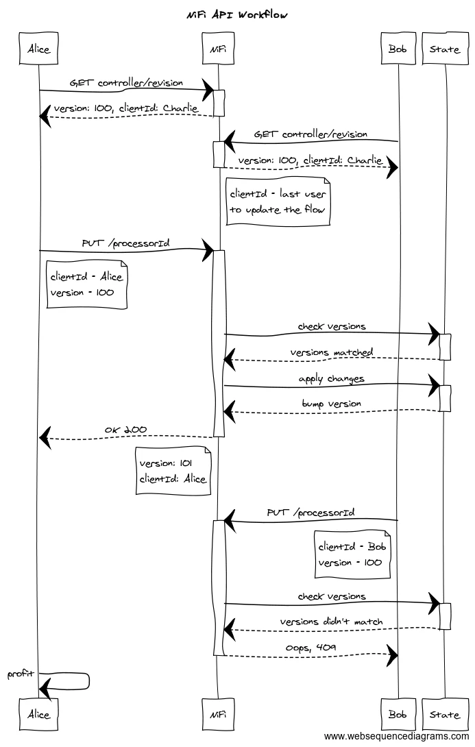

Optimistic Locking in NiFi
The diagram below describes the concept.
Supplying a clientId is required for update operations to avoid running into consistency issues (the API will respond with 409 Conflict status code and it will be really confusing if a developer doesn’t know about this attribute).
controller/revision returns the clientId of a user who last modified the flow among other things. This is NOT always your id, best practice is to supply your own unique value to identify the client. It’s actually a free-form value, UUID is just a default that the framework generates for you if missing.
