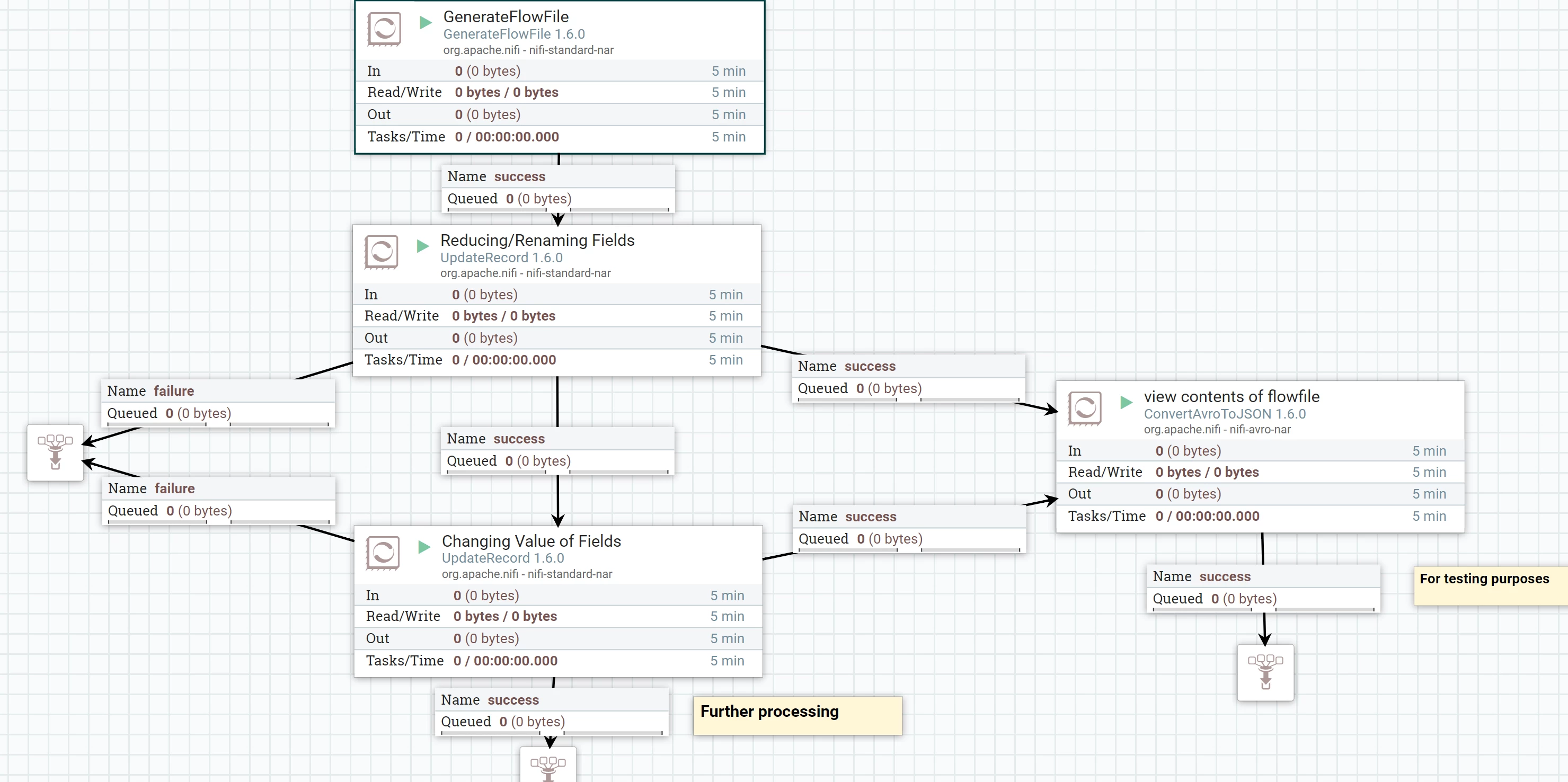

Flow:

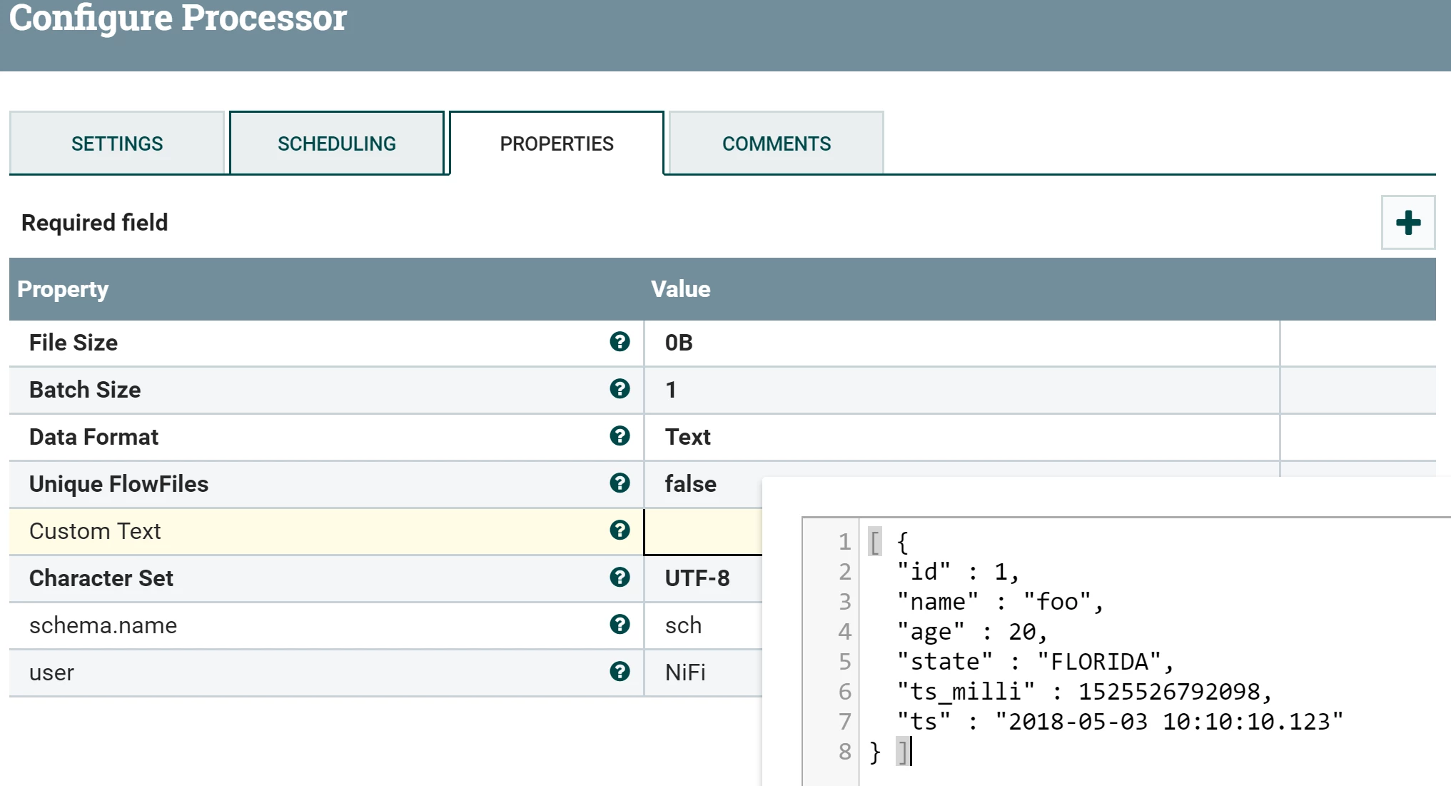

GenerateFlowFile Configs:
Configure the processor as shown below
Add new properties as
schema.name
sch
user
NiFi

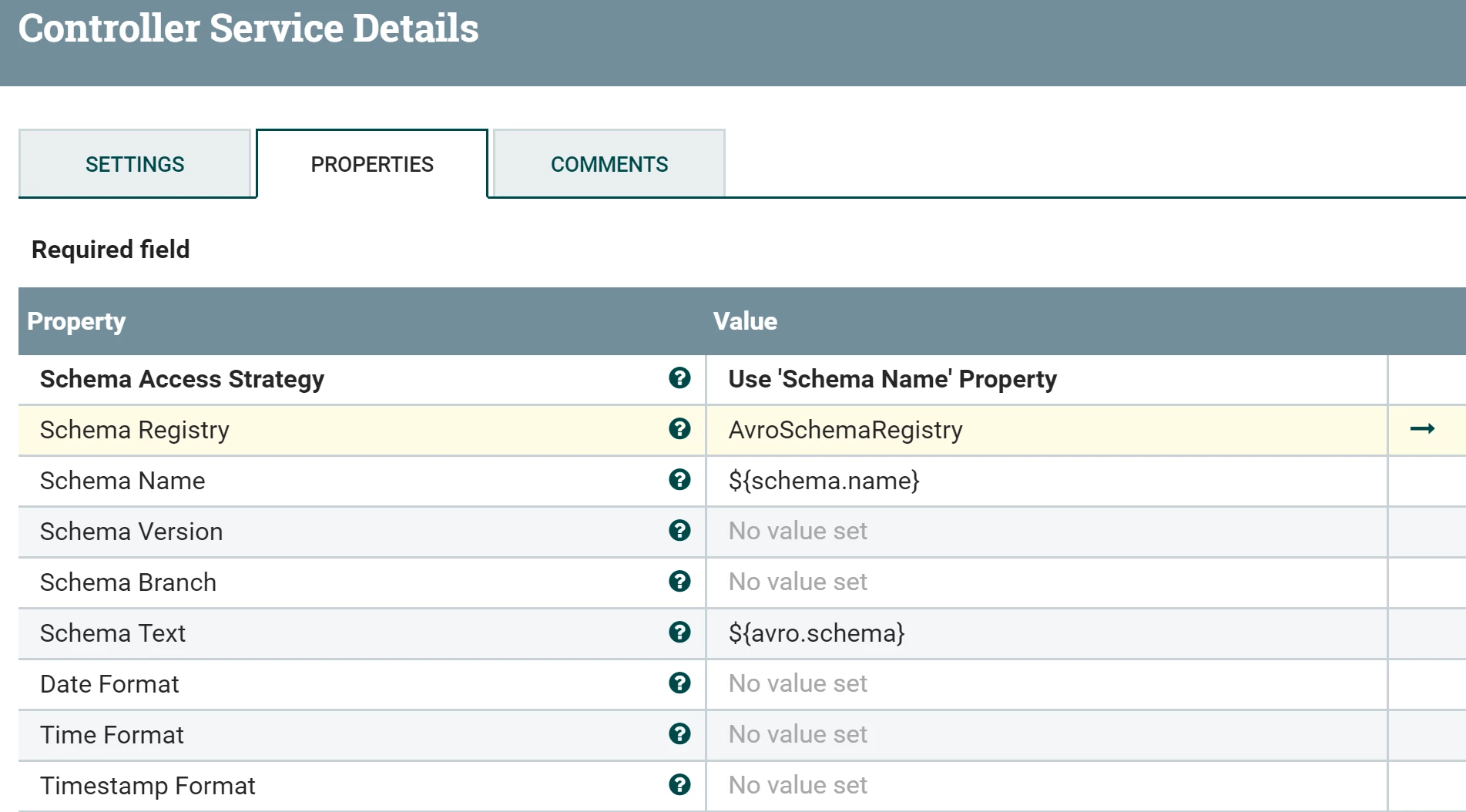

Record Reader: JsonTreeReader
Configure the controller service as shown below

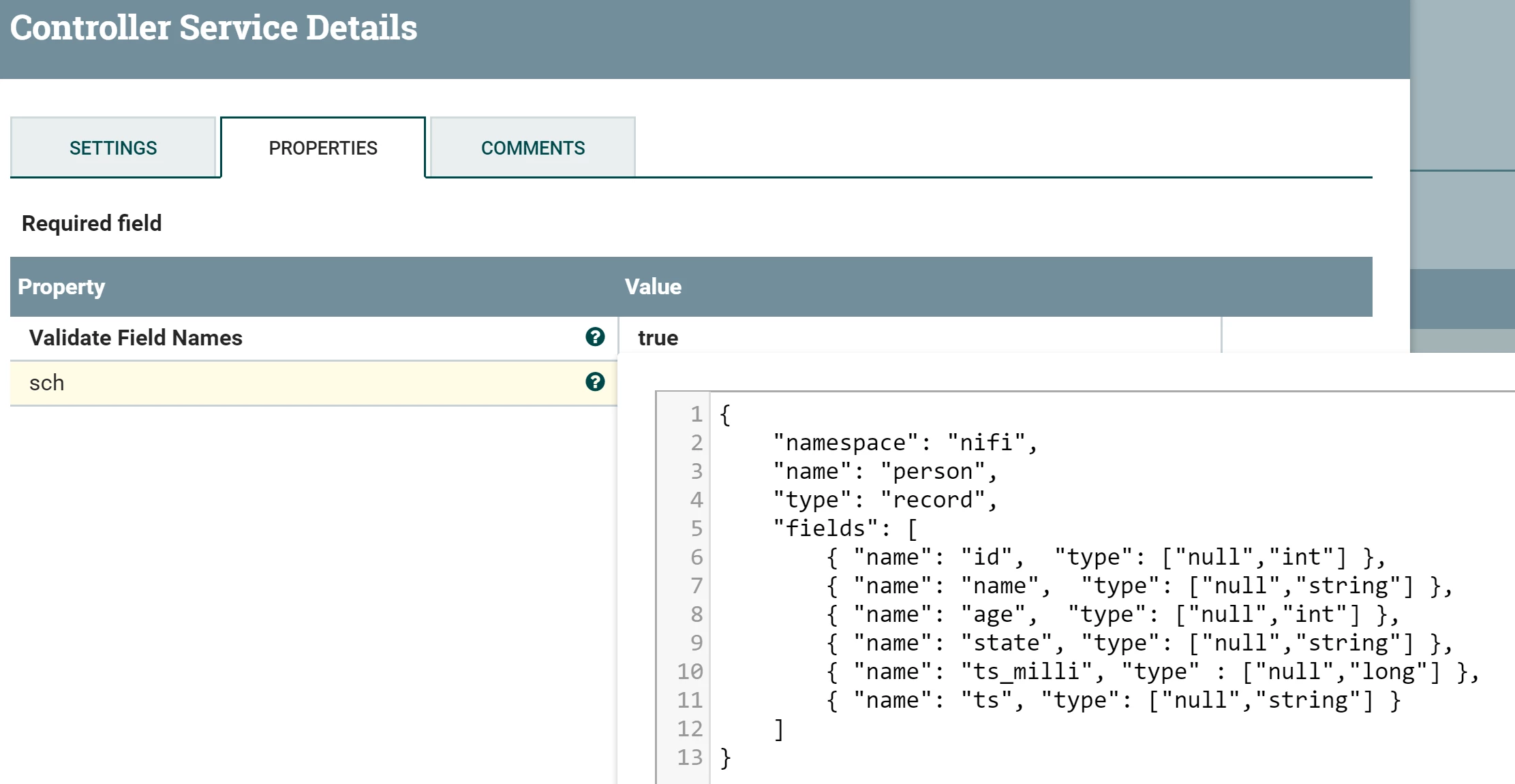

AvroSchemaRegistry Configs:
Add new property
sch
"namespace": "nifi",
"name": "person",
"type": "record",
"fields": [
{ "name": "id", "type": ["null","int"] },
{ "name": "name", "type": ["null","string"] },
{ "name": "age", "type": ["null","int"] },
{ "name": "state", "type": ["null","string"] },
{ "name": "ts_milli", "type" : ["null","long"] },
{ "name": "ts", "type": ["null","string"] }
By using above schema we are reading the incoming json message (or) you can even specify only the required fields in this schema then processor will read only those fields and all the names are case sensitive.

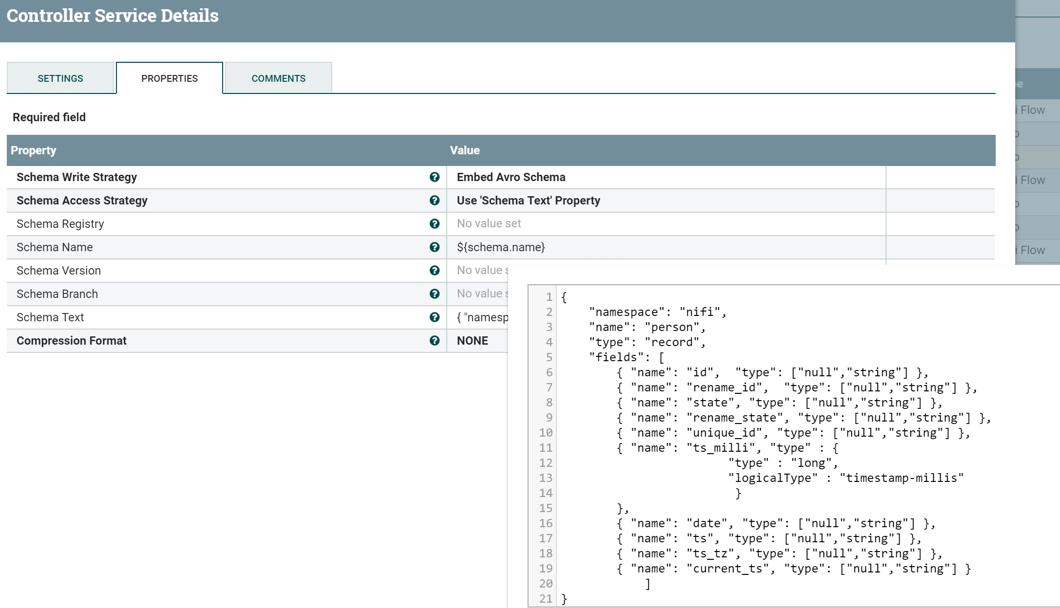

Record Writer:
I'm using AvroRecordSetWriter i.e we are reading input in json format and writing as avro format.
Configure the Controller service as shown below.
Schema Text:
"name": "person",
"type": "record",
"fields": [
{ "name": "id", "type": ["null","string"] },
{ "name": "rename_id", "type": ["null","string"] },
{ "name": "rename_state", "type": ["null","string"] },
{ "name": "unique_id", "type": ["null","string"] },
{ "name": "ts_milli", "type" : {
"type" : "long",
"logicalType" : "timestamp-millis"
{ "name": "date", "type": ["null","string"] },
{ "name": "ts", "type": ["null","string"] },
{ "name": "ts_tz", "type": ["null","string"] },
{ "name": "current_ts", "type": ["null","string"] },
{ "name": "gmt_time", "type": ["null","string"] },
{ "name": "updated_by", "type": ["null","string"] }

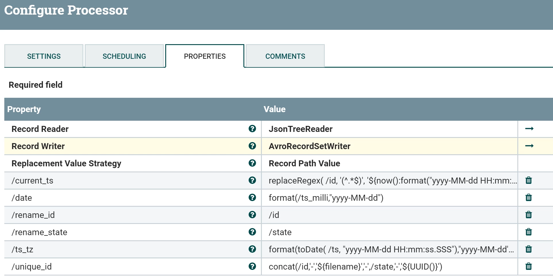

Now we are going to add user-defined properties in update record processor
1./current_ts
replaceRegex( /id, '(^.*$)', '${now():format("yyyy-MM-dd HH:mm:ss")}')
To get current_ts field value we are using replaceRegex function of RecordPathDomainSpecific language and replacing the id value with current timestamp with the specific format
2./date
format(/ts_milli,"yyyy-MM-dd")
Based on ts_milli record path value and changing the format to get only the date from epoch time in milliseconds
3./rename_id
/id
Assigning the id value to new rename_id field we are going to have same id value for both fields
4./rename_state
/state
Assigning the state value to new rename_state field we are going to have same state value for both fields because in our output avro schema includes both fields.
5./ts_tz
format(toDate( /ts, "yyyy-MM-dd HH:mm:ss.SSS"),"yyyy-MM-dd'T'HH:mm:ss'Z'")
Changing the format of the ts field value and adding T and Z and assigning the new value to ts_tz field.
6./unique_id
concat(/id,'-','${filename}','-',/state,'-','${UUID()}')
In this field value we are concatenating id,filename,state,UUID() values with - to make the value unique and assigning the value to unique_id field.
Our output flowfile will be in avro format to view the flowfile content we are using ConvertAvroToJSON processor to view each processor output.
Output:

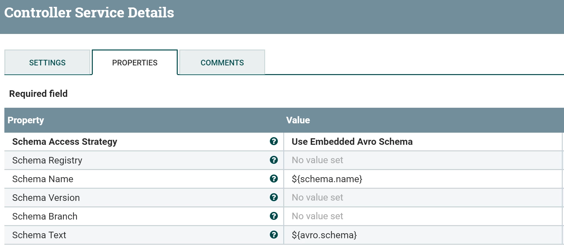

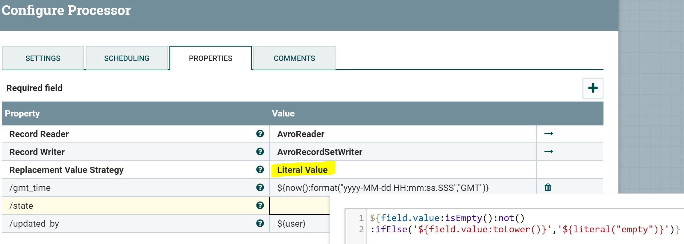

Update Record Strategy as Literal value configs:-
Record Reader as Avro reader as we are having feeding avro file with embedded schema so we are keeping Schema Access Strategy as Embedded Avro Schema

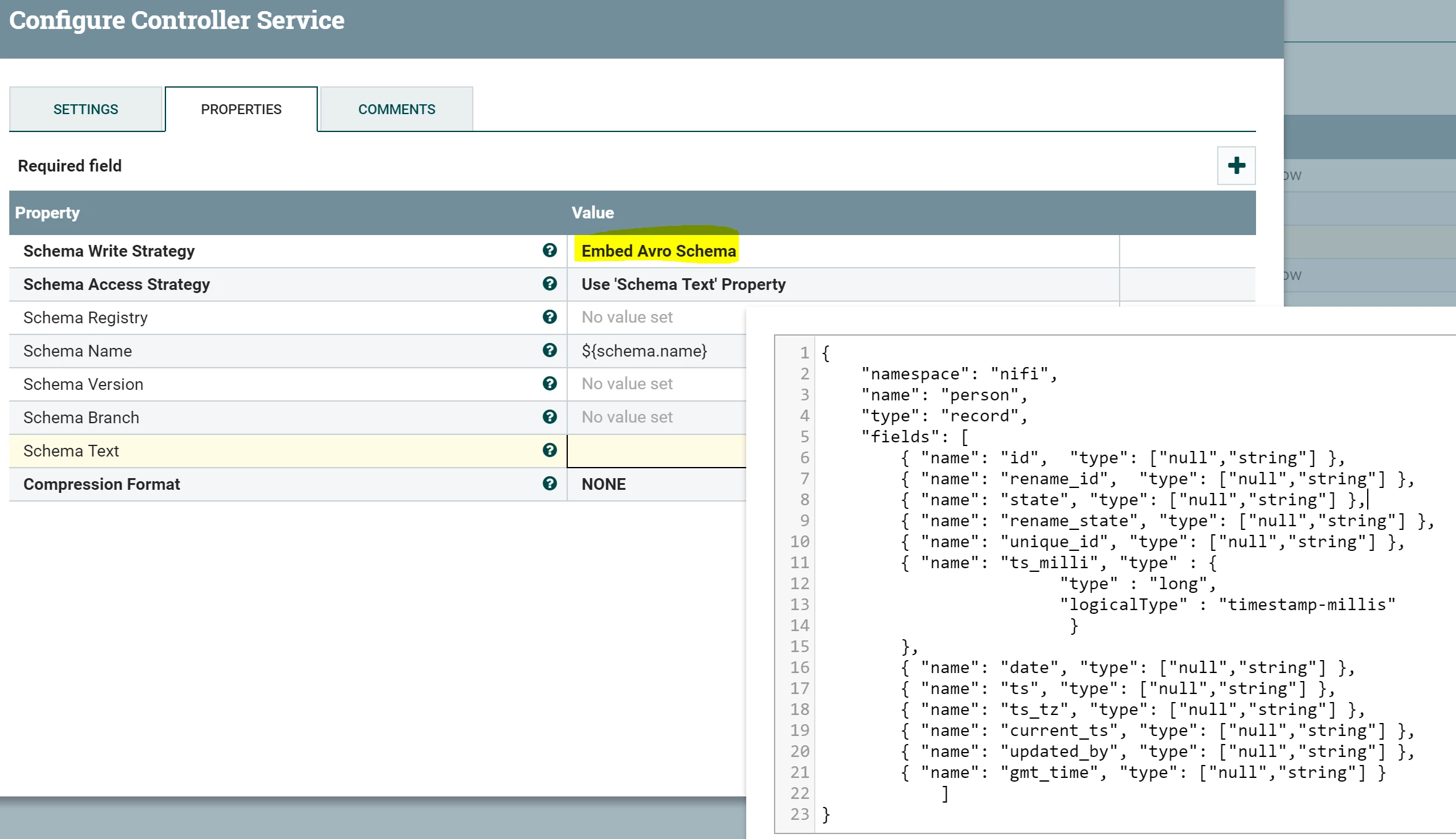

AvroSet writer configs:
Schema Text:
"name": "person",
"type": "record",
"fields": [
"type" : "long",
Add new user-defined properties as
1./gmt_time
${now():format("yyyy-MM-dd HH:mm:ss.SSS","GMT")}
We are adding gmt time by using NiFi expression language
2./state
${field.value:isEmpty():not():ifElse('${field.value:toLower()}','${literal("empty")}')}
in this value we are checking state field value and if it's not empty then changing the value to lower case,if the value is null or empty string or blank then keeping the value as literal "empty"
3./updated_by
${user}
We have added user attribute in GenerateFlowfile processor and now we assigning the user attribute value to update_by field value.
