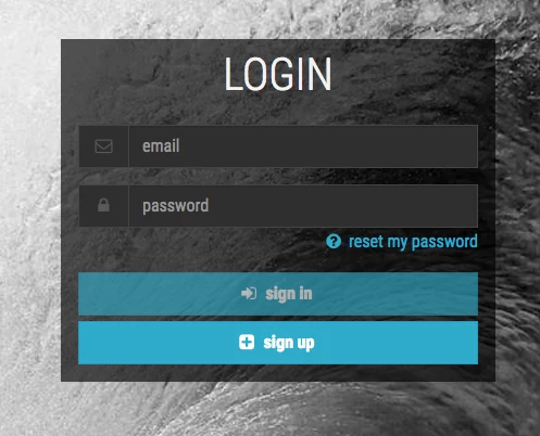

Login to Cloudbreak
Cloudbreak should now be running. We can login to the UI using the IP address specified in the Profile. In our case that is https://192.168.56.100. Notice Cloudbreak uses https.
You should see a login screen similar to this:
At this point you should be able the Cloudbreak UI screen where you can manage your credentials, blueprints, etc. This tutorial doesn't cover setting up credentials or deploying a cluster. Before you can deploy a cluster you need to setup a platform and credentials. See this link for setting up your credentials:

Uluwatu (Cloudbreak UI) url:
login email:
<myemail>
password:
creating config file for hdc cli: /root/.hdc/config
[root@cloudbreak cloudbreak-deployment]#
It takes a minute or two for the Cloudbreak application to fully start up. Now you can login to the Cloudbreak UI.
