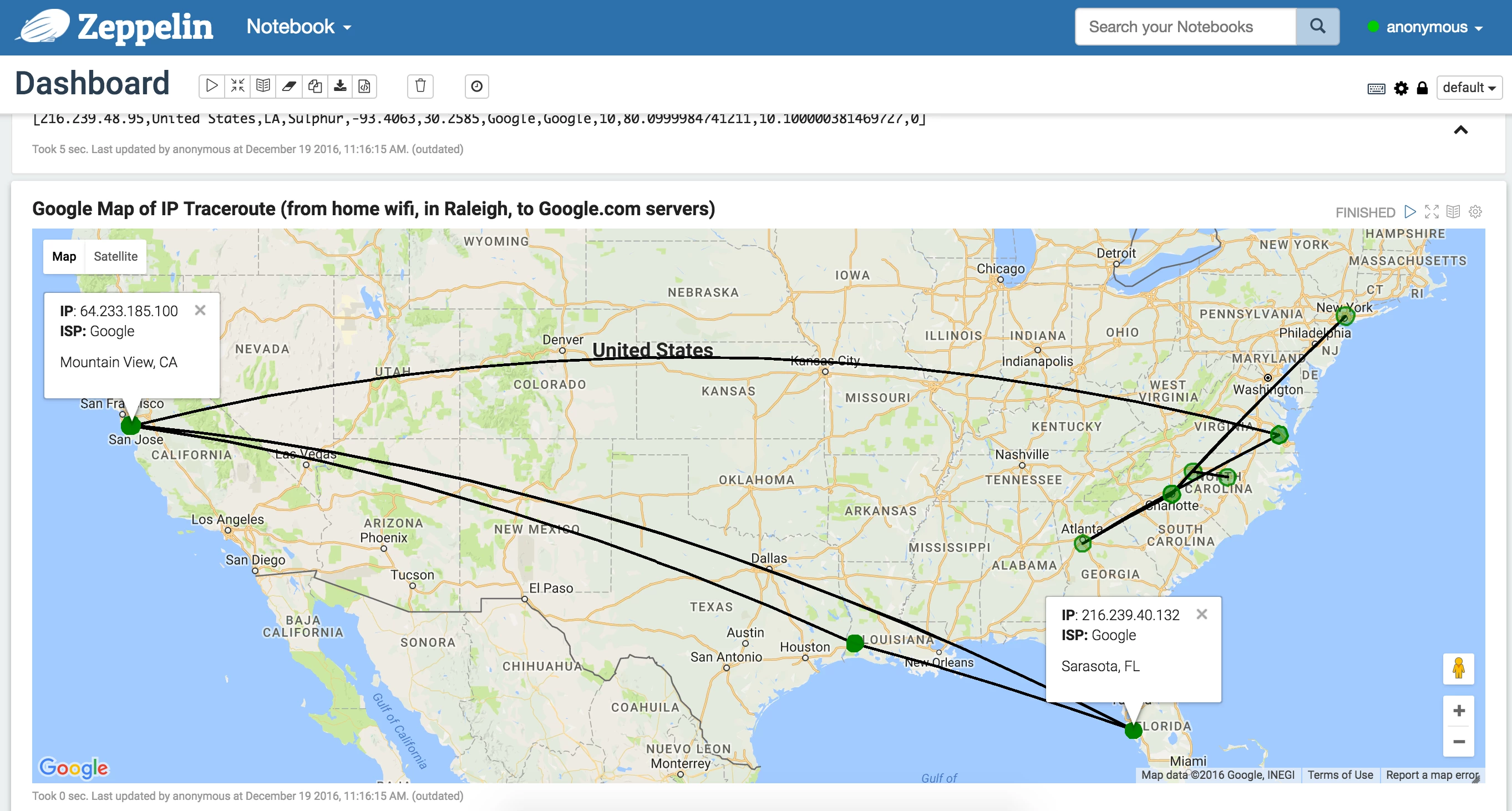

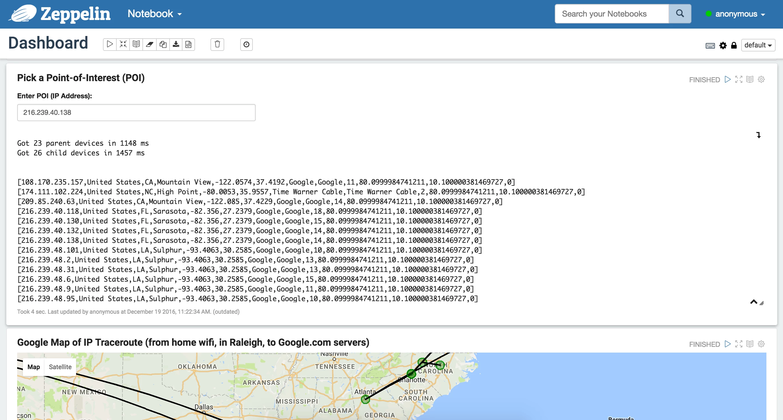

Here's a couple screenshots showing the end result of the traceroute analysis and Google Map within Zeppelin:
Figure 1: Dashboard showing and input (Point-of-Interest, POI) and the Spark output
Figure 2: Google Map created via Angular within Zeppelin Notebook
From Figure 1, you can see that a user-defined point-of-interest (POI) can be entered by the user. This is the node, or IP address, that a user is interested in analyzing. From here, the Spark code parses the data, retrieves all parent and child nodes, checkes the health status of each node, then uses that data within Angular to generate the Google Map.

Step 3: Write Angular JS code to display the Google Map
Within Angular, I used the code (below) to read each variable using window.angularVars.<variable_name>. Then, to map each node or point-of-interest, I draw a circle and colored it green (health status = ok) or red (health status = bad).
