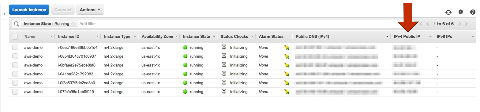

You can easily get the public IP address of your instances from the AWS console. Here is what mine looks like:
If you followed the part 1 tutorial, then the username for your instances should be centos. Edit your inventory/static. You should have something similar to the following:

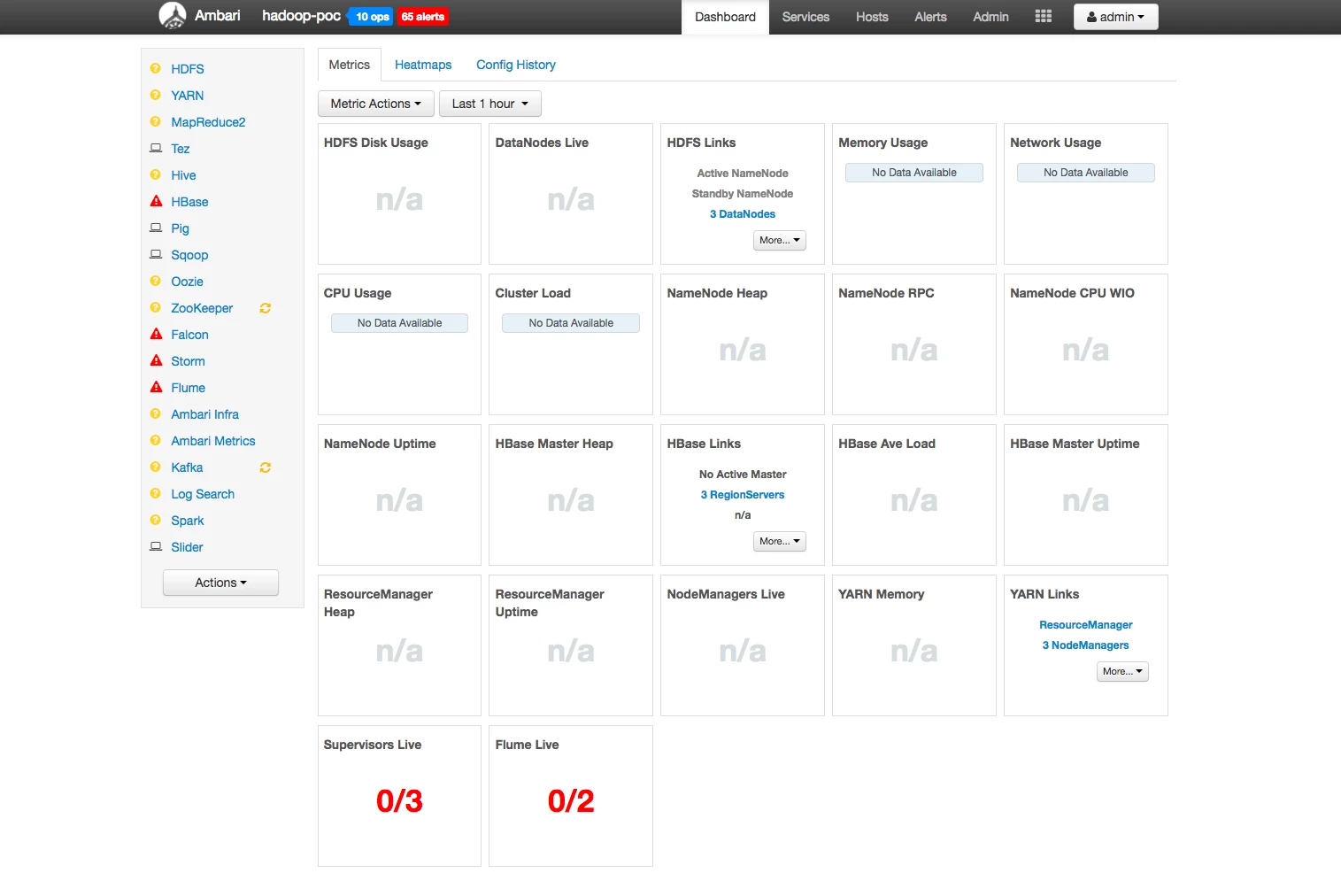

Once you see 3-5 of the retry messages, you can access the Ambari interface via your web browser. The default login is admin and the default password is admin. You should see something similar to the following:

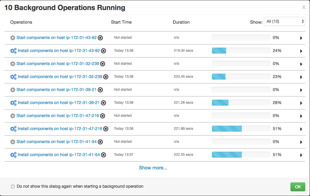

Click on the Operations icon that shows 10 operations in progress. You should see something similar to the following:
The installation task each takes between 400-600 seconds. The start task each take between 20-300 seconds. The master servers typically take longer to install and star than the slave servers.

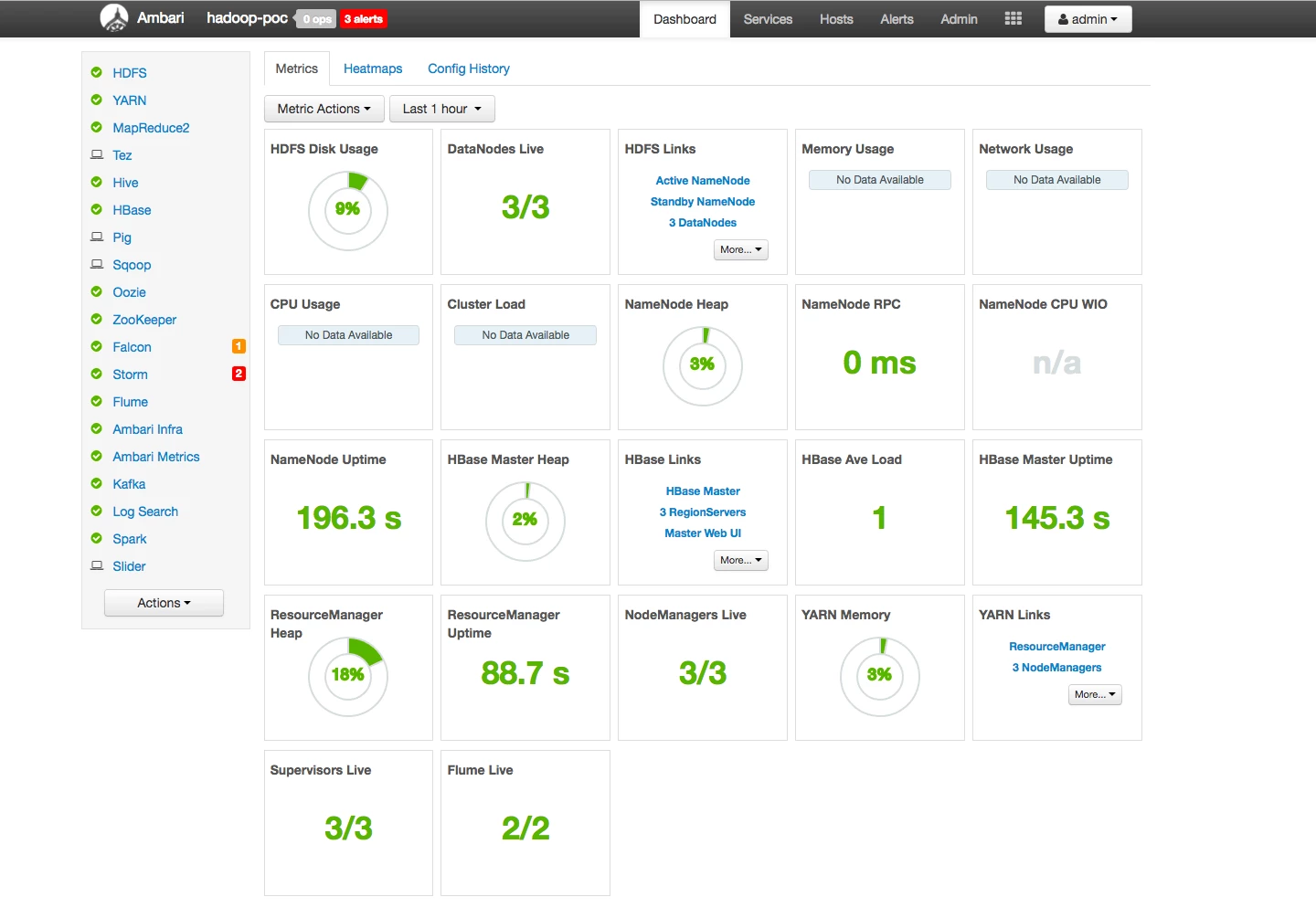

When everything is running properly, you should see something similar to this:
If you look back at your terminal window, you should see something similar to the following:
