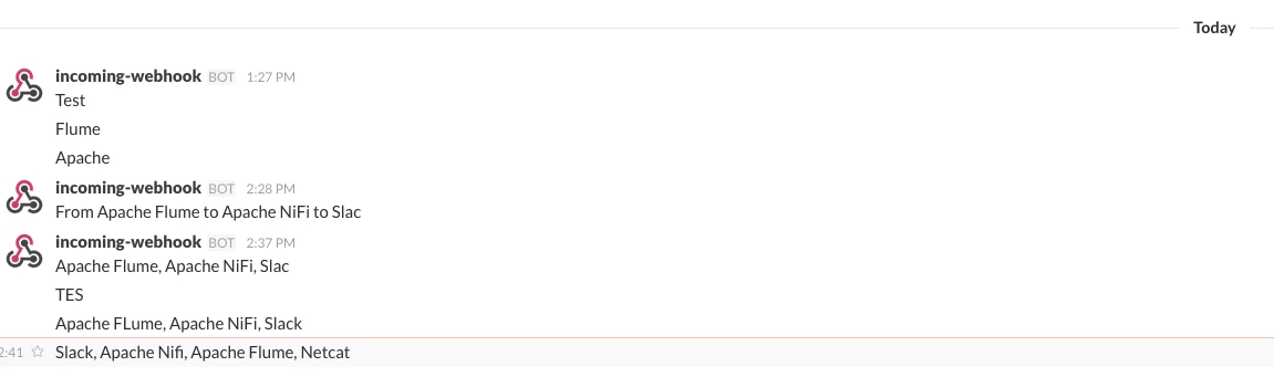

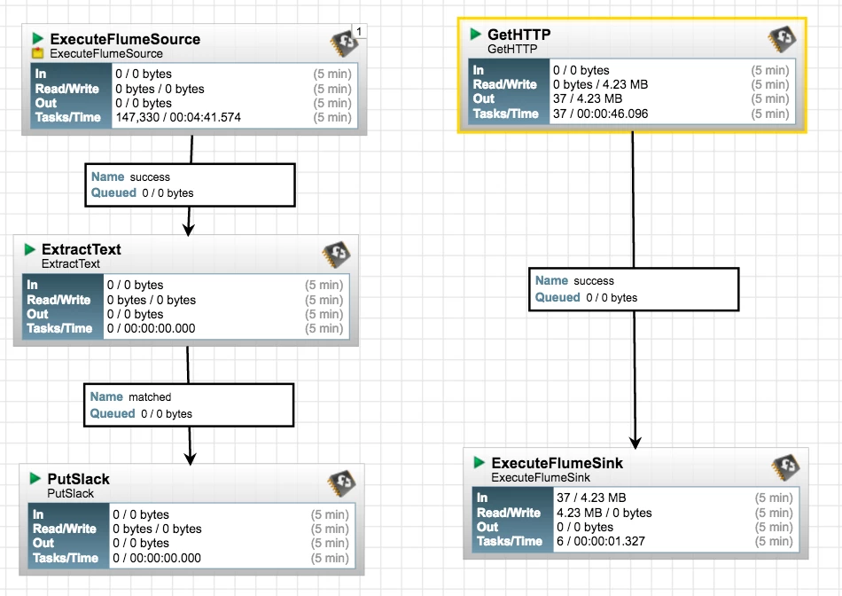

An example of using ExecuteFlumeSource and ExecuteFlumeSink in Apache NiFi. We use a Flume source to read Netcat and send to Slack. So you can send messages from Linux to a Slack chat. For the Flume sink to HDFS, we read data from a web feed. We can also connect our Flume Source to Flume Sink.

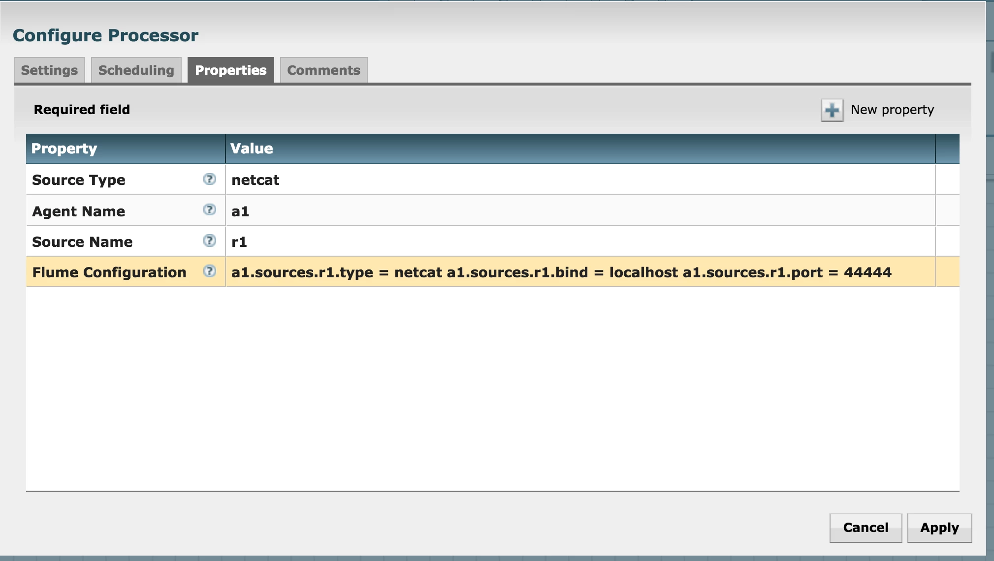

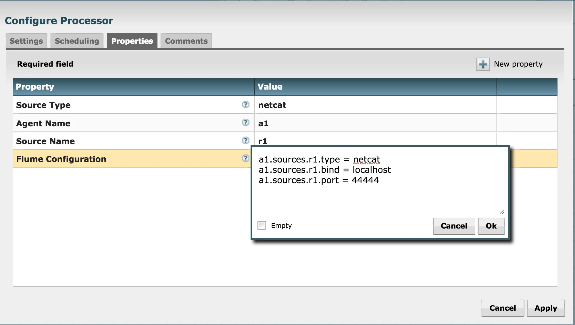

Configuring a Flume Source
If you have configured Apache Flume configuration files, this is the same thing.
Data Received in Slack (Join and See Messages Live)

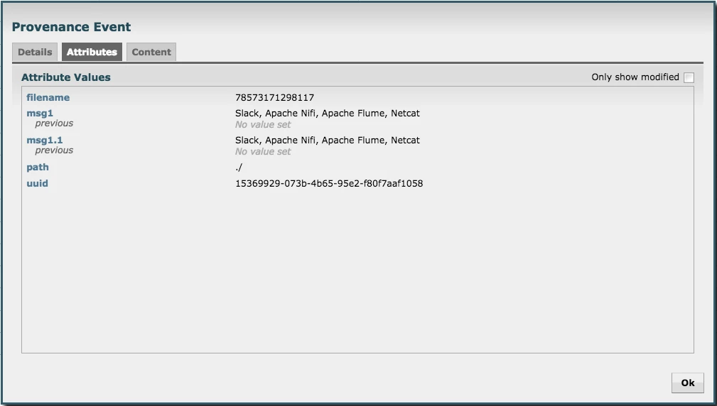

Checking Provenance Event

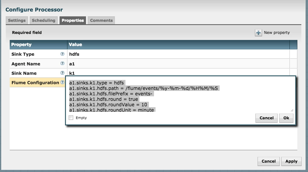

Configure The ExecuteFlumeSink to Store to HDFS
-rw-r--r-- 3 flume hdfs 28 2016-07-25 16:14 /flume/events/16-07-25/1610/00/events-.1469463242392
To monitor what's going on in the Flume side of the process: tail -f /var/log/flume/flume-a1.log

Using the Netcat
telnet localhost 44444
Trying 127.0.0.1...
Connected to localhost.
Escape character is '^]'.
Slack, Apache Nifi,
Apache Flume, Netcat
OK^]
telnet> quit
Connection closed.
