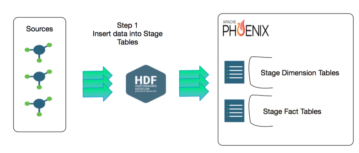

Step 1
We will first build staging tables in Phoenix (HBase). Why Phoenix? Phoenix/HBase handles upserts very well and handles known query patterns like a champ. I'm going with Phoenix. ETL will be performed on the staging tables and then finally load into our product/final output tables. The final output tables are the golden records. They will host all your post ETL'd data. Those tables will be available for end consumption for down stream BI, analytics, ETL, and etc. Using Apache NiFi, simply drag and drop your sources and your Phoenix staging tables onto the canvas and connect them. Do any simple transformation you wish here as well. Some requirements may state to land raw data and store transformed data into another table. Essentially creating a System of Record. That will work as well. We will mostly work with the post System of Record tables here.

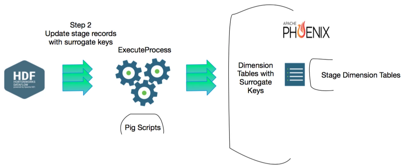

Step 2
Next we want to assign a primary keys to all records in the staging table. This primary key can either be a surrogate or natural key hash. Build a pig script to join both stage and final dimension records based on natural key. Records which have a match, use the primary key and upsert stage table for those records. For records that do not match you will need to generate a primary key. Again either generate a surrogate key or use natural key hash. Important the ExecuteProcess is a processor within Apache NiFi. I am just calling it out to be clear what needs to be done during the workflow.
The part I purposely left out is the "how" to generate a surrogate key. There are many ways to skin a cat. Disgusting. I hate that phrase but you get the idea. Here are some ways of generate a surrogate key
Another option to point out - Use a RDBMS. I know many cringe when they hear this. I don't care. It works. Do the SCD1 processing for that incremental data set on a free and open source RDBMS. Then use RDBMS table to update Phoenix stage table. Want to join both data sets? You can also use Spark to join both RDBMS tables & HBase table. The connector information is here. Then you can do step 2 processing in Spark. I plan to write another article on this in the coming days/weeks. Stay tuned. This may end up being the dominant pattern.

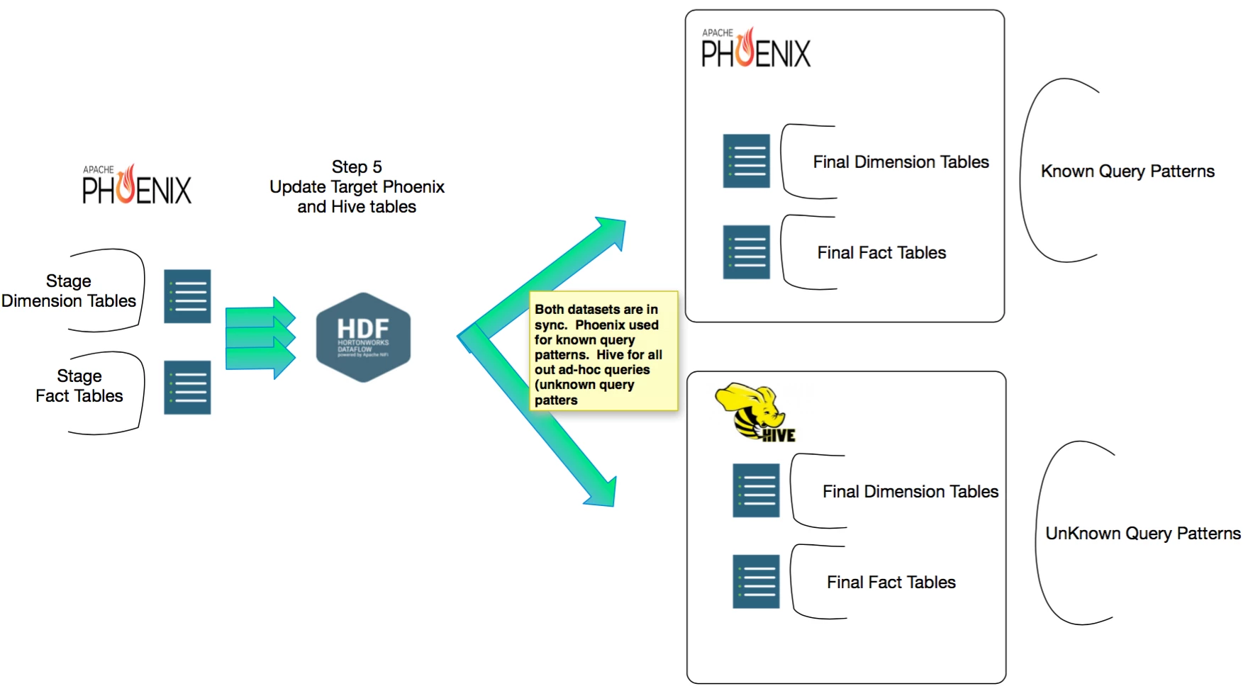

Step 5
Now we have stage table with our beautiful surrogate keys. Time to update our final tables. But notice I do not only update Phoenix tables. I have built the same tables and data set in hive. Why? For known query pattern Phoenix kicks butt. For unknown query patterns (Ad Hoc BI queries) I rather leverage Hive on Tez. Therefore using Apache NiFi pull your stage tables and upsert Phoenix and Hive final tables. Hive ACID is in technical preview. If you rather not do upsert in hive then this will involve another processing setup. This is well documented here so no reason for me to regurgitate that.
I hope this help with your SCD type 1 design on Hadoop. Leverage Apache NiFi and other animals in Hadoop. Many way to skin..ahh i'm going there. Next article I will post design pattern on Hadoop for SCD type 2.
