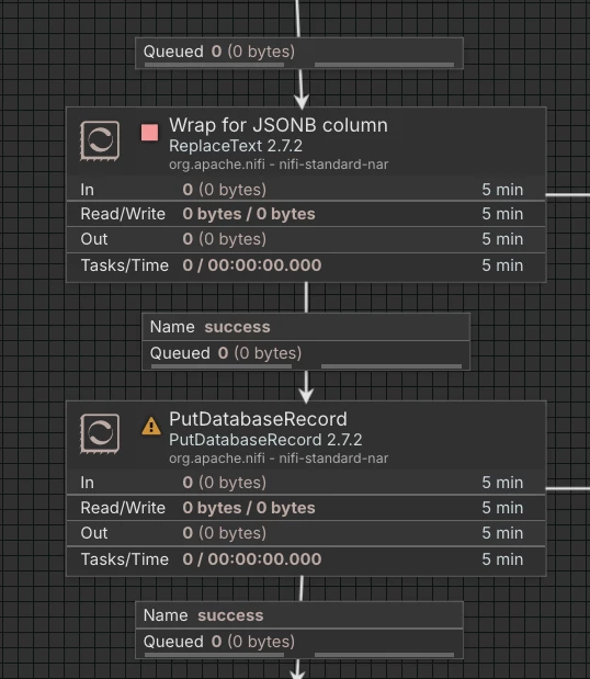

Writing to JSONB column
In my case, the PostgreSQL table had two columns:
  1. data of type JSONB
  2. id of type UUID (generated from the contents of data)
The table DDL is as such:
CREATE TABLE IF NOT EXISTS <schema>.<table> (
data JSONB NOT NULL,
id UUID GENERATED ALWAYS AS ((data->>'id')::uuid) STORED,
PRIMARY KEY (id)
To wrap my JSONs in the 'data' field and escape them, I used a single ReplaceText processor configured as such:
Replacement Strategy
Regex Replace
Search Value
(?s)(^.*$)
Replacement Value
{"data": "${'$1':escapeJson():replace('\\', '\\\\')}"}
Character Set
UTF-8
Maximum Buffer Size
1 MB
Evaluation Mode
Entire text
Line-by-Line Evaluation Mode
All
Credit to Mark Payne (@mpayne) for suggesting that replacement value in the StackOverflow thread mentioned above. The expression matches your entire file content (careful if your JSONs are bigger than the Maximum Buffer Size), making it accessible via the '$1' attribute in the Replacement Value property. This allows you to run Expression Language on your entire file's contents. We use this to run :escapeJson():replace('\\', '\\\\') on the JSON data to prepare it for insertion. There is also a simple {"data": "...."} literal text wrapper so that the following PutDatabaseRecord processor will know to write this escaped json to the 'data' column.
No special configuration is needed in the PutDatabaseRecord processor. This is the overall flow:
Note that although it appears you insert escaped JSONs to your DB, they are actually stored correctly and can be queried using standard JSONB operators (->, ->>, etc.)

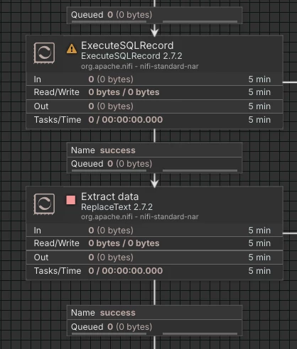

Reading the Data back
To read the data back, I use ExecuteSQLRecord to fetch rows (making sure to specify Array Output in the JSON RecordWriter), followed by another ReplaceText processor to edit the results back to their correct shape.
I define a basic SQL query to fetch just the data column:
SELECT data FROM <schema>.<table>
The resulting FlowFile content might look something like:
"data": "{\"id\": \"488b5b63-6ccf-4816-9a38-38c3befd248f\", \"myKey\": \"myValue\", \"keyTwo\": \"bababa\"}"
"data": "{\"id\": \"2fec9cad-5246-4d92-aa41-9a57cfc4e8ab\", \"myKey\": \"myValue23\", \"keyTwo\": \"21312\"}"
"data": "{\"id\": \"6efbac98-3a10-422d-a2a2-ac6d79ffef6b\", \"myKey\": \"myValue23\", \"keyTwo\": {\"nested\": [\"abc\", \"def\"]}}"
 As you can see, each row gets read as a flat JSON where the key is 'data' like the column name, and the value is a stringified/escaped version of the original content.
To fix it now, I use this config in the following replace text:
Regex Replace
Search Value
"data"\s*:\s*"\{((?:\\.|[^"\\])*)\}"
Replacement Value
${'$1':unescapeJson()}
Character Set
UTF-8
Maximum Buffer Size
1 MB
Evaluation Mode
Line-By-Line
All
Note that I use Line-By-Line mode this time, since ExecuteSQLRecord seems to fetch rows prettified with newlines separating them (Even if Pretty Print is set to false in the RecordWriter!). Because it scans line-by-line, it ignores the braces/brackets at the top and bottom of the response and in-between the different rows, and you can instead focus on just the content of the rows, which looks like:
"data" : "{\"id\": \"488b5b63-6ccf-4816-9a38-38c3befd248f\", \"myKey\": \"myValue\", \"keyTwo\": \"bababa\"}"
Thus, we match everything within the value of data's braces "data" : "{ <this part> }" and once again use ReplaceText's special expression syntax '$1' to refer to our escaped version of the original JSON content and then run :unescapeJson() on it to restore it back to its valid form.
The output will look like
"id" : "488b5b63-6ccf-4816-9a38-38c3befd248f",
"myKey" : "myValue",
"keyTwo" : "bababa"
"id" : "2fec9cad-5246-4d92-aa41-9a57cfc4e8ab",
"myKey" : "myValue23",
"keyTwo" : "21312"
"id" : "6efbac98-3a10-422d-a2a2-ac6d79ffef6b",
"keyTwo" : {
"nested" : [ "abc", "def" ]
And now you have valid JSONs to work with again for the rest of your flows.
