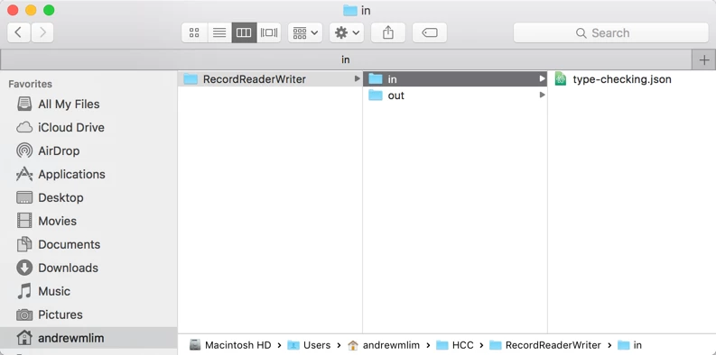

Place the type-checking.json file in your input directory:

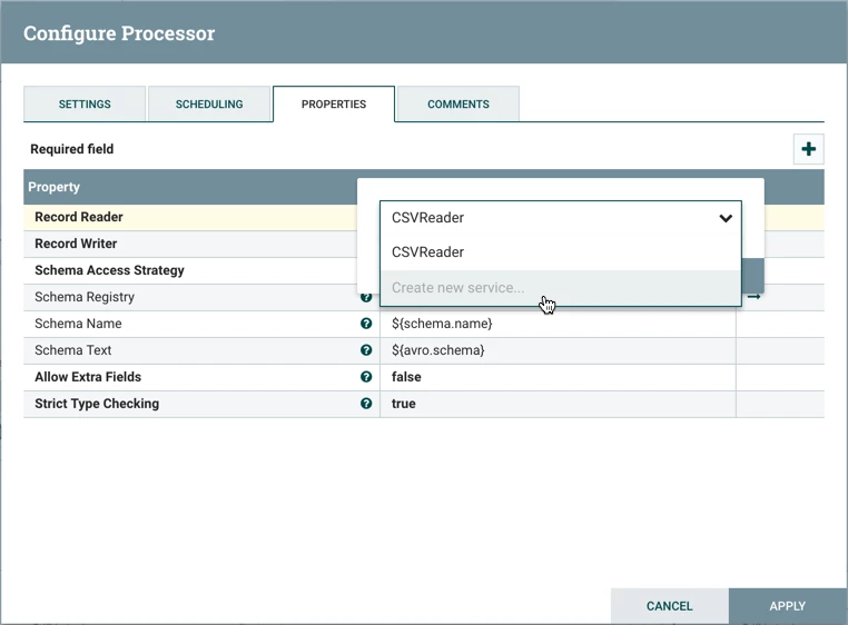

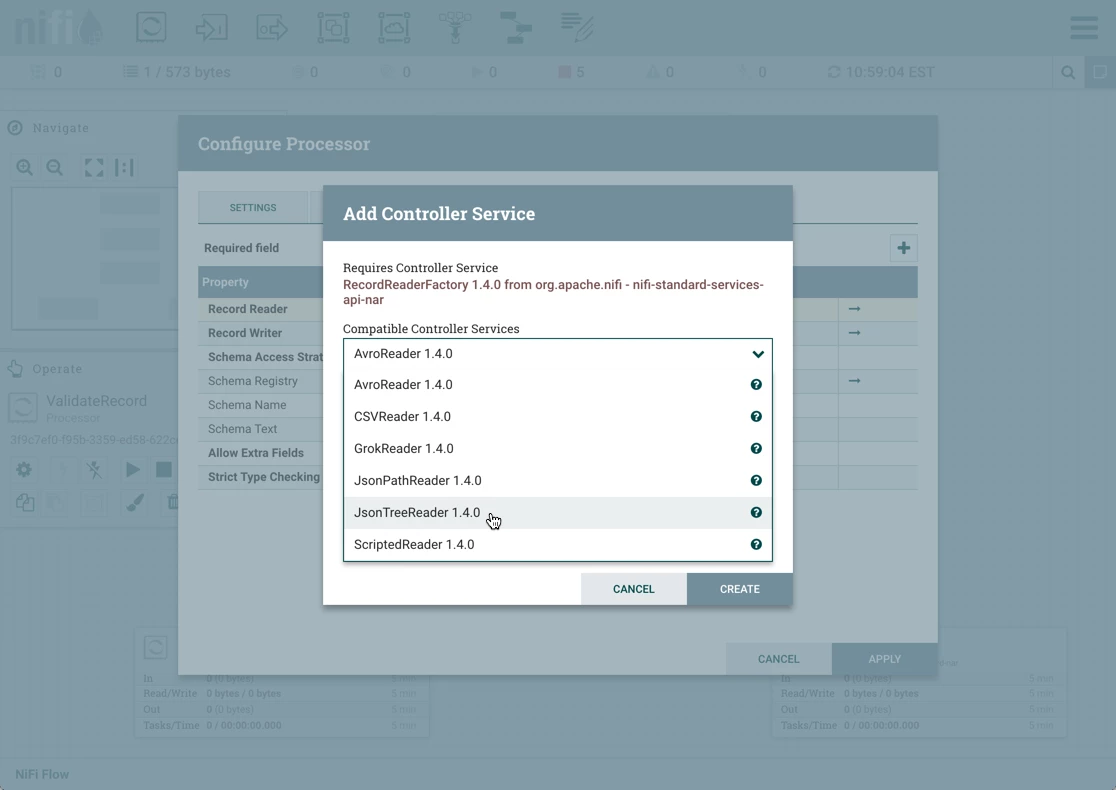

In order to process the JSON file, the ValidateRecord processor needs to use a JSON Record Reader. Go to the configuration window for the processor and select "Create new service..." for the Record Reader:
Select JSONTreeReader, then "Create":

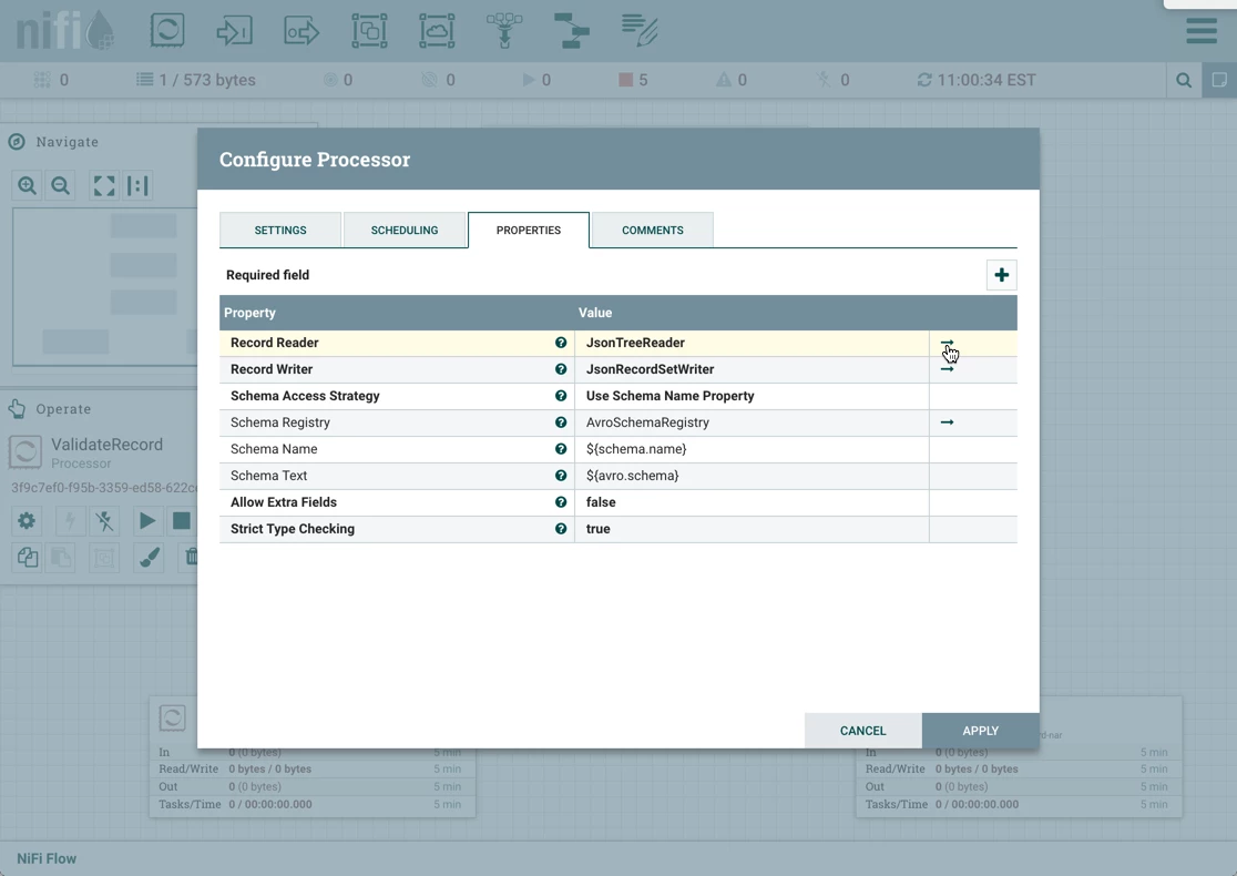

and then select the Arrow icon next to the reader:
Save the changes made before going to the Controller Service.

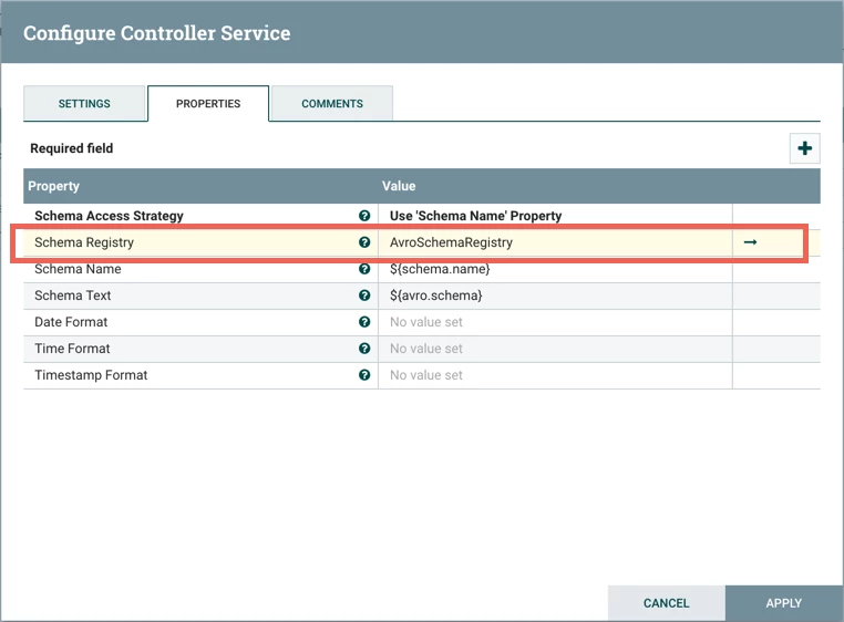

Go to the configuration window of the JsonTreeReader controller service, select "AvroSchemaRegistry" for the Schema Registy and then select Apply:
Enable the JsonTreeReader service. The flow is ready to run.

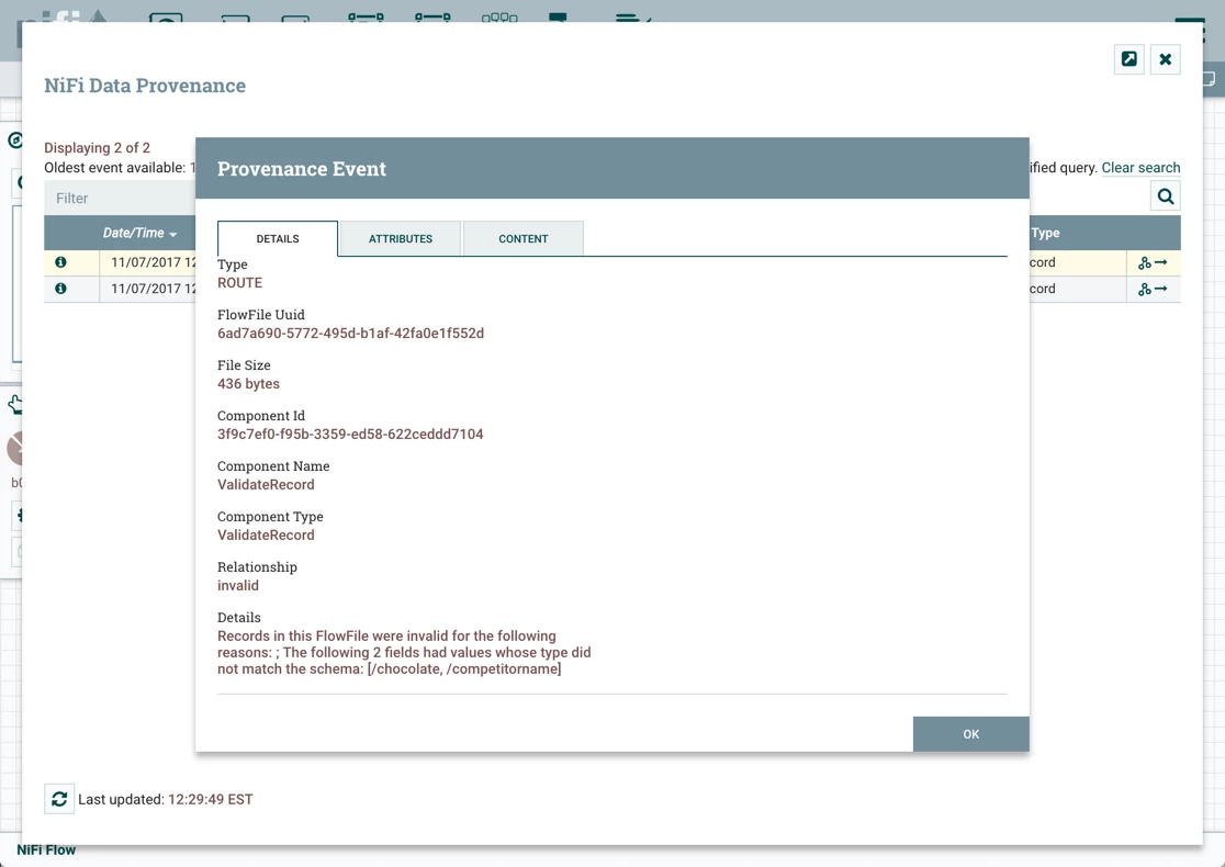

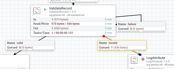

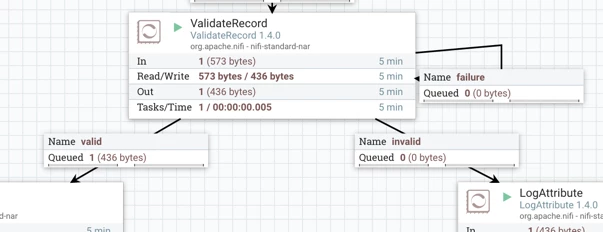

Start the GetFile, UpdateAtttribute and ValidateRecord processors. With "Strict Type Checking" set to "true", the 2 records are considered invalid and are routed to that connection:
Start the LogAttribute processor to clear the queue. Stop all processors. Place the type-checking.json file in your input directory again.

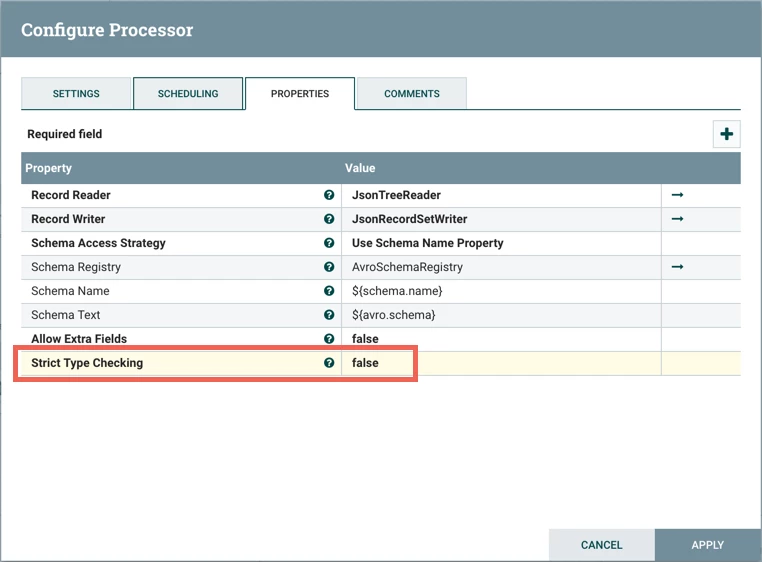

Now let's change the Strict Type Checking property to "false":
Running the flow this time, the 2 records are considered valid and are routed to that connection:
